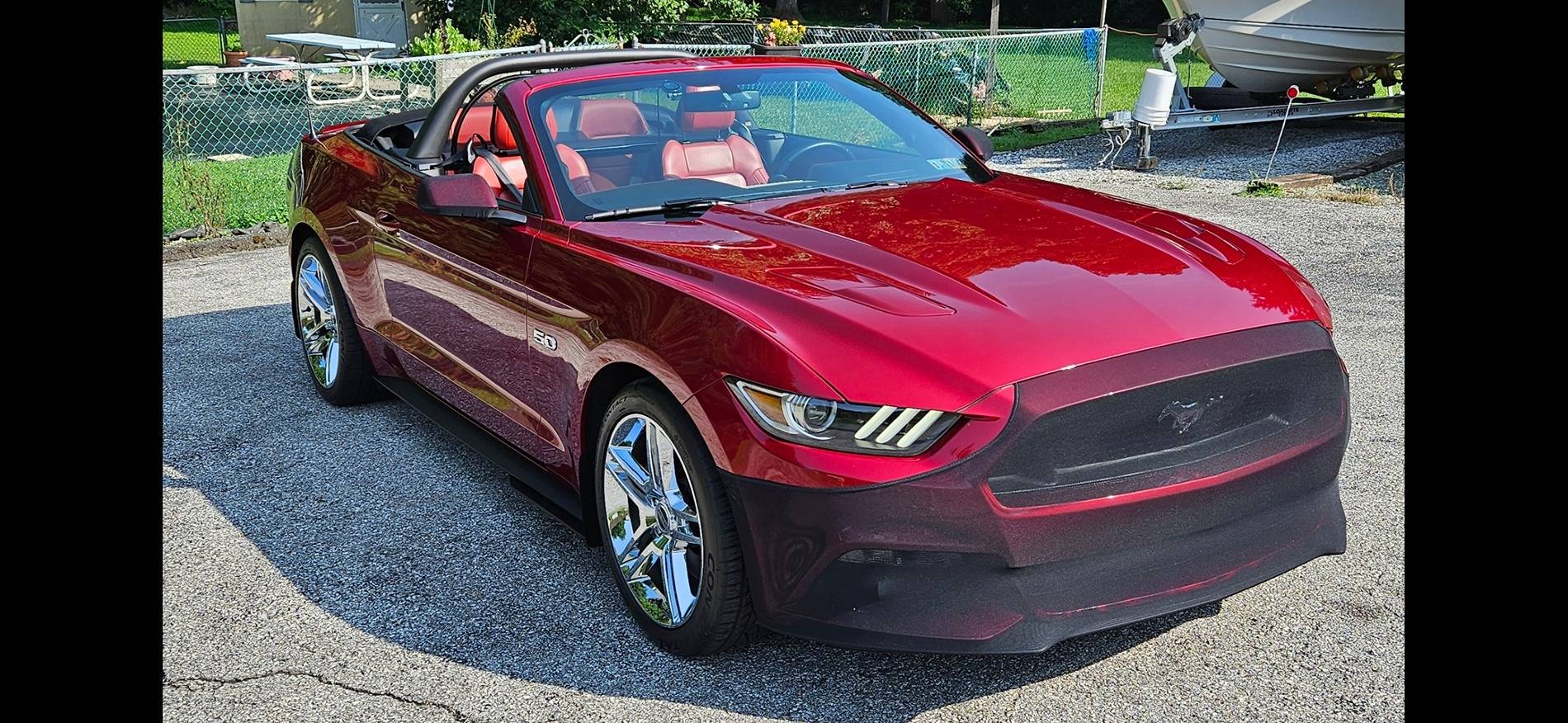

Taking a break from meme's to just ask how these mods sound for a weekend cruiser/alt daily:
https://www.americanmuscle.com/dss-aluminum-driveshaft-manual-2015gt.html/https://www.americanmuscle.com/bmr-front-safetyloop-red-1114.html
https://www.steeda.com/steeda-555-5536-mustang-extreme-g-trac-k-member-brace
https://www.steeda.com/steeda-s550-...ce-short-throw-shifter-15-16-gt-555-7317.html
https://www.steeda.com/steeda-mustang-stainless-braided-brake-lines-2015-gt-555-6027.html
https://www.steeda.com/steeda-mustang-clutch-spring-assist-spring-perch-kit-555-7027.html
https://www.steeda.com/steeda-s550-heavy-duty-braided-clutch-line-2015-555-7016.html
https://www.steeda.com/steeda-555-5061-s550-road-race-k-member
Not my first rodeo w/this chassis
(Towards the bottom), just would be a manual GT, bodystyle still tbd. Of course I'd also throw in the inserts and bushings, just thinking other than a drop in filter, I'd focus on the drivetrain, brakes and chassis first. There's more I'm looking at, but also at work, so this took longer to type up than expected.
Again, Alt daily/Weekend car, leaning towards vert but see what happens. Just figure weight savings would help make things feel a little lighter and more free. I'll figure everything else out in due time.
Thanks for taking a look, and have a great day now

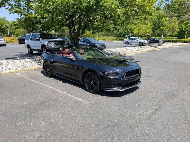

Sport bar and wind deflector
Love the color and the car, she's a beauty, but not into a sports bra and handle bar personally.
