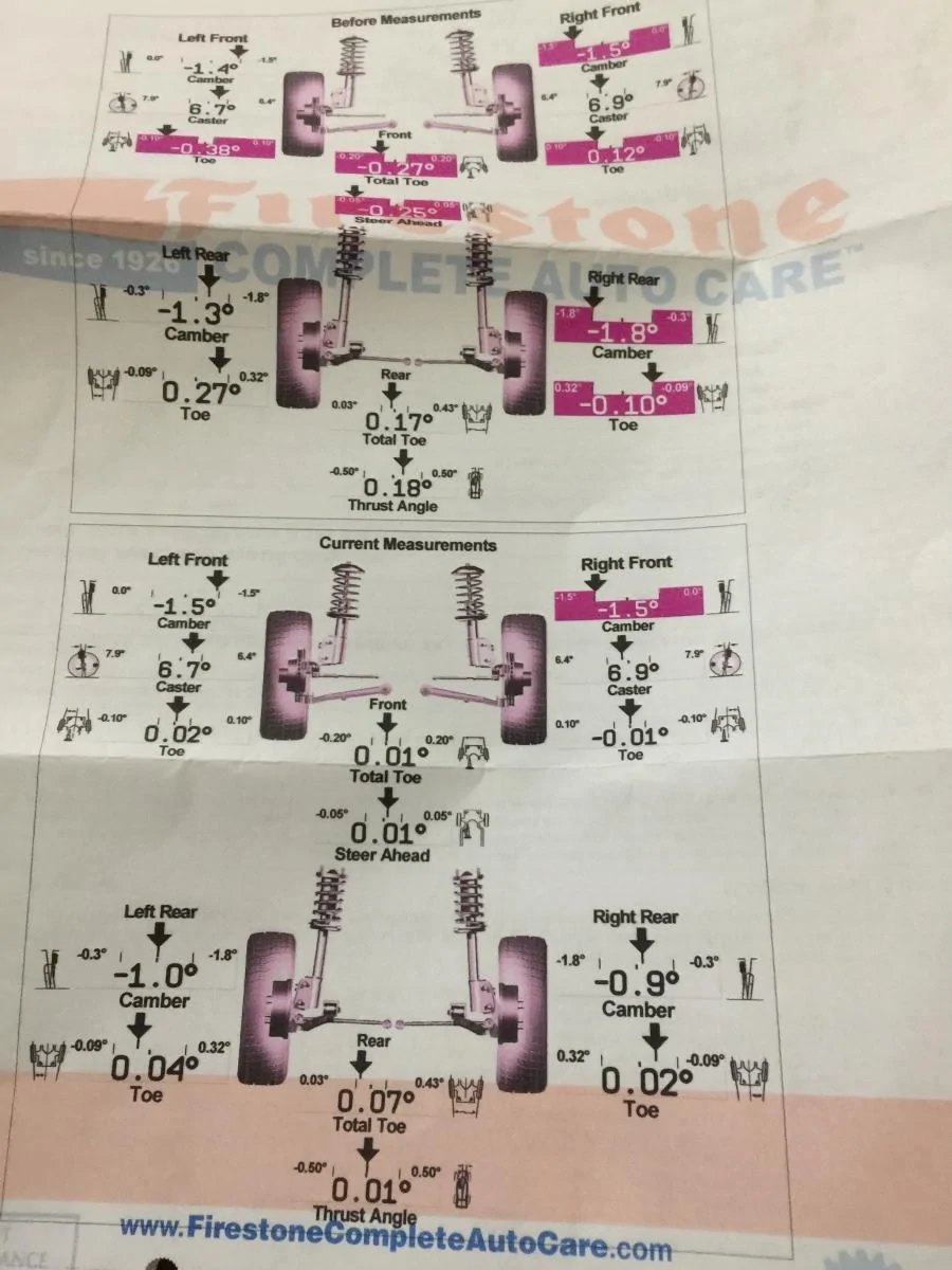

Any thoughts or advise? Mainly a street toy and I like to play on the back road twisties a bit

Camber and front toe looks good for a street car. Im not sure if thats enough rear toe in (not used to seeing it measured in degrees).

thank you for the input. One nice thing is for $189 you can get a lifetime alignment from Firestone or American Tire and take it back for adjustments every day if you want too.

Looks fine to me for a street alignment, probably wouldn't be awful at a drag strip, either. Wouldn't be my choice for a road course, but... you're not doing that.

The only thing I'd change is add more rear toe. 0.10 to 0.15 per side (so 0.20 to 0.30 total), and make sure they get the thrust angle to 0 (so both sides are even). Rear toe has a significant impact on stability under power. For the street everything else looks great.
