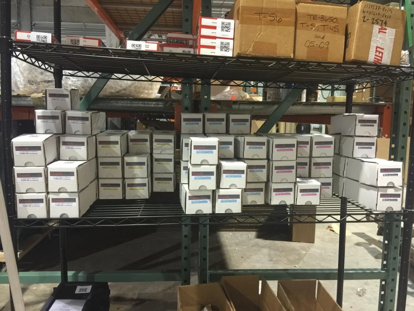

Here's the Reische stuff we have in stock now and there's a huge stocking order on the way.
We go through these things like crazy.
Give us a shout if you guys need any help placing your orders. We're here to assist you.
