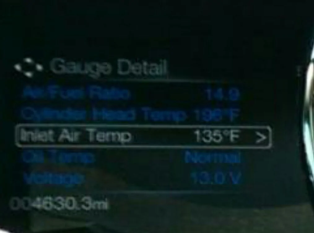

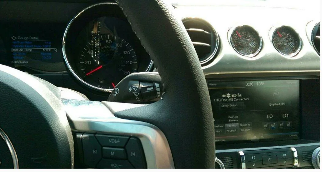

Posted these awhile back. 105 degrees,sitting in traffic head temp 196. Using 160 t stat
My head temps never get that high. I posted pics. 185 and even after beating on it.
thats 105 degrees vs i think 30's...
I'm sure you haven't, but I don't believe it gets as hot in Tampa, than it does in south Texas. I wasn't beating on the car in this picture, but just showing a example of some pretty hot conditions. 105 degrees w/ out our nasty humidity, sitting in traffic. I've seen as high as mid 120's in the peak of the summer before my 160 t stat. I'll take a 20 degree difference any day.
Where is your degree difference. Look at my photos of my head temp.
