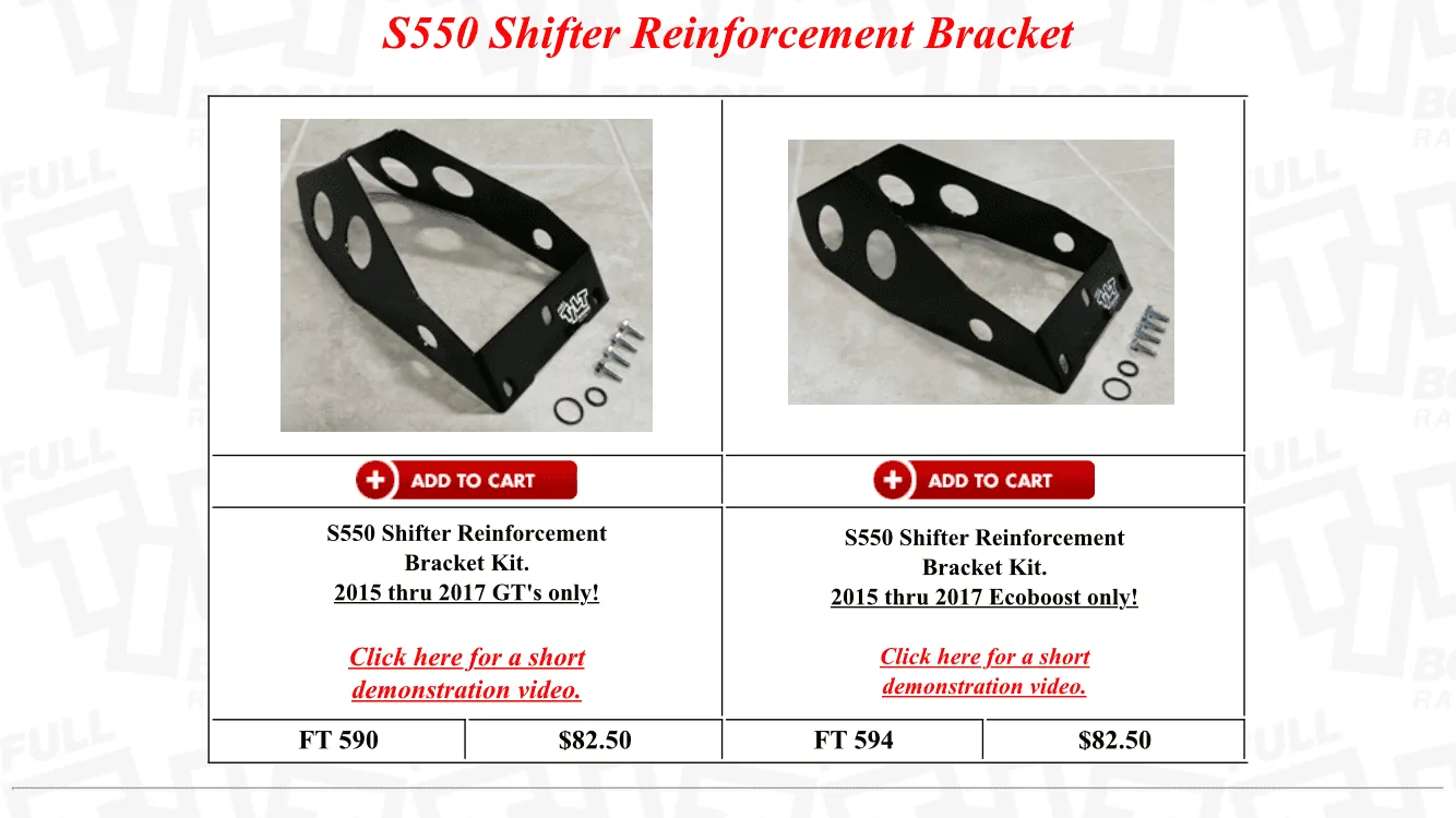

I had hi rpm 3rd gear lock out so I added the Blowfish shifter support bracket. World of difference! Also added a weighted shift knob. Feels like a completely different transmission now. It's a shame you have to spend money for the transmission to get it to feel normal.
