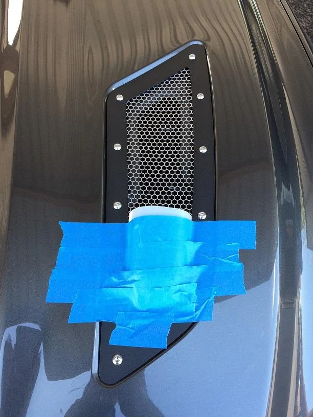

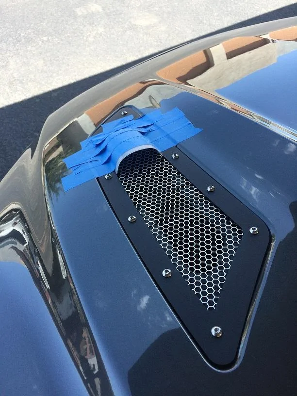

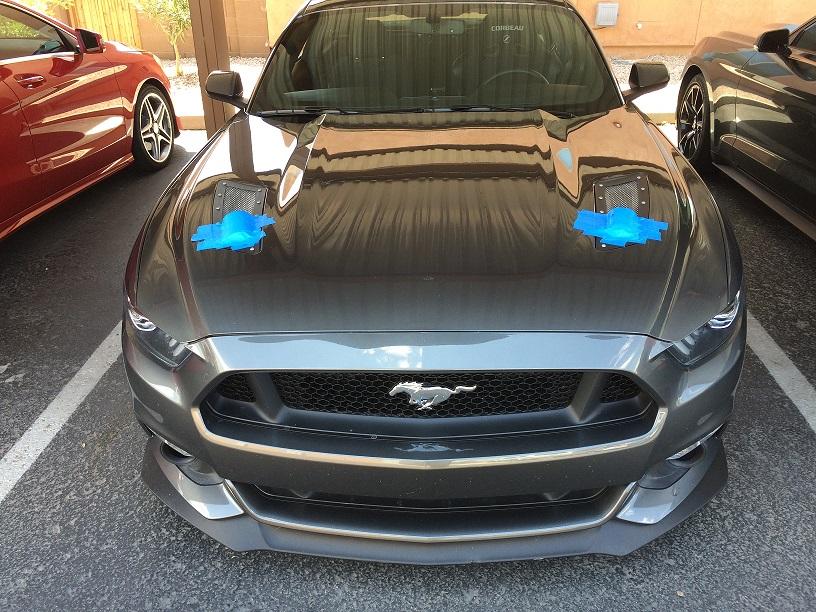

Ok so finally played around with the hood vents. ( I can only imagine what people were thinking as I drove around with blue tape, ribbon and a gopro on the car...LOL) If anyone knows any more about aero please jump in, I'm just playing around.
My first test I covered the holes with tape and then got on the highway (open air) and set the cruise at 75 for 3 miles(next exit) turned around and drive back home 3.25 miles. Luckily the highway is so close. It was 110 degrees during all test, I did have the air on for all test.
High Low Avg
Covered 216 210 214
Open 212 206 210
Scoop 210 205 208
So they are working to relieve heat I assume.
Next I used ribbon both on top and below of the vent to test flow. As you can see from the Video it appears the air is escaping. You can also see the below ribbon trying to make its way out. Also the ribbon isn't laying flat its going up so the below pressure is able to escape.
Video..
In conclusion I think ( im no aero engineer) that the vents are working and do have some function when it comes to keeping the hood lift down and the car cooler.

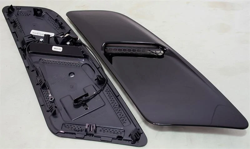

FWIW, I did the math on the Roush vents. Their 4 openings total only 37% of the stock vent single opening. And they have the drip tray below. And they require cutting that, and maybe your hood.
They do look cool from the top, but the plastic has so much orange peel, that painters don't want to color-match paint them.
Sorry, I normally don't like to detract from vendors' products, but I just want to point out to not let the 4 slots fool you into thinking they extract more air than the stock vents.
... but I just want to point out to not let the 4 slots fool you into thinking they extract more air than the stock vents.
Really?? Hmmmm....assume that you have taken measurements of actual units of each?
Definitely not trying to call BS, but very interested in this topic because I've already ordered the Roush Extractors. And yes, definitely planning to cut the drip tray and hood area underneath, like [MENTION=14941]apex15stangPP[/MENTION].
I have obviously seen the stock ones, but never the Roush ones in person. Check out the two pics for comparison below, it's hard to see how the Roush doesn't have greater total outlet size. :confused:
Yes, I did measure and I did the calculation. I was initially surprised at the result. Check it yourself.
I ordered the Roush vents, got painting estimates, had my OEM vents out, and had a buyer for my blinkers.
In the end, I sold the Roush vents, and I like my 2016 blinker-less vents with Xpel. Just my experience.
