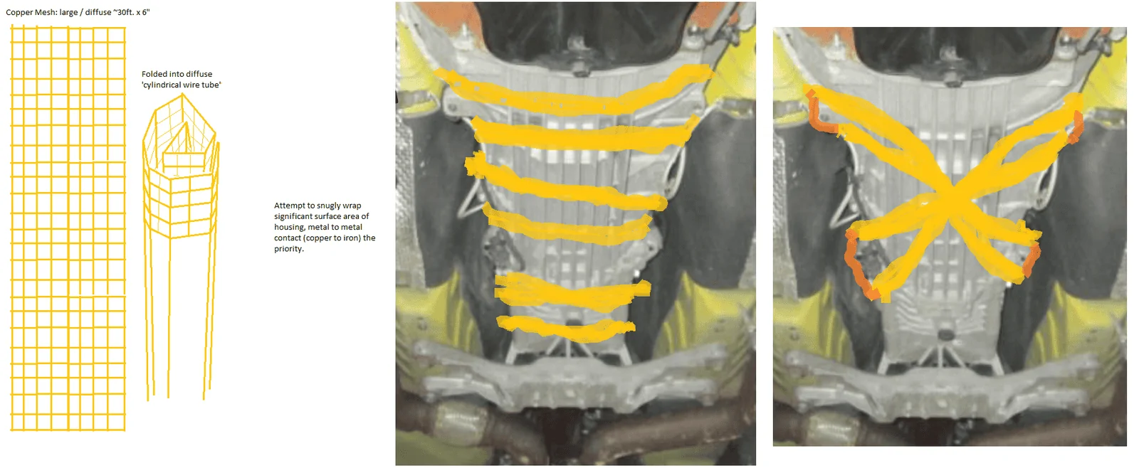

Im a noob, but I'm not terribly impressed... (EDIT: re: the scoop)
I'll send pix of my theoretical solution should it materialize..
EDIT: Mock-up for soliciting comments
