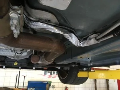

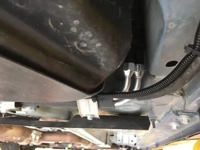

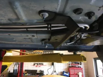

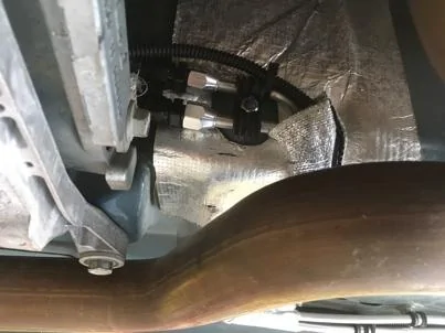

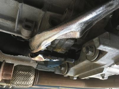

Dave do you have pics of how you routed the lines up to the trans? I've spent some time under mine today and not really crazy about the options I'm seeing.
So far if i keep with the plan of cooling the trans in a cooler similar to what you used my plan would be to run hard line along the tunnel and convert backto soft line near the subframe to go around the diff and up to the pump and cooler. My issue with this is that i don't want to defeat the cooler with exhaust heat
I ran -6 hose up and over the fuel tank and transition to hard line -6 tube by the front passenger corner of the fuel tank, run the hard lines down the passenger side and then to the trans tunnel, I then change back to a hose an connect to the trans. They is no real clean path to get there and you have to be careful to heat shield everything to make sure you do not end up heating the tube with the exhaust.
I have attached some pics, not the best but it will give you an idea for what I did.
