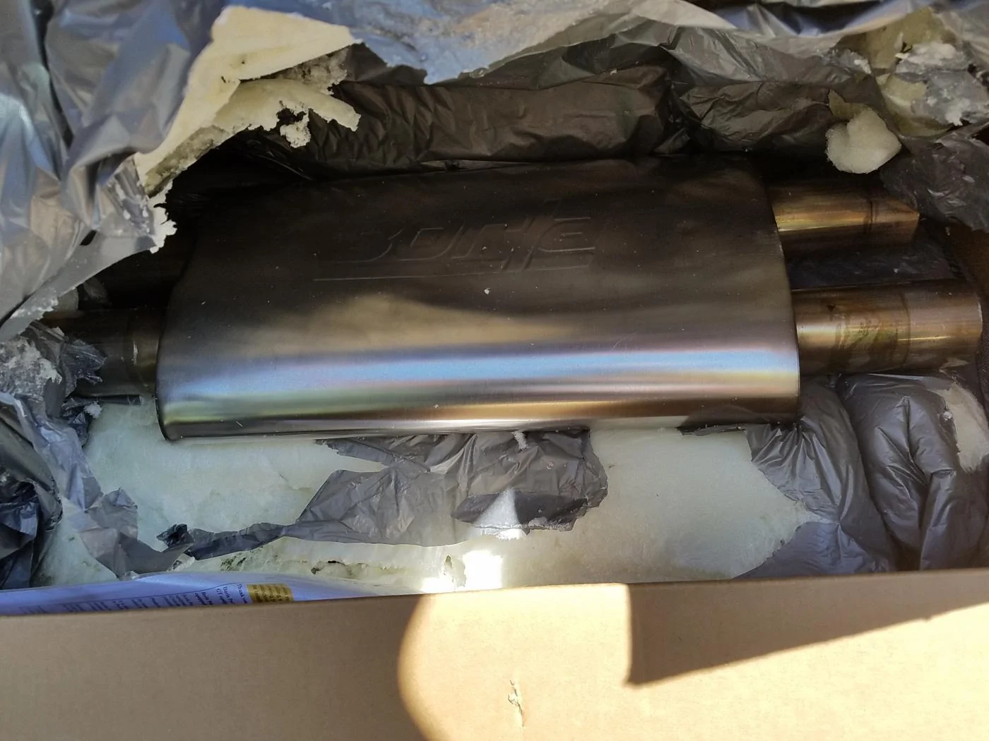

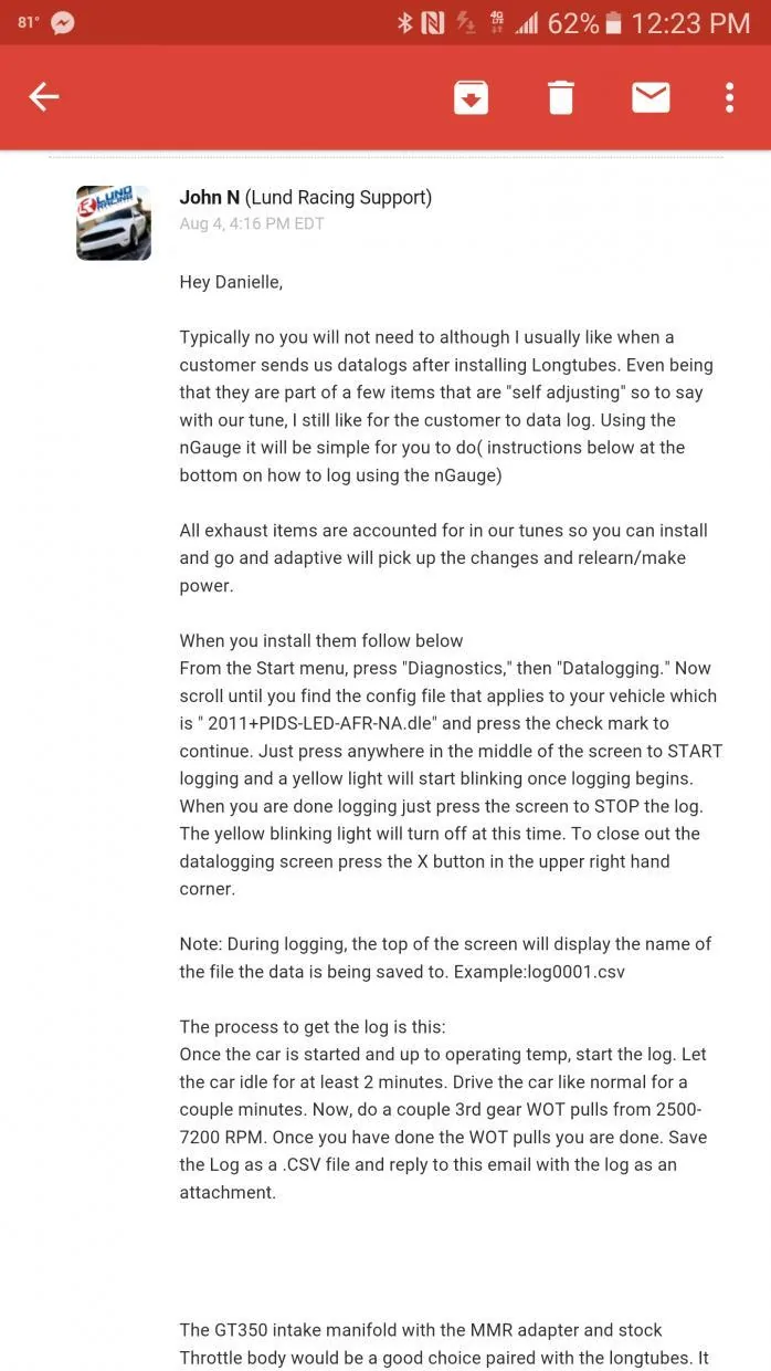

It needs the O2 transport time table updated for the wideband O2 sensors being moved downstream.
Yeah, based on what my email from Lund and what they said, I will definitely take the time to do some data logging, hopefully after I wrestle in this new borla touring mid muffler today.
Low end is clearly stronger now, it actually lights up the tires from a roll. It didn't previously

I would think the headers would cause it to run leaner. I guess if your tune was already on the rich side it would be fine.
The good thing about having wide band o2 sensors is they can adjust things on the fly pretty well. Within a certain range. I would still datalog to see if ant tweaks need to be made.
