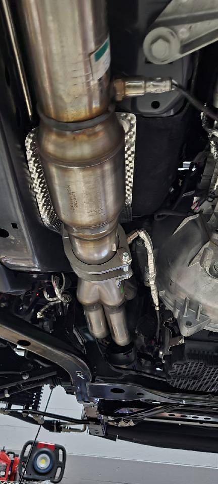

just got my TSP longtubes with cats in. I only see 1 oxygen bunge on the header. Do I need to have rear 1's welded in? I am in Florida so no emissions test. I had TSP headers on my 2016 gt with no cats but I don't remember if it had the bunges in mid pipe or not.

Not sure if this helps but I have Kooks with green cats and the second is after the cat

The rear o2 bungs will be welded into the after cat mid pipe before the cat back. Get some defoulers high flows will still sometimes still throw codes

Installer said no prob on welding bungs in. Got 42002 defoulers from autozone for $9.00. Woohoo. Install is Jan 30th.
