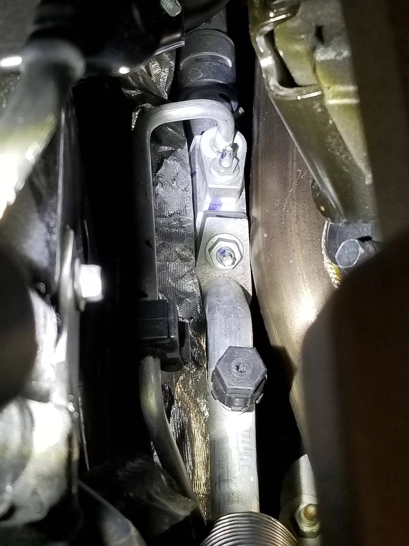

    I've researched the headers before buying them and knew that this could have been a potential issue, but what is everyone doing to remedy the contact between the header and the AC unit? I will attach a photo that was taken on the passenger side of the engine bay.

    Vendors keep peddling this stuff apparently without a care when it could be fixed so easily.
    I haven't used them myself but it looks like some gentle hammer sculpting is your only option unless you can spot heat the tube enough to put a small depression in it. I'd have to put header wrap on there or heat shield on the ac line too, not sure how well those soft aluminum lines will hold up to being that close to the header over time.

    Jack the engine up and move it over. If you need more room, lightly pry them apart.

    Imho mine fit great, if not a quick pry will fix the issue.

    That ac line will move easily

    Thanks for the replies! In which direction should it be moved?

    Up and to the left

    My remedy was moving the AC line further towards the passenger side. It only moved fractions of an inch, but so far I have not heard any further contact.

    I'd put some insulation between them if possible. One, it'll protect the AC line. Two, metal on metal contact can cause the knock sensors to report false positives.

    I think that is what I will have to ultimately do. My previous solution definitely helped, but the contact on uneven roadways is still there. Any product recommendations as far as an insulator goes? I was really hoping not to heat wrap the entire system if I don't need to. Thanks!

    Honestly I'm not sure of which one to recommend. Most of them would end up getting torn from contact between the AC line and the headers.
