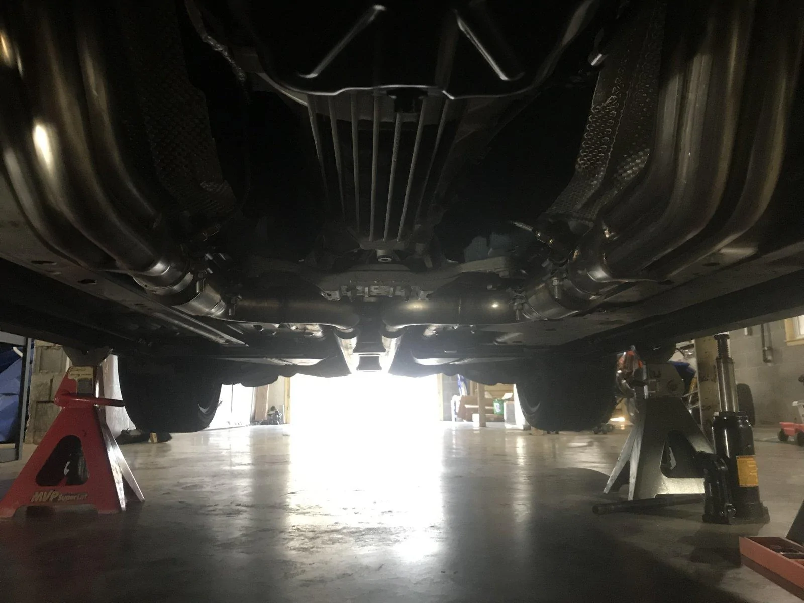

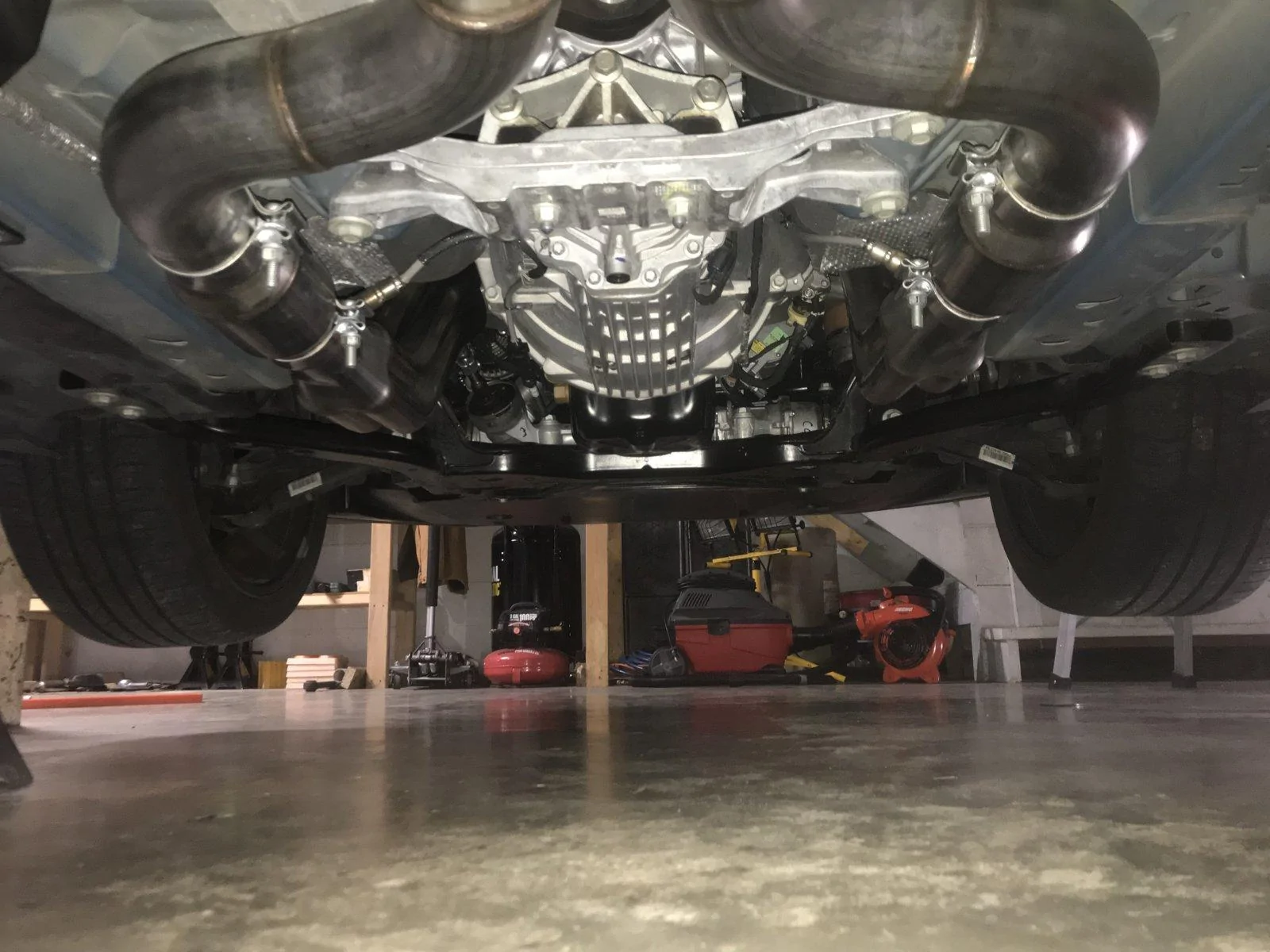

Ok, finished up the install today. The passenger side is TIGHT. No getting around that. I removed the AC line stud and flipped the bracket upside down. No clearance issues there. My only complaint with the entire setup is the driver side header hangs down about 1/2” further than the passenger side. No real issues here...it just looks a little uneven when the rest of the exhaust is bolted up. I was able to tweak my catback so my tips still line up. But if you lay under the car and study it, you can tell it’s not quite symmetrical.
I drive the car about 30 miles. It is NASCAR loud and pulls strong. My Lund tune still adds timing and I see about 30* at redline on 93 octane. There is more STFT activity at part throttle than I’m used to seeing though. Maybe the car is still learning? How long should I give it before it has learned as much as it’s going to?
