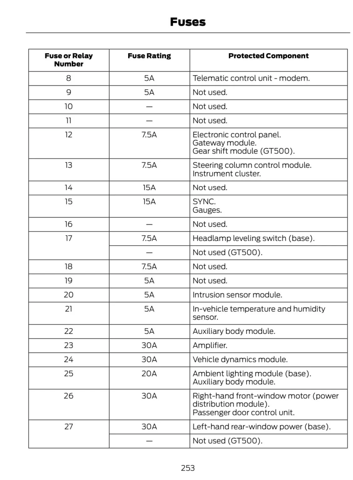

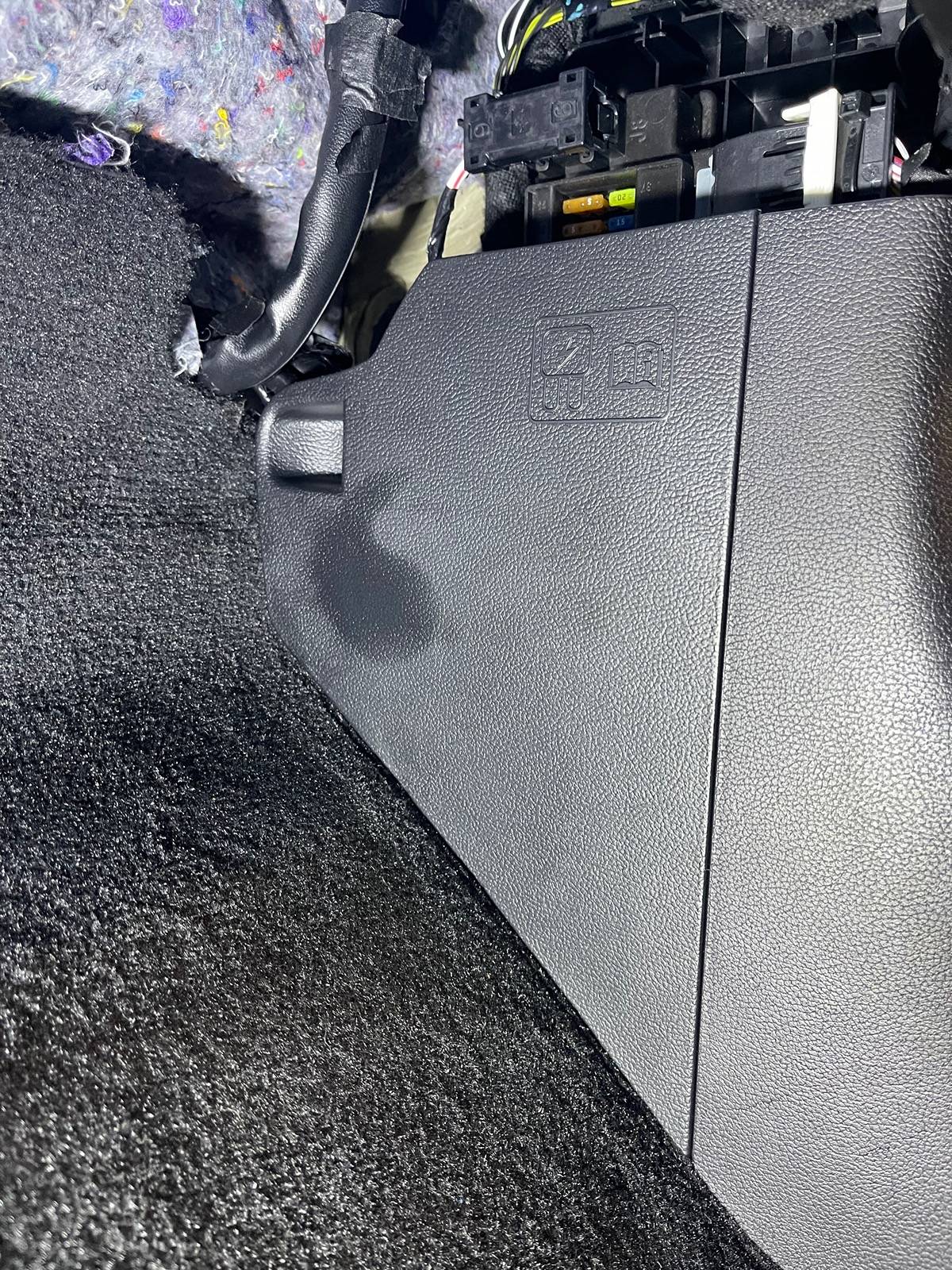

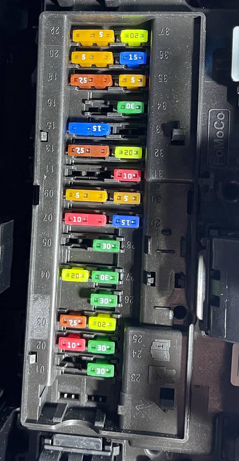

Am I losing my mind or is there no #8 fuse? Passenger footwell fuse panel. I see 7 and 9 but no #8 which is said to provide power to the nanny modem. 21 Mach 1 if it matters.

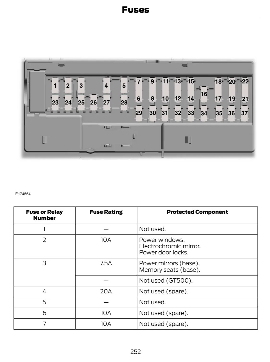

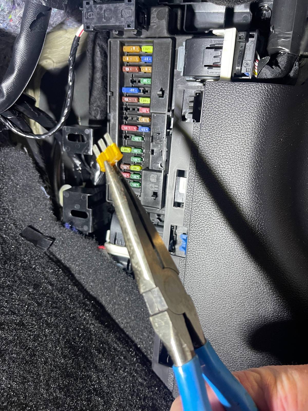

Ok maybe I figured it out. Manual says it’s #8 and that #9 is not used. The diagram shows 8 and 9 together like it’s one fuse. #8 is labeled in the diagram but is not in tge actual fuse block. 8/9 currently has a 5 amp fuse in it which matches what I’ve been told is correct for the modem. I’m thinking if I pull this fuse 8/9 I should silence the snitch. Correct?

Did you pull the fuse only or also unhook the connectors at the box?

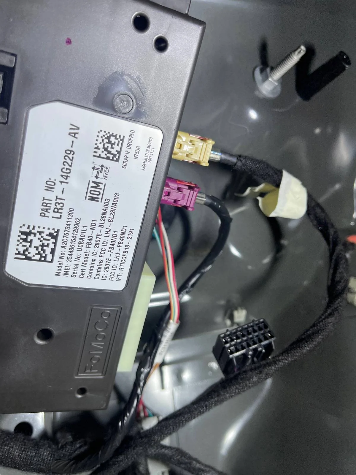

I pulled the fuse and the power harness at the modem. The other 2 connectors coming out of the modem are antenaeas.
