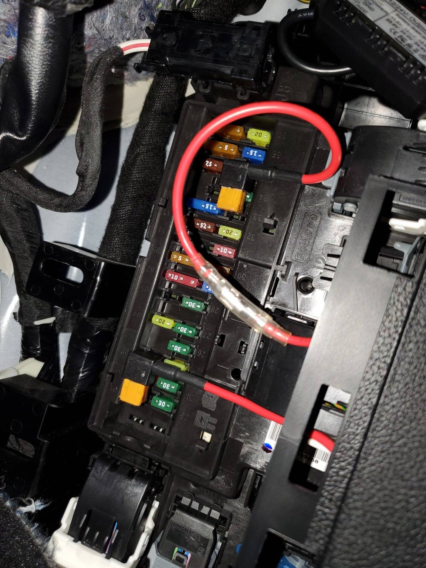

Here's my 2020 GT.
It looks like one tap in in slot 3 and the other in slot 35. If I recall correctly slot 3 the 12v constant and is responsible for power seats and slot 35 is 12v ACC that was empty on my car. Be sure to a 2021 fuse diagram (should be in your owner's manual) and a multi-meter to verify your setup is the same as mine.
My ground is behind that trim panel that is on the right side of the picture.
Haven’t had any issues? I know the post was years but just curious , I was gonna try 3 & 31. I have it wired same fuses as you momentarily but my issue is my dashcam restarts so rarely. I’ve just been lazy to pin point why the heck it restarts. But I’ll have to see. Sorry for the long story.
I haven't had any issues with my setup.
