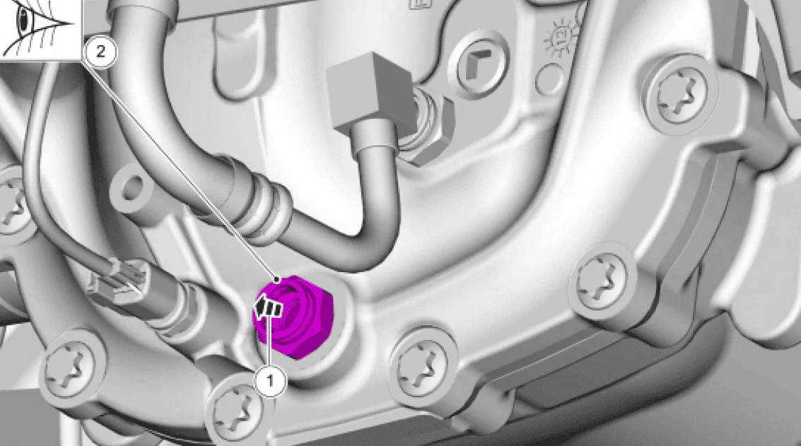

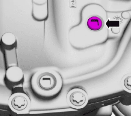

Testing age of the removal plugs, remove the fill plug first to ensure it can be removed to prevent headaches down the road.
Remove drain plug and allow it to drain.
Reinstall drain plug (25 lb /ft of torque (34 Nm)) then remove the Fill plug
Caution: If the cooling line was used as the drain method, that is 17 lb\ft of torque when reinstalling the plug.
Fill with Material: Motorcraft® SAE 75W-85 Premium Synthetic Hypoid Gear Lubricant / XY-75W85-QL
Then fill with clean friction modifier
Material: Motorcraft® Additive Friction Modifier / XL-3 (EST-M2C118-A)
Install diff fill plug and torque to 25 lb ft. (34 Nm)
That's the gist of it. I encourage you to purchase the service manual especially for a bad ass car like this.
Reinstall drain plug then remove the Fill plug
Install diff fill plug and torque to 25 lb ft. (34 Nm) & torque drain plug to the same or if it is the cooling line it's 17 lb ft (23 Nm)
I'd switch those first 2 steps if I were you. If you somehow can't get the fill plug out, better to still have fluid in the diff.

So, I've changed the diff fluid every year for the last four years on my 2016 GT350. My experience is that:
There is no drain plug on a GT350 diff - the drain plug hole is where Ford put the outlet line for the diff cooler system. The easiest way to drain the diff is by removing the snap ring on the lower pump line fitting and pulling the lower hose off. Don't bother with taking the fitting out of the diff (the service manual shows this, but It's not necessary).
The fill plug works just fine without any additional treatment. It has no tendency to leak because it's not submerged in oil like a drain plug would be. Take it out, fill the diff, put it back in and tighten it up. Personally, I WOULD NEVER use teflon tape on a steel plug going into aluminum. Teflon lowers the friction and you could crack the expensive and hard to replace housing if you snug it up too much. Besides, there's no benefit.
If you drained it as I described it above, then it takes 56 ounces of fluid to fill the diff - 4 ounces of XL3 and 52 ounces of Motorcraft 75w85. The correct level is 9mm below the bottom of the fill hole. DO NOT overfill it.
Forscan runs the diff pump just fine. The instructions that @NoXiDe posted above don't include this important step. You refill the diff, put the fill plug in loosely and run the pump for a minute or so to get air out of the cooler lines after the fluid change. After you've run the pump, use a piece of bent wire as a dipstick and check the level before you put the fill plug in for good.
