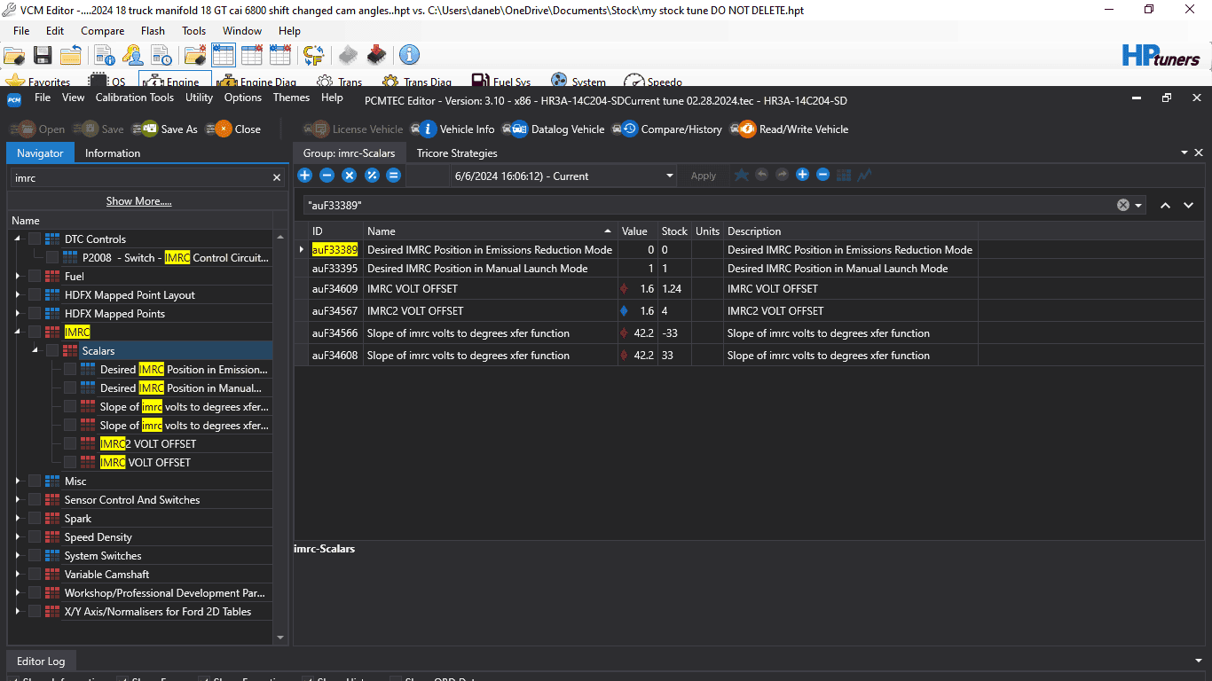

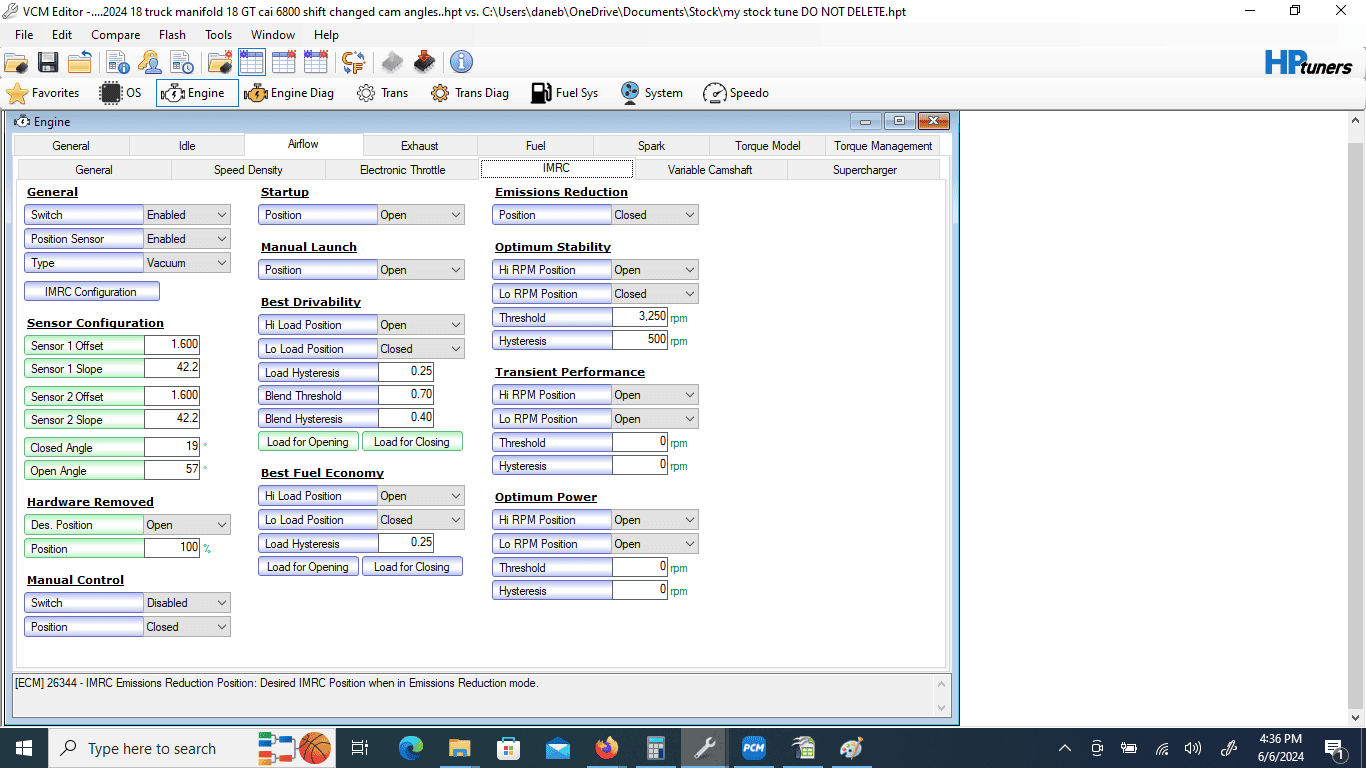

The 2018 imrc are vacuum actuated and there is no vacuum at wot. I don’t think they are closing at wot. However, the actuator and sensor voltage ranges are different and possibly even reversed vs gen2. If that’s the case it might be sensing a false error, which throws a code and potentially limits power, or using the wrong mapped points which affects all sorts of things.
K4fxd
Apr 2, 2020
122
13,472
12,287
NKY
Dan
2017 gt, 2002 FXDWG, 2008 C6,
Here are the settings for IMRC. Use the spread sheet or search function in PCM tec to set all of these to what you see.
tdstuart
tdstuart
Apr 6, 2021
72
2,570
1,298
Arizona
Triston
2015 Mustang Gt Premium
Already have slop and offset updated. Looks like the closed and open angle needs to be updated but the spread sheet doesn't have it and I can't find it in pcm tec either
Edit: Found it
Here are the imrc angles in pcmtec:
IMRC angle considered closed (auF34574) [STOCK: 78] [18+: 57]
IMRC angle considered open (auF34570) [STOCK: 12] [18+: 19]

I already have those values and that's what I've been using in every tune. Read the post right above yours. I couldn't find the imrc sensor closed/open angles but I found them
