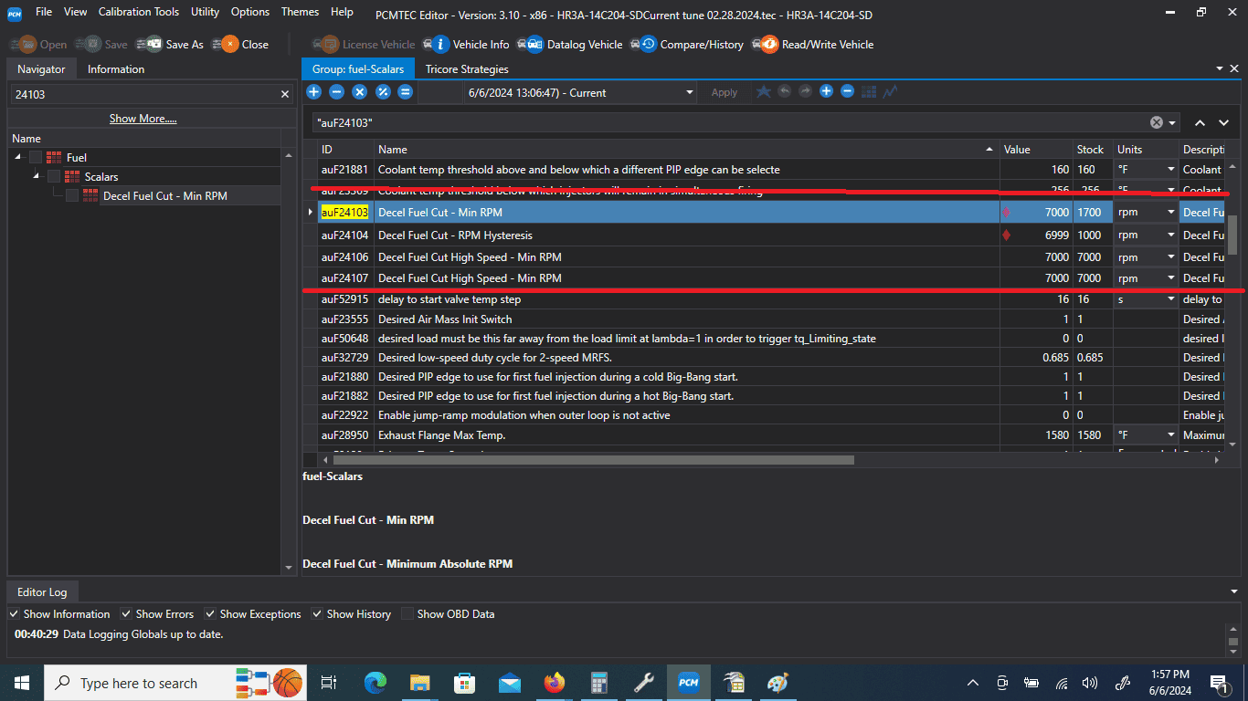

Edit: Also fuel trims going very negative right on engine decel are still present.
That is probably DFCO, (Decel fuel cutoff) turn it off if you don't like it.
I’ll look into that. Any thoughts on the major loss of power?

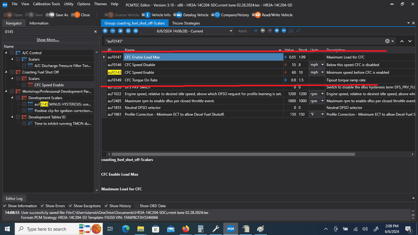

Copy the red box
