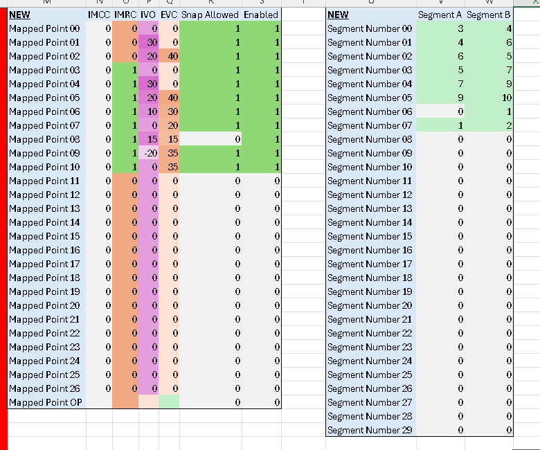

This is what I came up with as a starting point. So the snap lines just help the car focus when transitioning from one mapped point to another?

Murfie recommended 9 max,, I said 6 but get by with 3 for now, yet you arrived at 11. You have several points that have no real purpose and will take a ton of time to properly calibrate.
I’d start with just 3: 0/0, 5/35, and -20/35, all with imrc open. This will get it started and idling, cruise in an ok place, and everything you need for wot. If you want to smooth the idle a little you can add one at 20/0 later. If you want to improve cruise fuel economy you can add 15/50 later. If you want to further improve fuel economy you can do 1 imrc closed point at 15/50 or 3 if you want to follow murfies logic. There’s nothing wrong with starting with a minimal amount and adding more later as you get time.
Snap lines just force it to interpolate between only 2 mapped points if the measured coordinate is between the 2 points. Otherwise it would interpolate data from all of them, weighted by distance. I wouldn’t say it’s only used for transition because the stock tune has it regularly running in steady state on snap lines. For us, snap lines make it much easier to tune because only 2 points are at play at a time.
In my 3-mapped-point example above, you would make a snap line between -20/35 and 5/35, then command all OP cam timing to be between those two points. That way, it only uses those two points and, no others, at wot.

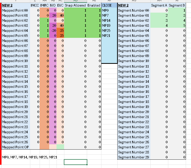

So maybe 6 would be better place to start?
MP0 - MP3 are for idle and cruise
MP4 & MP5 is for wot as the car moves from MP4 -> MP5 at high rpm
Edit: MP3 was incorrectly labeled, updated
I’m confused. I laid out fully explained suggestions in post 852 and several times since then. Markmurfie offered up a good plan in post 855. But now you’re posting something that doesn’t match any of the above, and asking for input. What’s wrong with all the layouts that were suggested?
