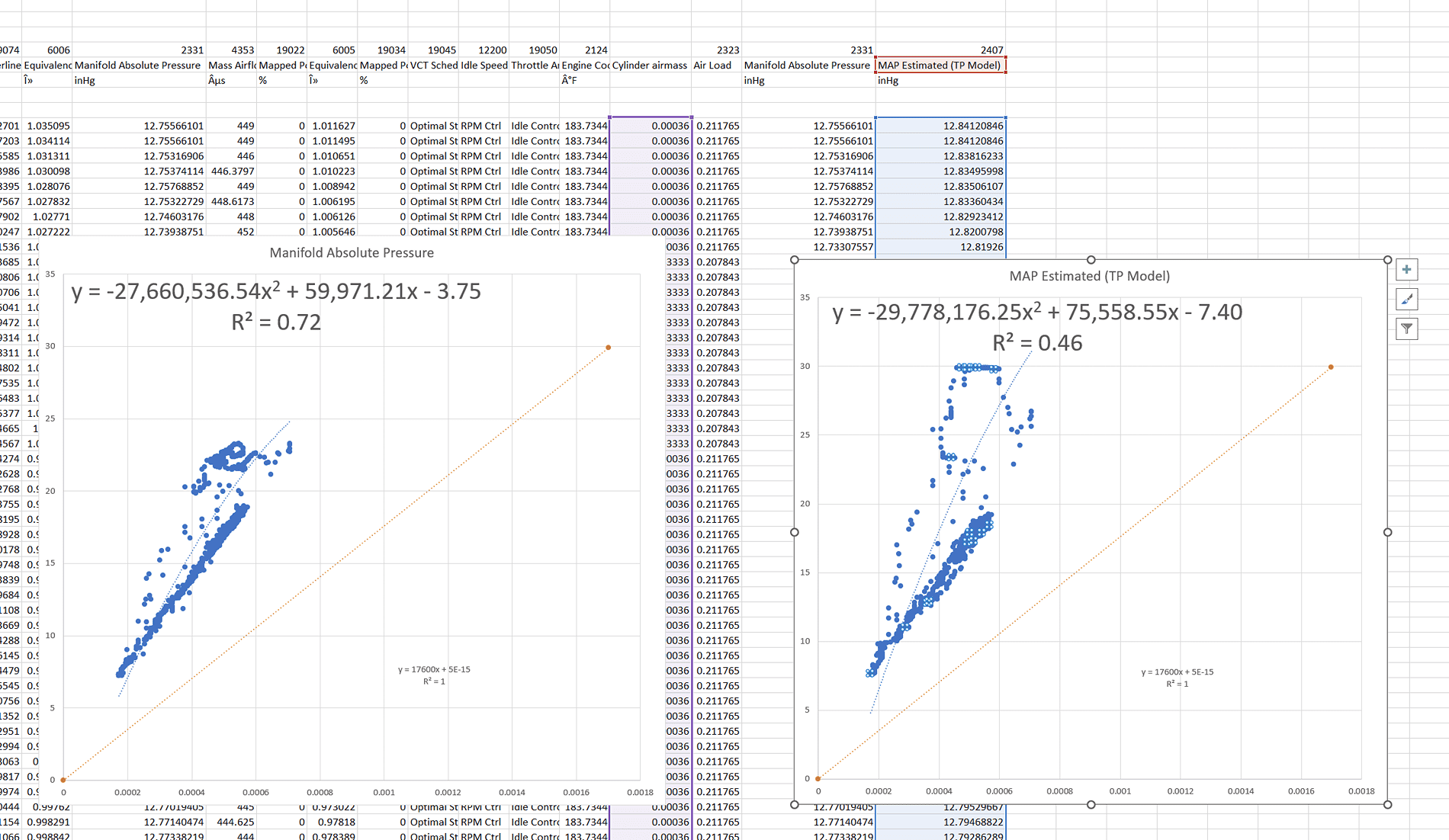

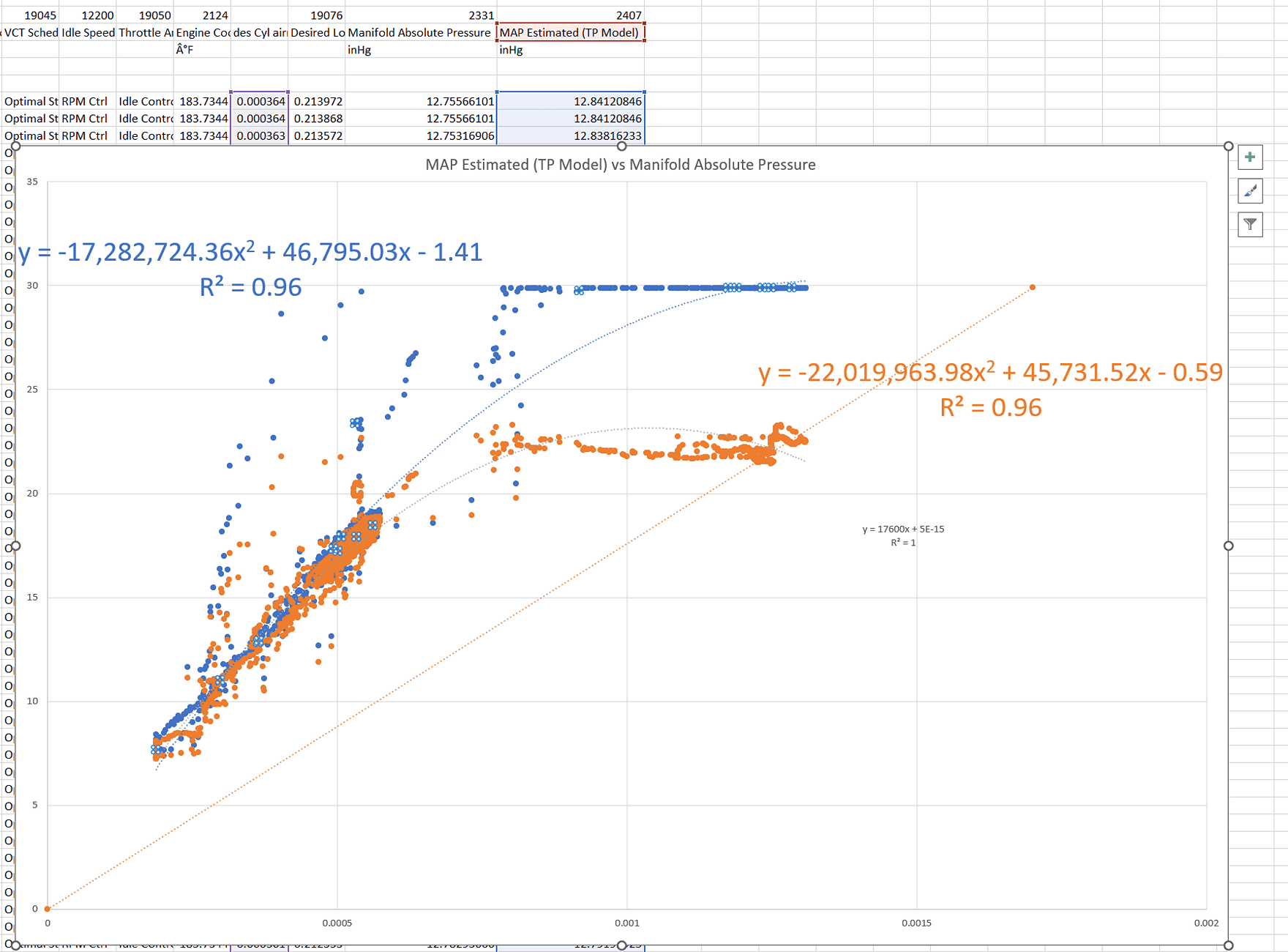

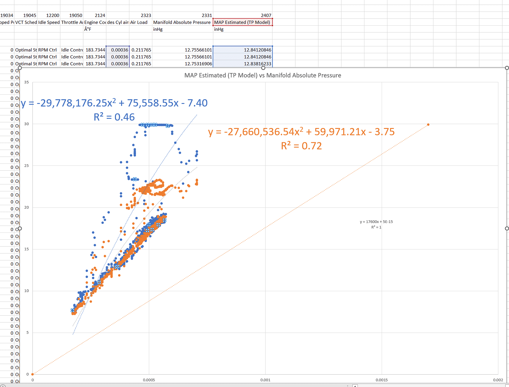

Added it to both these logs. Forgot to add the actual MAP to the first so added it to the second. let me know if you need a longer log with MAP.
They look pretty close to me for these low airmass loads. I believe it's hitting the IPC pressure MAP max for the given load and limiting it. You might need to set that table to 32 inHg until we have a better idea of where the MAP max in the IPC should be. Just moving all the IPC stuff out of your way while you figure out where things are going to fall will help you from hitting these limits while trying to tune this combo.
The Independant Plausibility Check (IPC) is a system for checking that operating parameters are falling with in a plausible min and max limit. when out side that limit the ECU can step in and perform actions like shutting the throttle or going into limp home mode, ect.
comparing them directly
Compared using desired cylinder airmass values.
It might even just be the learned Barometric pressure being set to max/min of 30 that is creating this difference now.

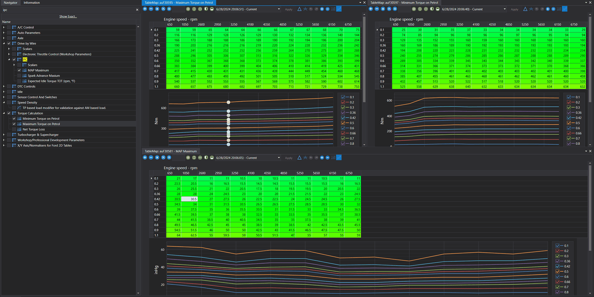

Make these three tables appropriate values that will not limit MAP or TQ.
Example minimmum torque can be set to 50nm, maximum can be 800 nm, and MAP can all just be 64inHg.
Updated those and still feeling like the car is limiting. Maybe its an issue with the cam angles themselves? Going to try and switch to a different MP and see what happens.

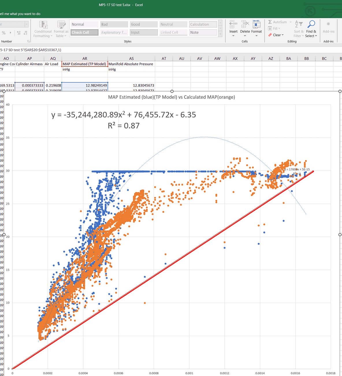

It has definietly made a difference raising the IPC out of the way.
I will get you what to modify SD coeffecients for MP 5 and MP 20 soon, it takes a bit more time to parse the data out per the RPM ranges you will need, these are just big picture to show MAP and TB MAP are following each other very well now, even with just the simple changes you made to the few spots in the SD.
This will not get your desired airmass and MAF closer to one another. That is going to need to be done in the driver demand tables and torque to load model tables(torque calculation in PCMtech). Its why I said start there, but I am fine with making your SD match what your TB is saying for MAP.
Test 5 MP% mostly, IMRC didnt open for MP 17. Test 6 looks similar, just less points. .0006-.0008 clyinder airmass is the biggest difference. If you go back to post #776,n where these coeffecients came from, that spot was to be expect to have the biggest difference.

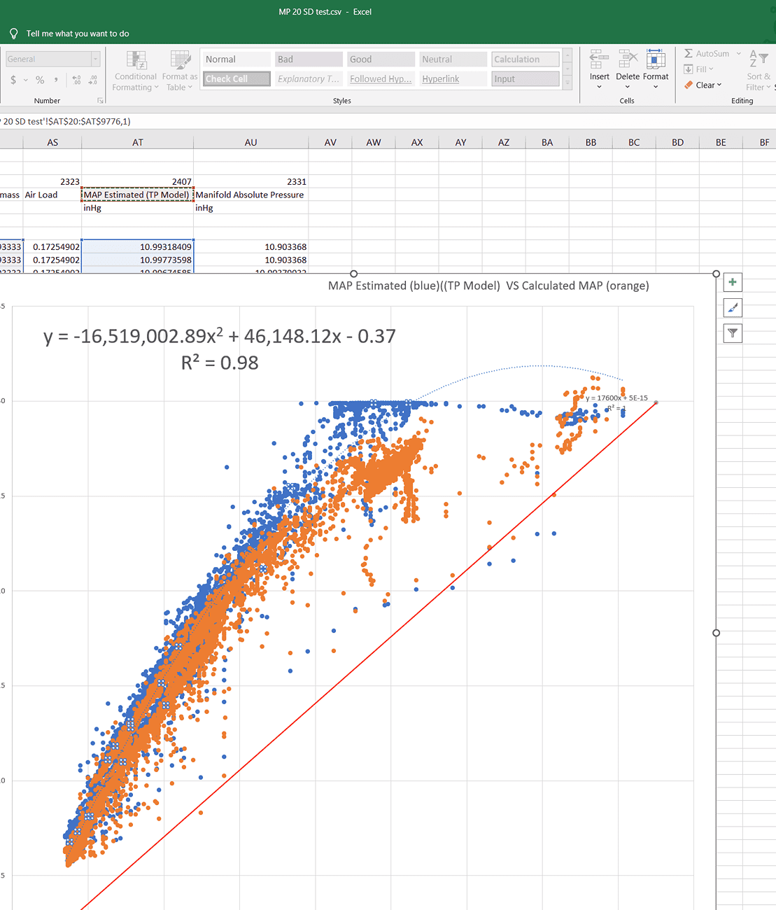

MP20, much much closer even though its stock.
