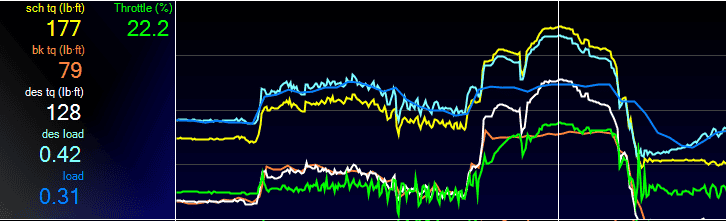

Red arrows:
Im tring to point out throttle at idle is controlled completely by indicated torque, not desired,ETC, or engine brake torque. you see the spike in throttle coorelates with the spike in indicated torque.... I was tring to explain this to Mike, but he kept pushing that torque loss went into this. These values are in the torque calculation tables as direct look up values. The raw torque to load/ load to torque values.
I've posted several times in this thread that scheduled torque is how it determines idle throttle angle. The question I've posed to you is, how do you think it determines the value of scheduled torque?
Blue arrows:
ETC and desired torque agree. Schedule/ indicated TQ follow the demanded torque. The throttle even follows. The engine brake torque flat lines. This is where it gets complicated, because all that stuff as described by Mike comes in to play on top of the spark and fuel torque ratios. This looks like a torque limit, not error.
This is really interesting...and terrible. I bet the car responds to part-throttle pedal input super weird and laggy.
If we follow a simplified logic flow at the snapshot in the snip, pedal position demands 128 ftlb -> logic calculates friction + accessory + pumping loss + lambda correction + timing correction = 49 ftlb total -> scheduled torque determined to be 128 + 49 = 177 ftlb -> look up torque-to-load at measured cam timing and interpolate -> desired load calculated to be .42. He didn't log desired airflow but if he did, my math says .42 load at 1411 rpm = 3.96 lb/min. The next step for the logic is to determine the throttle angle needed to achieve 3.96 lb/min airflow, which is dependent on the TB model (assumed to be stock and correct), calculated baro (assuming it's band-aid locked to a semi-accurate value), and calculated MAP. Now, going back to what I said earlier, the SD model calculates MAP as a function of MAF et. al. With a later-than-stock closing intake valve, I would expect the MAP to be erroneous on the low side since the stock model doesn't adequately account for late-IVC-induced reversion. This being the case, the actual MAP is going to be higher than the calculated MAP. Higher MAP means less dP across the TB than it expects, resulting in less flow than it expects, which is exactly what we are seeing since the actual airflow measured is only 2.88 lb/min (.31 load) at that time. If the airflow is in error, there is a PID feedback loop to correct it, but it has limits.
I can say with a fairly high degree of certainty that this problem can also be traced back to the SD model.
@tdstuart if you refuse to do the proper procedure of logging MAP from a sensor, isolating mapped points, and properly calibrating the SD model, you could try simply scaling all of your active SD slopes up by a factor of 1.1. I think the final correction will be more than this, but baby steps. Log your load vs desired load or MAF vs desired MAF and adjust the SD slopes until they meet up. This is a very quick-n-dirty way to get within the control span of the airflow PID loop, but it should get you closer than you are now.
If logic calculates friction + accessory + pumping loss + lambda correction + timing correction = 49 ftlb total
Then how is engine brake torque at 79, twice that value lower than Scheduled torque? How is the ECU imposing this limit and coming up with the right controling engine parameters to achieve it?
You are doing it backwards.
Desired torque gets "idle torque" added on to it to achieve Scheduled torque.
It just so happens idle torque nearly always equals TR and loss torque. Just durring limits idle torque still remains the same, but loss torque and TR corrections get bigger.
Desired torque is 128 ftlb and the logic determines that it takes .42 [desired] load to get there. But the actual load is only .31, which is then converted to a brake torque of 79 ftlb. In other words, driver is requesting 128 but only getting 79 due to a problem in the calibration. The problem, I believe, is that the throttle isn't opening enough due to an inaccurate SD model.
As I said, it's not a limit, per se, but more of an inaccurate SD model -> inaccurate TB dP -> inaccurate throttle angle, and not enough leeway given to the PID ETC controller to fix it. Short of installing a MAP sensor, I don't see why modifying the SD model until desired airflow = MAF, especially with the PID controller switched off, wouldn't yield satisfactory results (only possible if the TB model and MAF are both accurate).
Ok and where are the "desired torque" and "idle torque" derived from?

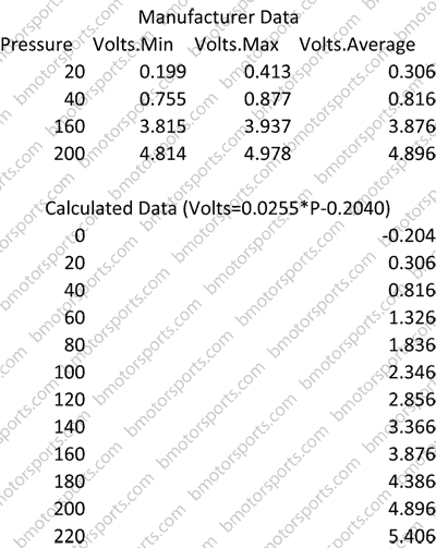

I attempted but put off correcting my SD model in my Gen3 Comp cams car. Here's my setup for a map sensor, from my post on hptuners forum. The transformed output looked good despite my inability to persevere with data and calibration. My SD model and torque tables are off but my car runs strong and smooth.
Middle pin of the AC pressure sensor connector works for logging.
- USA made 2 bar sensor... 5v power & ground, middle pin is sensor output
- add a circuit fused power off the underhood block to feed the power pin with this transformer: https://www.amazon.com/gp/product/B0...?ie=UTF8&psc=1
- Ground from an underhood ground
- Middle pin of map sensor to middle pin of AC pressure sensor connector (nothing to/from the 5v and ground pins of the ac connector. maybe that would have worked but I felt most comfortable feeding power separately from that sourced from the ECM
- Log AC pressure voltage
- Translate voltage into absolute pressure after logging
