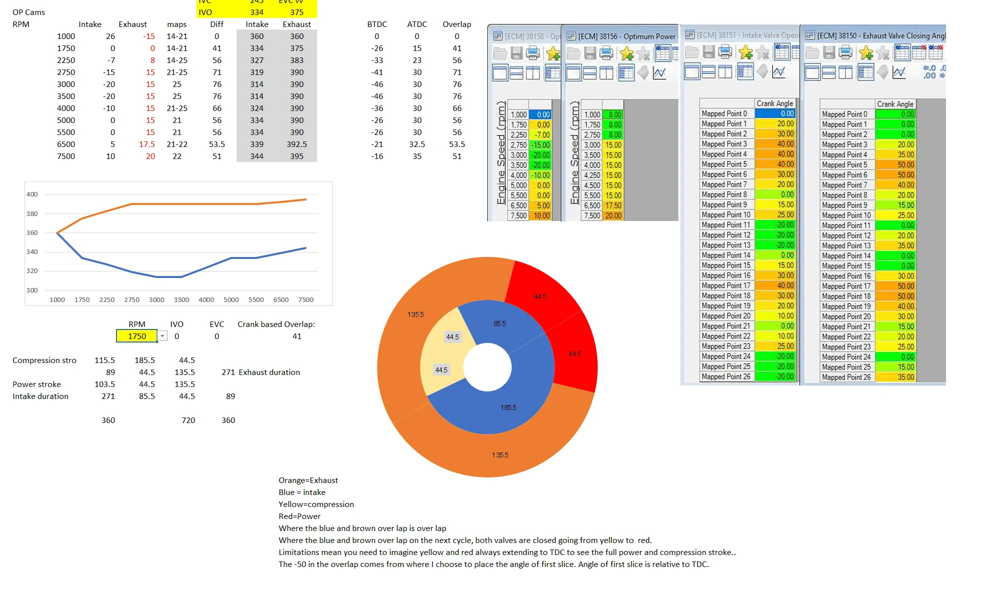

Ya I want @markmurfie to check my offset calculations he has looked into this a lot
I can tell you I recall 263 being the duration for both intake and exhasut cams.
Then going through the values in the calibration it came out to 259 for both. I suspected they used seat to seat numbers and took 2* off both sides.
"Yes 259 is the camshaft degrees. The cams are 263 seat to seat for both intake and exhaust, I believe they took 2* from both sides as the ramp rate of the lobe there is minimal. If the exhaust valve opening was in the calibration it would be 470*
340(open)-239(closed)=101= time spent closed (720-202)/2=360-101=259.= time spent open. 101+259=360"
I said that along with a sheet I am attaching a picture of with all the math and it clicked for them in understanding the cam timing events. These base values dont really do much. The calibration only needs to know the VCT phaser ranges and control. Which you did not change with lock outs or limiters. intake still being -20 to 50 and exhaust being 0 to 50.
I would share the sheet but I had to make 8 moving parts on a doughtnut graph, and things seem to get lost in translation if its not opened in office 2016.
I think Mike is right about injector timing. They may also play a minor role in torque loss calculations, but nothing significant. You are better off tuning your torque tables, or tuning your speed density.
If you really want me to I will review the info you posted and let you know if I think its correct or not, I just dont know if it will have any significant effect on tuning your car.

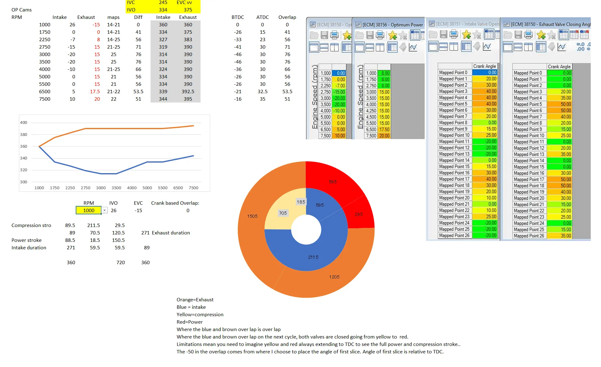

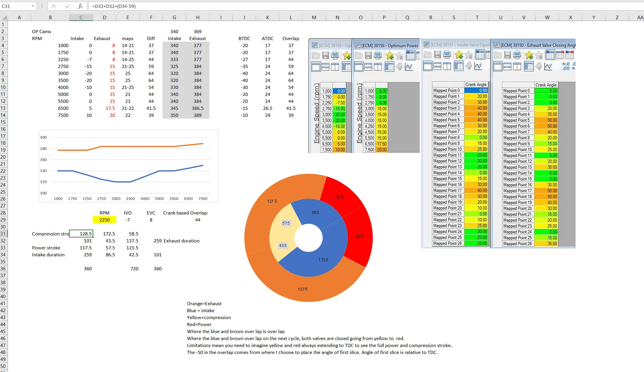

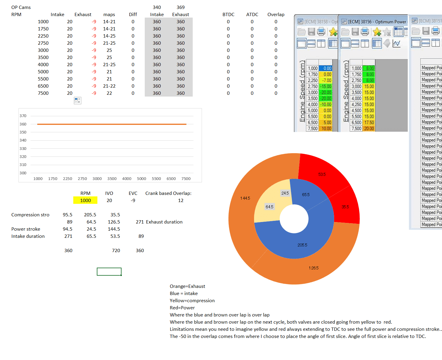

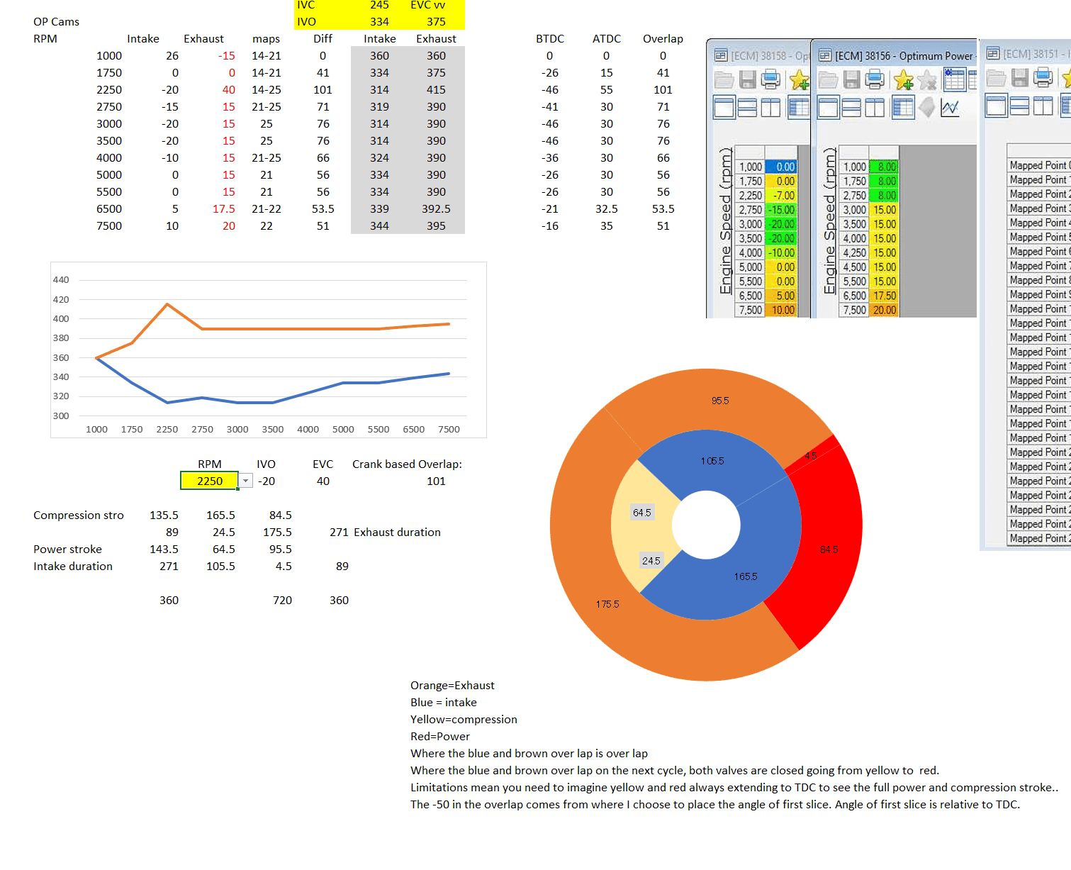

I reworked the sheet for a duration of 271 on both intake and exhaust as thats what the specs you posted stated for seat to seat. when you command IVO and EVC to 360 or TDC you can see how much over lap it actually still has.
I corrected the base values at the top of the sheet filled in yellow.
And here is your base overlap at 271 duration.
It goes from a base of 29 to 41.
Then if you want to go absolutly nuts and full overlap.
In summary this is what I got.
Comp Cams
EVC: 375
IVC: 245
IVO: 334
If you want to advance these 2* go ahead, I just dont know if thats just .050 as with everything else in those specs or applies from seat to seat as well.
EVC: 373
IVC: 243
IVO: 332

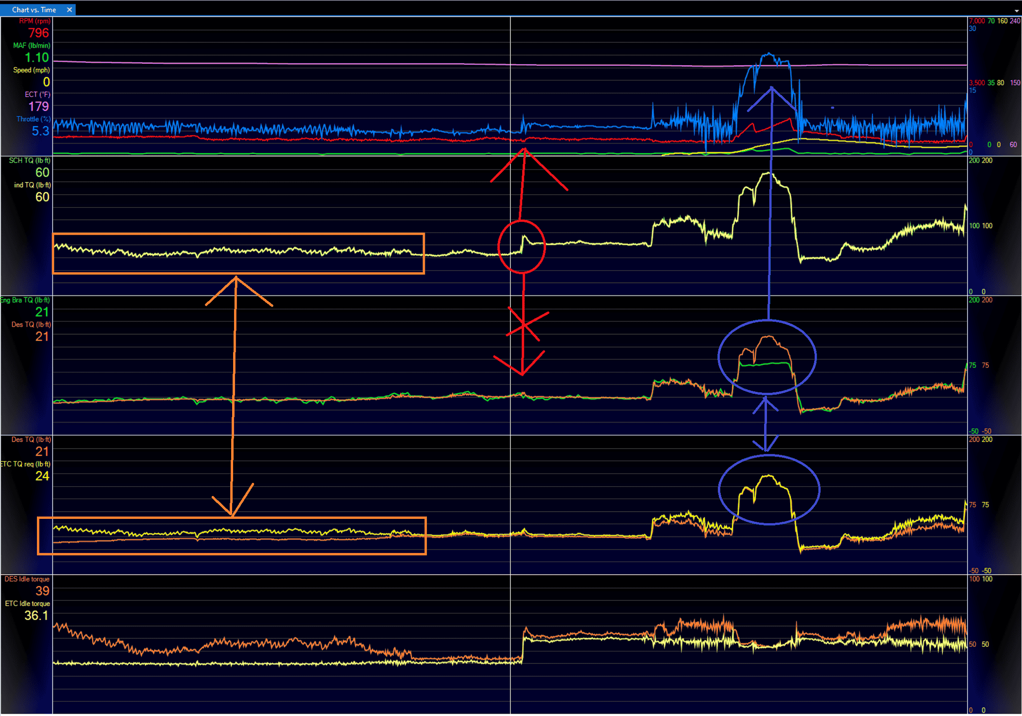

Heres a few observations from your MP13 cam lope log. Some basic observations you may not already be aware of: Schedule and Indicated torque report the same torque value. You can also see desired torque is kept in sync with engine brake torque, as much as possible.(This keeps your foot and the engines output in sync via a feedback loop) Then finally Desired torque and ETC torque are suppose to agree, but yours, at times, do not. you have desired torque and engine load error.
Red arrows:
Im tring to point out throttle at idle is controlled completely by indicated torque, not desired,ETC, or engine brake torque. you see the spike in throttle coorelates with the spike in indicated torque.
I suggest starting here to tune your idle torque. I was tring to explain this to Mike, but he kept pushing that torque loss went into this. These values are in the torque calculation tables as direct look up values. The raw torque to load/ load to torque values.
Orange arrows:
ETC torque(MAF to load to torque) controls the indicated value, as long as the ECU is happy with it. No limits or other problems it allows it.
Blue arrows:
ETC and desired torque agree. Schedule/ indicated TQ follow the demanded torque. The throttle even follows. The engine brake torque flat lines. This is where it gets complicated, because all that stuff as described by Mike comes in to play on top of the spark and fuel torque ratios. This looks like a torque limit, not error.

If you are really observant, you would also see why I think theres something wrong with your throttle body. Its position shouldnt be so noisey looking, and be smooth. MAF sensors can cause this, but your MAF signal is clean.
