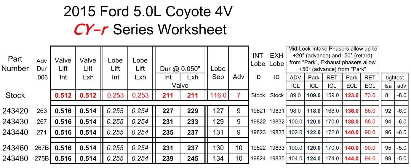

For reference
2015-17 Mustang GT Stage 3 N/A NSR Comp Cam Specs (243-443 CYR Series) (Adv Dur 271)
Stock 15-17 Mustang GT (gen2 Coyote) Cam Specs:
Reference for all cyr comp cams 2015:

This is related to the VCT phaser and their range of motion. After market cams you could change EVC, IVO, and IVC, but it doesn't change the phaser range of motion so all your MP angles don't need to be changed.
I don't think the opening and closing events remaining stock or changing them will do much.

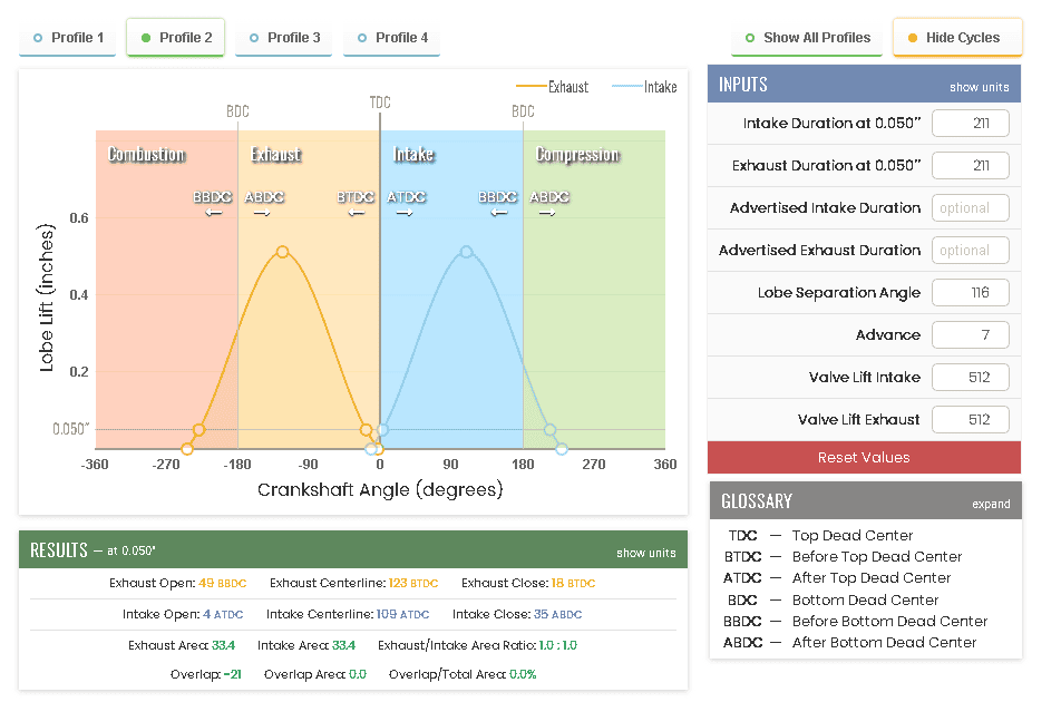

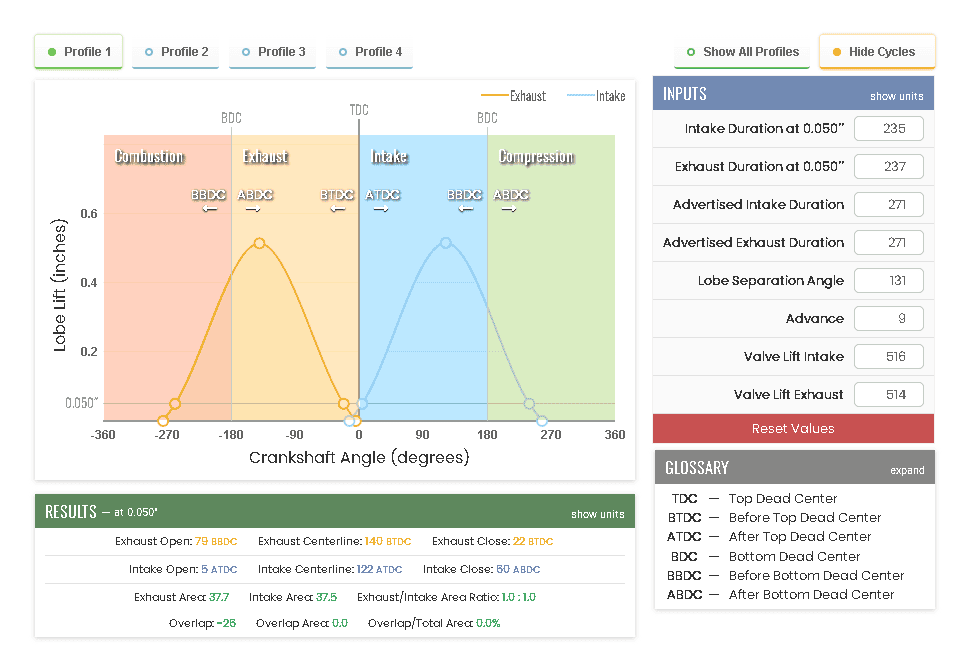

It appears to me that Comp added nearly all of the extra duration to the EVO and IVC side of the cam lobes, adding basically nothing in the overlap region (EVC and IVO). This makes sense because they don't want to get into a piston-meet-valve situation and we already know that the stock phasers mechanically prevent this from happening.
I take the IVO (340) and EVC (369) to be deg ATDCf, so IVO is 20 deg BTDC and EVC is 9 deg ATDC. This intuitively makes sense. The commanded cam angles are then added to or subtracted from these. So, IVO could be 40 deg BTDC to 10 deg ATDC, and EVC could be 41 deg BTDC to 9 deg ATDC.
I don't see where any of this really helps, though, because all the calibration data isn't that accurate anyway. Scooting the cam angles around a bit might help a little but not the right way to fix it and it's a crapshoot that might improve some things and hurt others. I do think your SD model needs work more than anything else.
