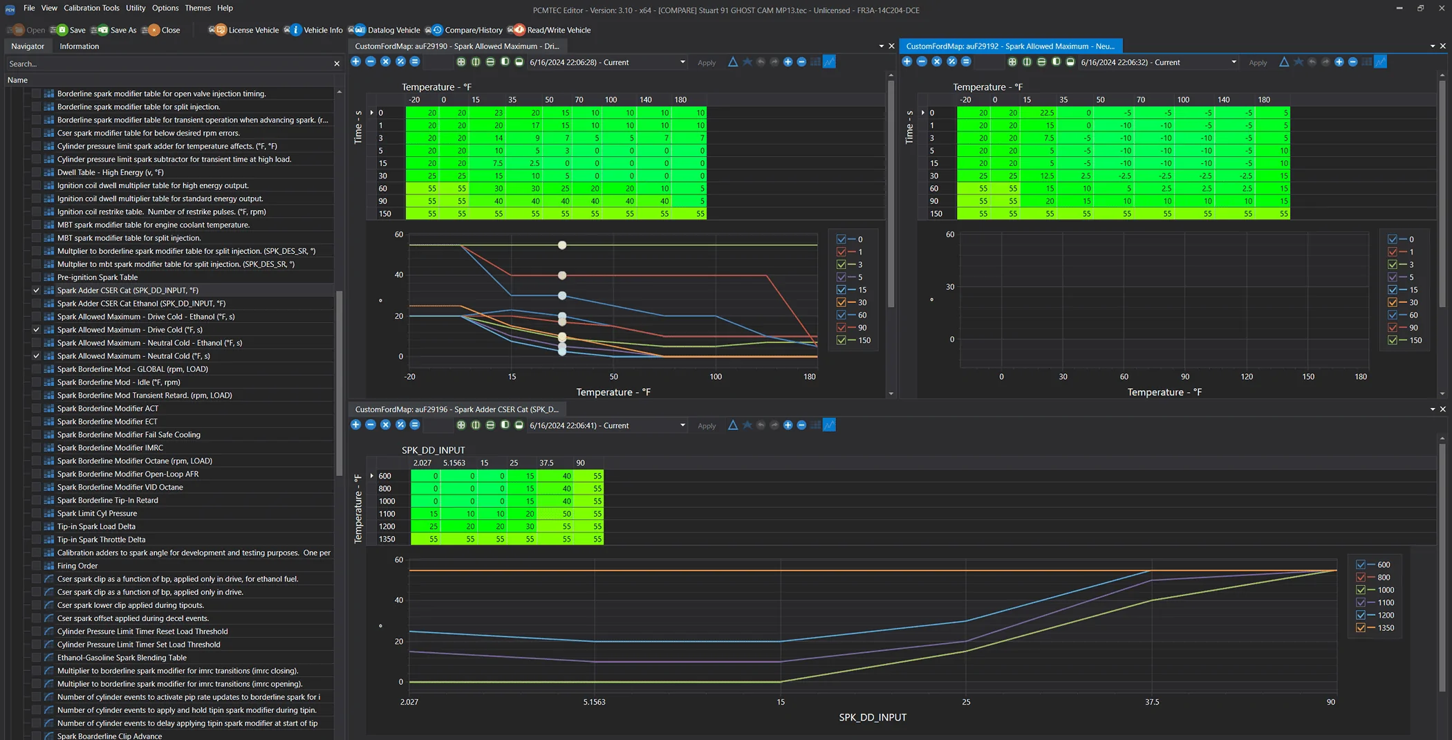

Raise these spark tables to 55 to eliminate emissions reduction mode on startup and go right to stability. low timing increases exhaust temps and heats up the catalytic converts quickly, raising this to 55 allows another spark source to be lower and therfore used.

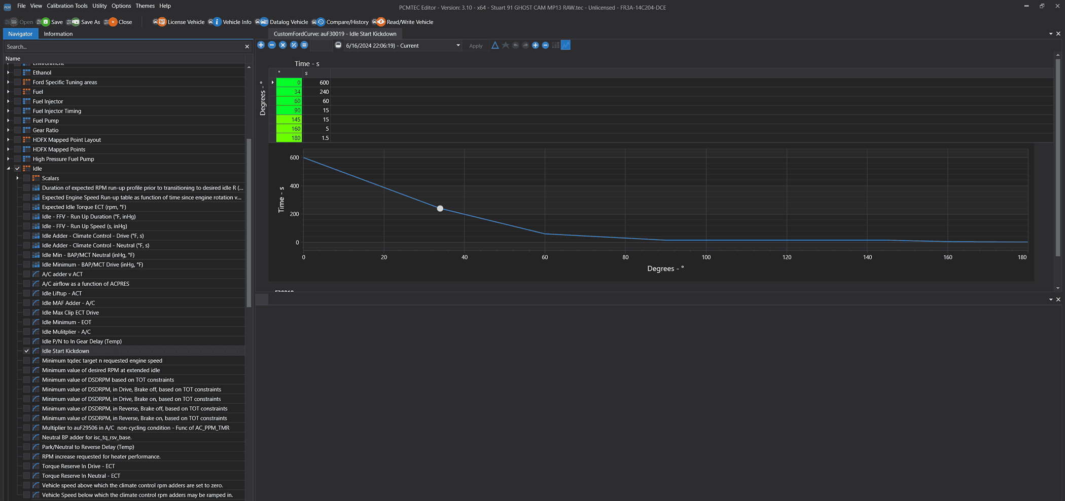

Reduce the times in the idle start kickdown to achieve a lower idle RPM quicker after startup.

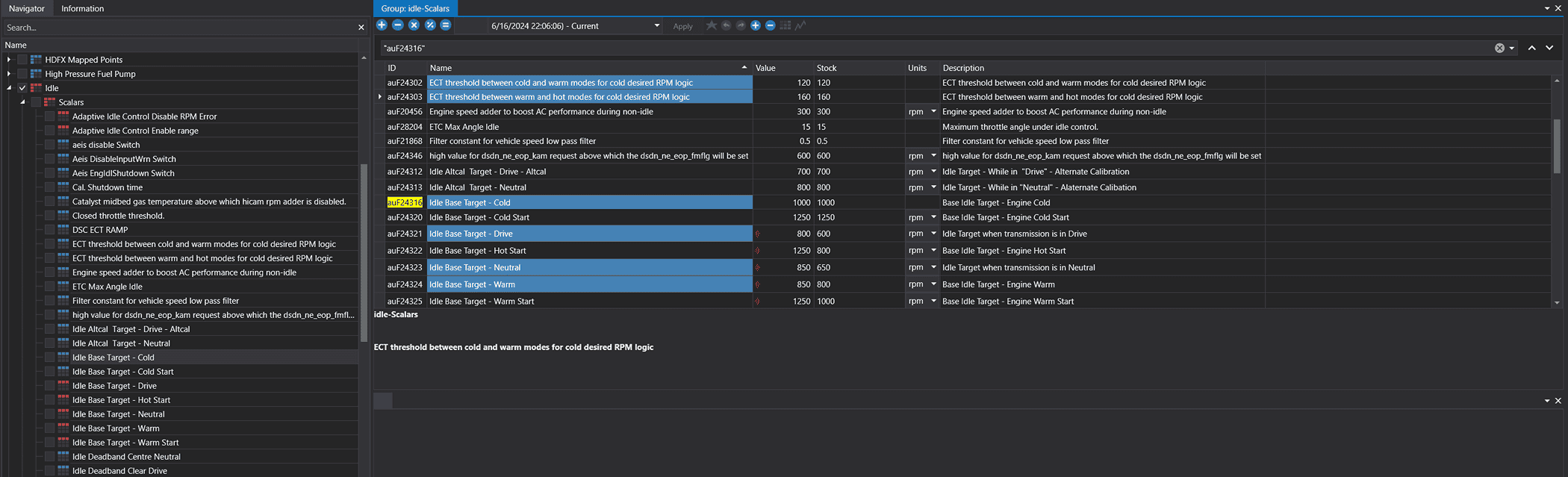

With out having to deal with the long startup times and startup RPMs Idle RPM is simplified you are left with the cold, warm, hot coolant temperatures which are less than 120, between 120 and 160, and above 160. These three areas get their own respective target RPM.

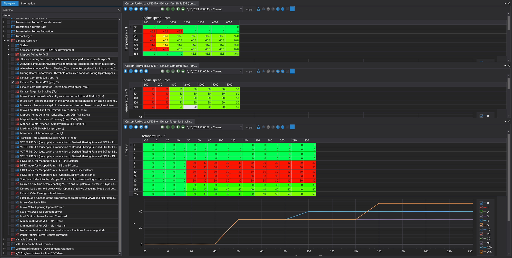

Then dont forget the exhaust phase limits that need to be adjusted to allow overlap at idle RPMS.
Currently your exhaust cam can't get to the 35* you are commanding it to go to for nearly 2 and a half minutes after the engine starts. close but limited to 30, not the 35 you want it to go to.

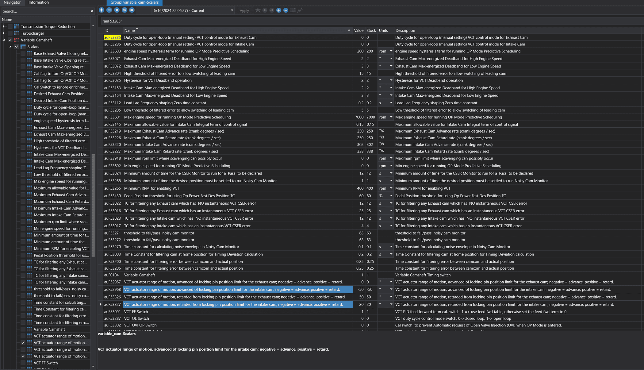

Good info. And ya I just forgot to raise that part of the limit to allow for 35.
There is a weird intake cam limit of like -17 or -18 when I try to advance the intake cam to -20. I couldn’t find it anywhere. Will have to get a log tomorrow. Maybe it’s an interference thing?
I recall once Ford went to the mid lock phasers all intake cam phase limits went away.
These values in PCMtec look a little funny. I would have thought they would be -20 and 40, not 20 and -50.
Ya I'm not sure what limit its hitting. Ill have to play around with it and get a log. It should have been -20 intake but I think it was sitting around -17.8, so I thought it was hitting a limit of -18 but couldn't find it anywhere.

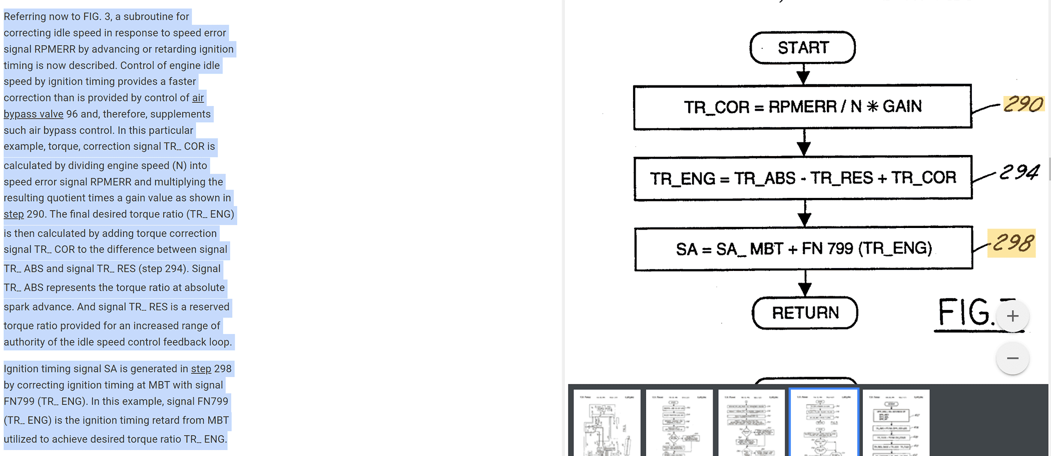

As I understand it, the target-N idle logic adds up all the torque needed at idle, which would include friction, pumping losses, accessories, and probably a couple of other things. If this were to equal torque produced, the result would theoretically be a stable idle. Then, they add "torque reserve" so the engine would make torque in excess of what is needed. This torque is converted to load using the torque-to-load tables, and then load is easily converted to airflow. The required airflow is then converted to a throttle angle using the TB model and dP (baro minus calculated MAP from the SD model). Now it knows where to send the throttle to make the right amount of torque plus reserve. Since the reserve torque has been added, it's actually making more torque than it needs to idle a given speed, so the spark timing (on a feedforward and PID feedback loop) is lowered to reduce torque, theoretically by the reserve torque amount. It then floats as needed to achieve desired idle speed (target-N). My experience is the net final spark timing winds up around 10 deg. If it's too high, then it loses its ability to control torque adequately and if it's too low, you get high EGT, more NVH, etc.
That said, lots of things in the calibration have to be right for all this to work. You can see that the friction data, pumping loss model (function of SD model output), TB model, SD model, torque ratio S-curves (that determine the torque vs spark timing relationship), MBT, borderline, TTL, LTT, and others all need to be reasonably accurate for all this to work. The SD model actually affects it a couple of different ways. We already know with aftermarket cams the SD model, torque model, pumping loss model, and MBT will not be that accurate, but that's another discussion. The best that can be done is to 1) confirm the final idle timing is around 10 deg and modify the airflow possibly easiest using the TTL tables and 2) check to make sure timing isn't hitting any limits such as MBT as it's trying to control idle.
No its much simpler. All that torque model loss stuff goes away with desired torque and estimated engine torque should be attempting to come out to 0.
See this image for a better understanding of how the table under idle> torque tab are used to determine idle speed control spark advance. absolute spark advance is the lesser of MBTand BDL. TR_abs comes from one of those two spark advances.
As long as you have desired MAF from torque tables at idle high enough, and enough authority in the idle torque control through gain and reserve, it targets the idle speed and achieves it fine.
Theres virtually no way its knock limited at idle, so keeping BDL values higher than MBT in this area seems appropriate. The simple way to control spark advance would be directly through the MBT values. You only need to touch the torque tables if you need the throttle to open more at idle, which to lower the spark advance and keep it in torque control not using all of the MBT advance, it might need.
Where, are you saying, is it obtaining the desired torque (and thus airflow) from if not from the engine torque model?
Im saying the torque model loss stuff goes away. " friction, pumping losses, accessories, and probably a couple of other things."
its all indicated torque and load to get desired maf. Even the TB is below choked flow vacuum so its model is inaccurate.
