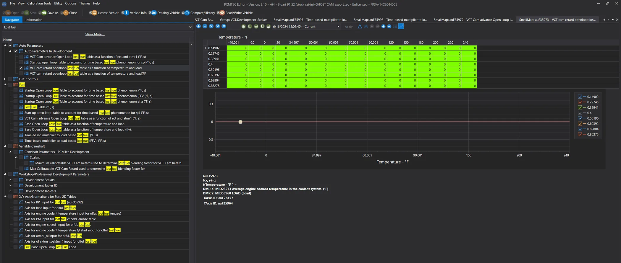

Fuel tab> openloop> Lost fuel > VCT.
IDK the table in PCMtec, but add some 0.1's in the idle areas for load and ECT.
The CL fueling has error that the O2 sensors them selfs are reporting due to air getting into the exhaust. Could be because of the potential misfire conditions or just the overlap itself.
Found it in PCMtec
Found it in PCMtec
Does yours say what the difference between them is? Looks like yours shows more info than mine
