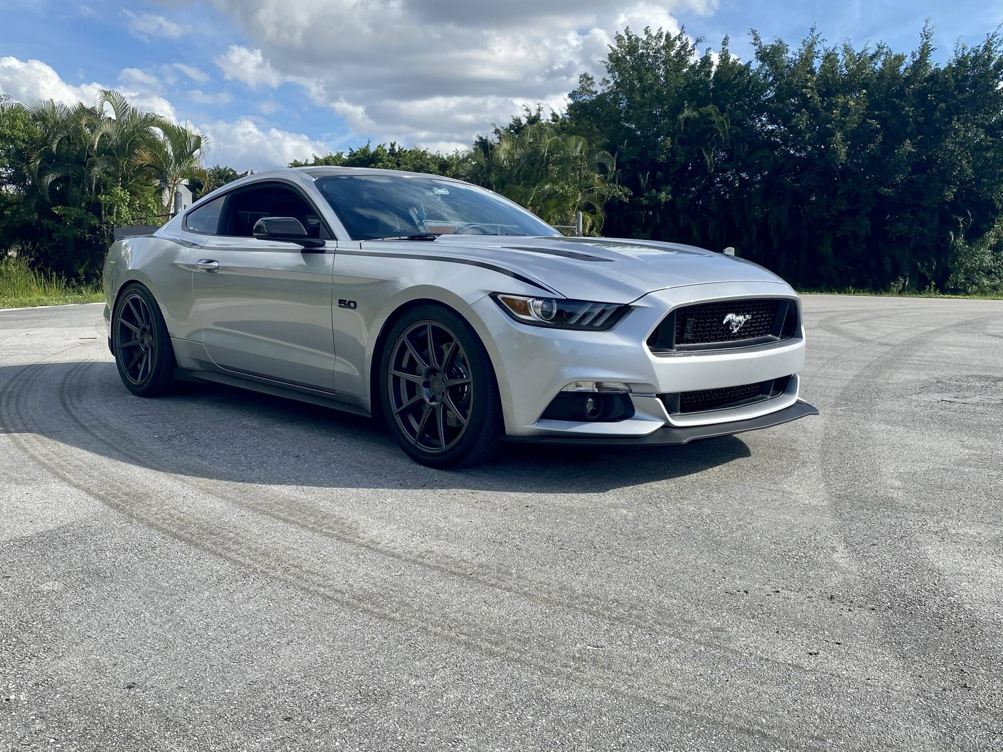

sorry pic of my old lady automatic s/c grandma car.
