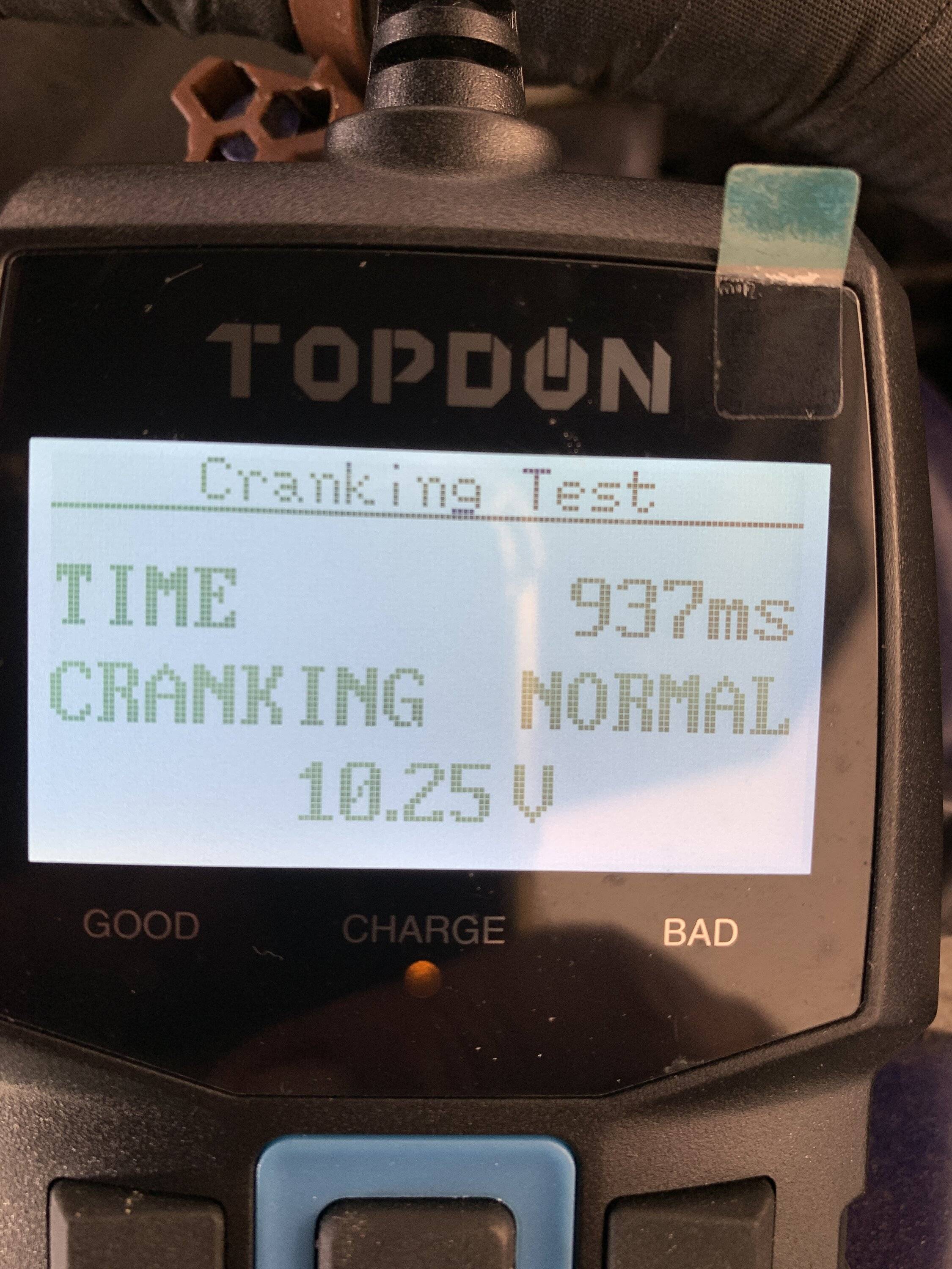

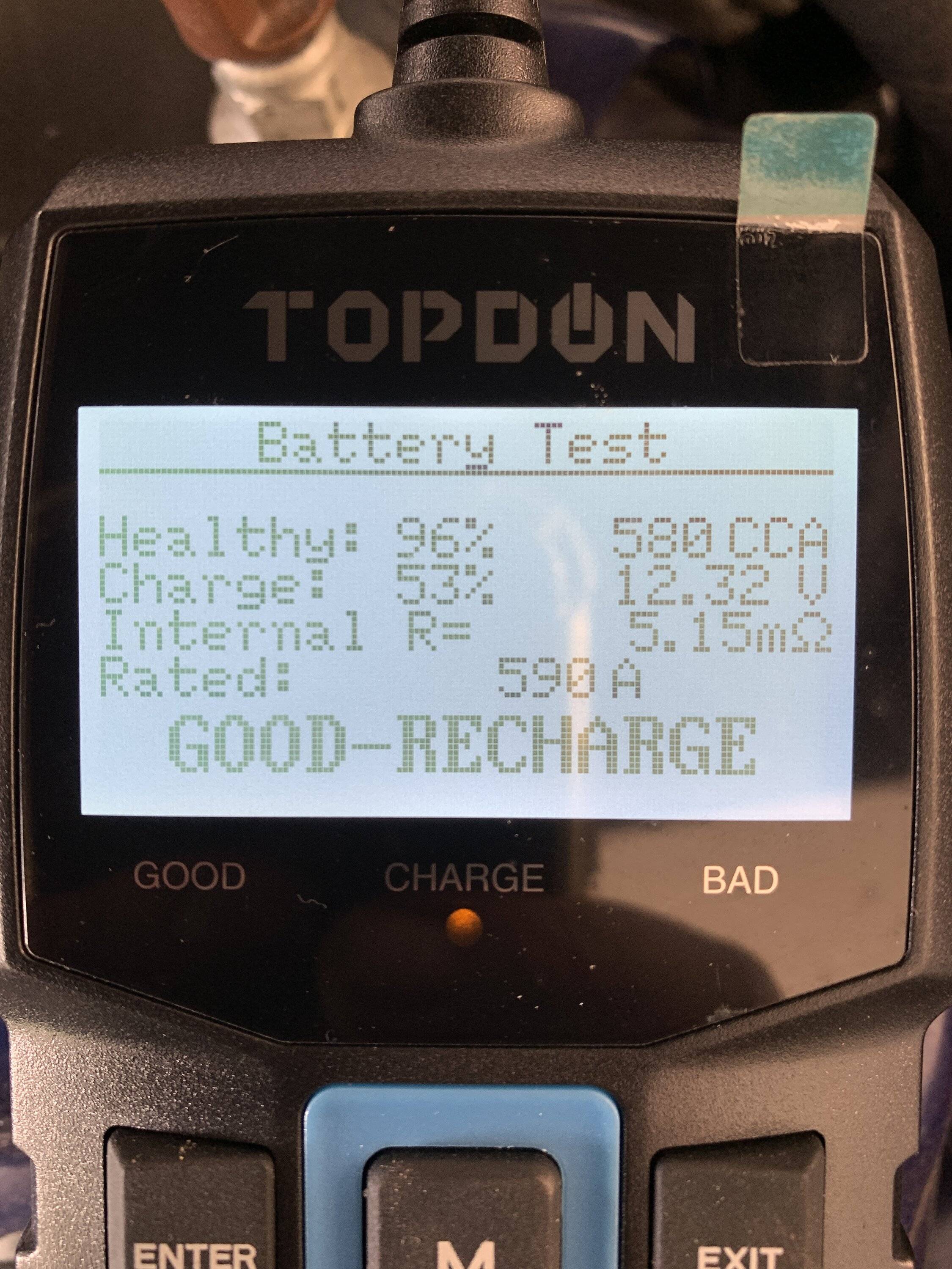

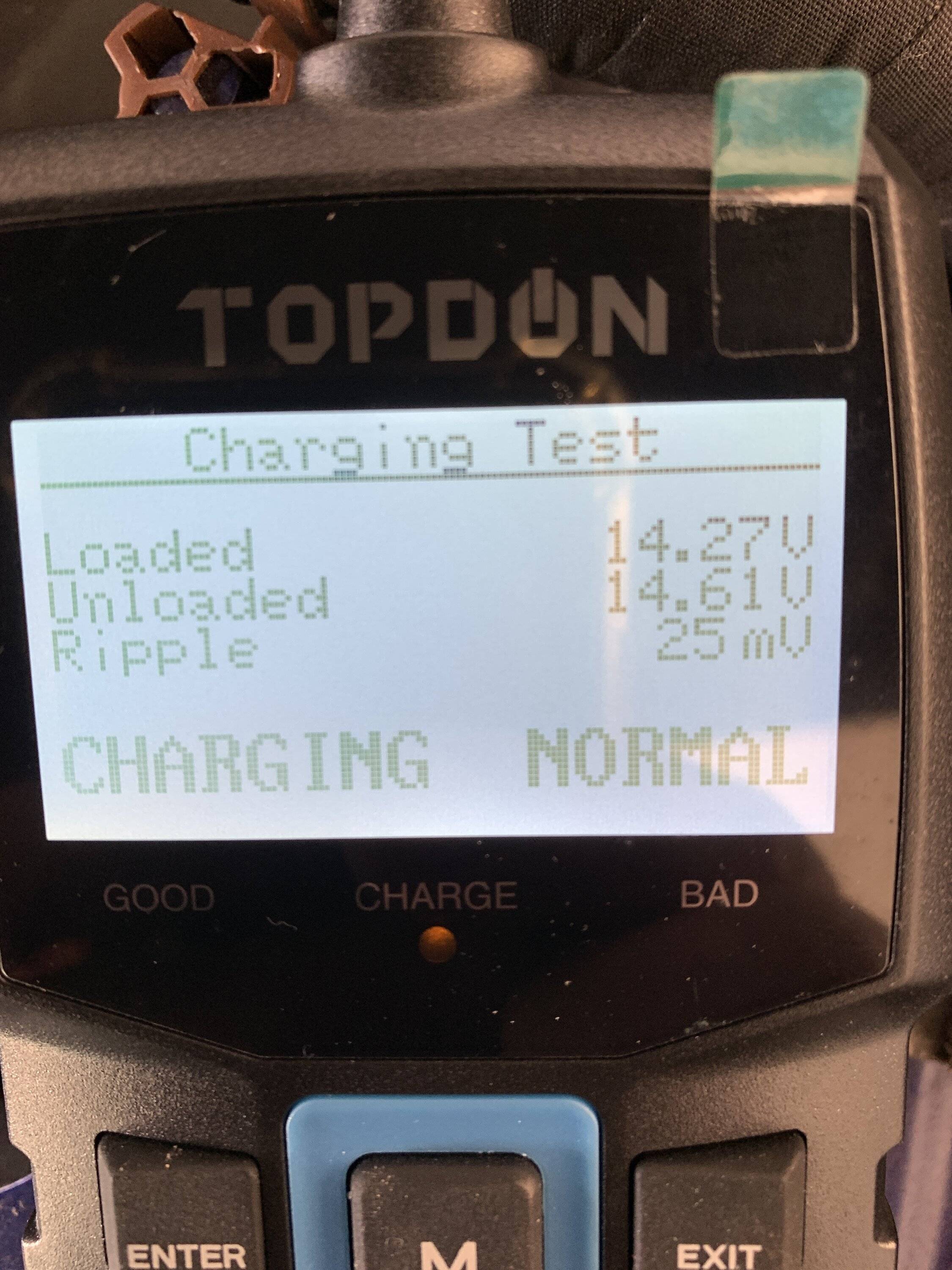

A new battery was installed in May 2021 and has never had any issue starting, but my battery tester shows a low settled voltage of 12.32v.
See screenshots of the test.
I put the battery maintainer on it through the night and the next day it misbehaved again.
I'll replace the battery if I had confirmation that's all that's needed.

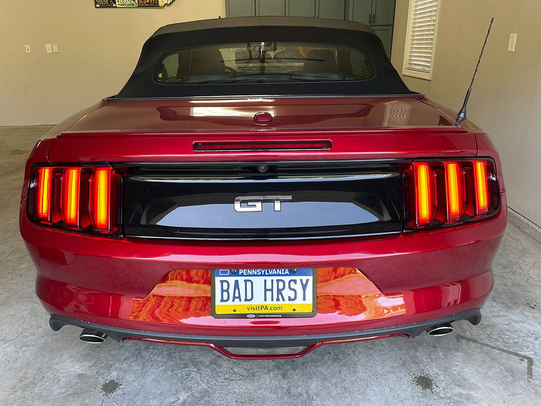

Just to follow up on this. I have resolved our issue. Our inner most LED strip on the passenger taillight was always lit up bright like the brake was pressed while the others were in parking light mode. I had the SSM update done to our BMCB which did nothing in our case. I purchased a 72 hour pass to the Motorcraft site so I could get official wiring diagrams and understand just what is going on back there. Turns out, it's stupid simple.
Each tail light has a 12 volt input for parking lights which illuminates all three bars in a parking mode state. When you press the brakes or use the turn signal or hazards, there are three additional wires coming from the BCMB to each tail light. So when you step on the brakes, it applies 12 volts to each of the three inputs for the tail light so it lights up bright. When you use the turn signal it applies 12 volts to each of the three wires in a sequence to light up the tail light in turn signal mode. If you have a 12 volt power source you can unplug the tail light, apply ground to pin 6 (black wire I believe) and then apply 12 volts to pin 2 for park lights, pin 3, 4 and 5 for the bright turn signal/brake light.
I wanted to be sure I was replacing the right part before I bought a new tail light so I unhooked it from the car, ran my simple 12 volt tests above and the tail light worked exactly like it did IN the car. Clearing the BCMB of any issues. In our case we needed a new tail light. This might help someone else diagnose their tail light before stupidly spending $160 on an unneeded reprogram at the dealership.

I just did the test and this is what I found out. When I connect to pin 2 the middle light turns bright. Pin 3 the outer and middle turns bright. Pin 4 the middle turns bright. Pin 5 the middle and inner turns bright. What should I be seeing when I connect to each pin?
I went back and checked the other tail light. Pin 2 is just normal lights. Pin 3 the outer turns bright. pin 4 the middle turns bright. Pin 5 the inner turns bright. I'm guessing that is what the tail light is supposed to do.
Do I just need to replace driver side tail light or could it be another problem?

@MTMustang7 it definitely sounds like your drivers side is bad. There's no real magic in the tail light. It's just fed a few 12v inputs from the BCMB. If you're feeding it 12v and it's doing weird stuff, it can only be the tail light.
