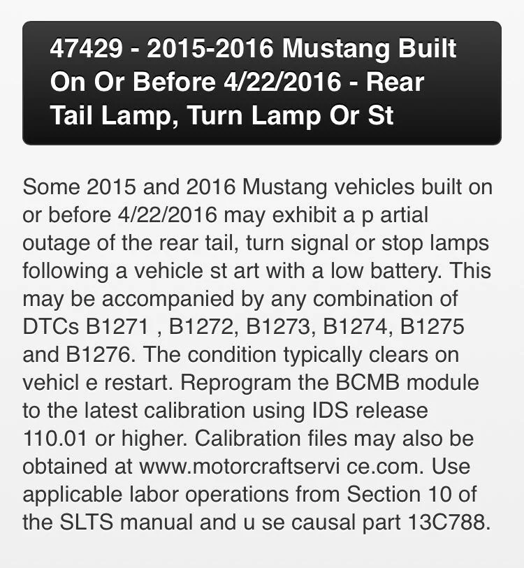

The Service Dept’s can’t find that original SSM 45895 because it’s been supercded by SSM 47429 (which is the Official Ford SSM I have attached).
Too bad *some* of the Service Dept Techs can’t think OUTSIDE OF THE BOX... because the S550 taillight from 2015-2017 is the same; all they had to do was just go into their Ford site and select another Model Year and Vehicle Make without using a VIN and wa-la...... they would have found it.
Thanks for the info, I had this issue with my 2016 mustang EB with 63,567 miles for the last few months. My rear passenger side light is out but the brake light and turn signal work. This issue been driving me crazy! Its time for a trip to ford 🤪
