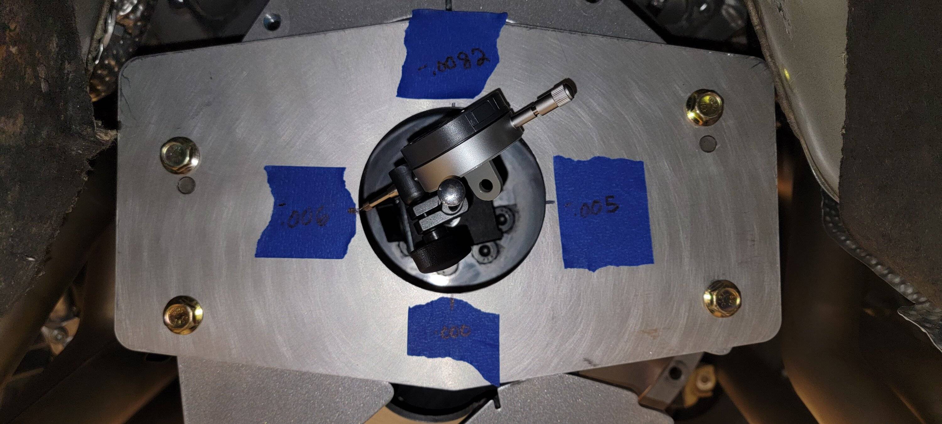

So wait, you didn't index the bell housing?
A friend of mine just had his Magnum installed and JPC (where he bought his) told him it didn't need to be indexed (that they somehow index them against a "standard" block. I found that sketchy. Bowler, Modern Driveline, both great shops that I dealt with for part of my setup highly recommend at the very least checking it for concentricity (preferably for both concentricity AND parallel).
I didn't end up needing any offsets, but I know a bunch of people that do. Maybe these shops CAN check it against a block before sending it out, my question is, what do they do when it doesn't run out within tolerance? Without offset dowels, how do they make the necessary adjustment to center the input shaft/trans onto the bellhousing (which is dictated by the fasteners on the block).
Whether it's horror stories and exaggeration, every reputable shop claims that bad concentricity will result in everything from excessively and prematurely worn out pilot bearings to poor shift performance at high rpm. I'm not sure that bad runout is causing your NVH, but if you are pulling the trans again, I'd take the time to check the centering.

I did not index my bellhousing either. The tremec manual even says if you have your stock factory block in the car, no need to do it. In hindsight, I wish I would have. Would the shift quality improve, maybe? If this trans ever has to come out again, I will do it then.

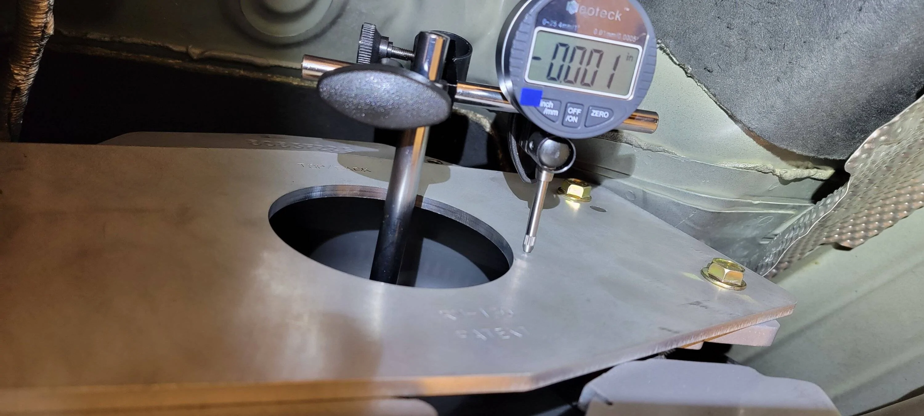

I finally had time today to remove my T56 XL, the clutch and the bell housing. After reinstalling the bell housing, I checked bell housing parallelism and I'm reading anywhere from .001 to .005 which is within specs. When indexing the bell housing I'm reading - .006 on left marking and - .005 on my right marking which is well within specs from side to side. My bottom mark or starting point is 0. My top mark is reading -.0082 so when I divide that by 2 that gives me .0041 so I'm within the .005 tolerance so I do not need offset dowel pins correct? I used 2 different dial indicators and had a friend turn the engine over multiple times so I could confirm the same readings over and over again.
