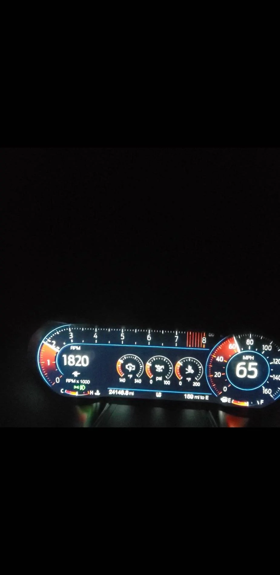

so I have a 2018 GT premium with the digital dash. I've seen people with digital dash have an actual analog readout of the different guages vs. the animation I have on mine. Is there a way to update my animation to the analog readout? Pictures for reference....the first picture is what I have....an animation...I would prefer the more accurate numerical readout. Any thoughts? Has anyone else had this issue and got it resolved?

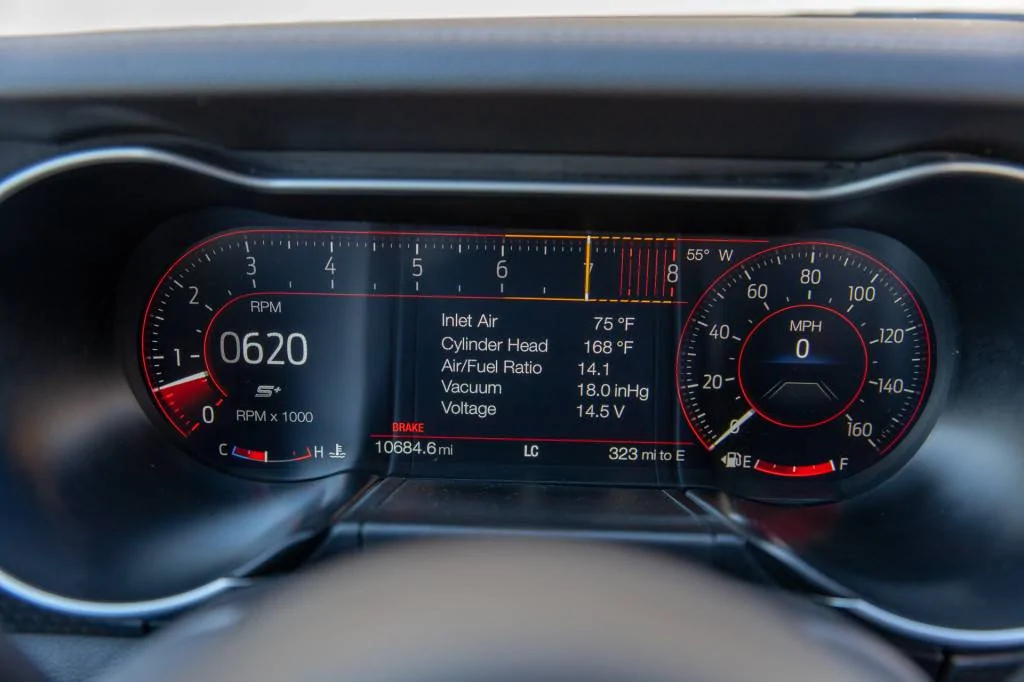

Press the down arrow on the right side buttons to cycle the screen. It'll show analog.

It doesn't....it cycles through each set of animations, than the g meter, than a blank screen, than back to the 1st set of 3 animations

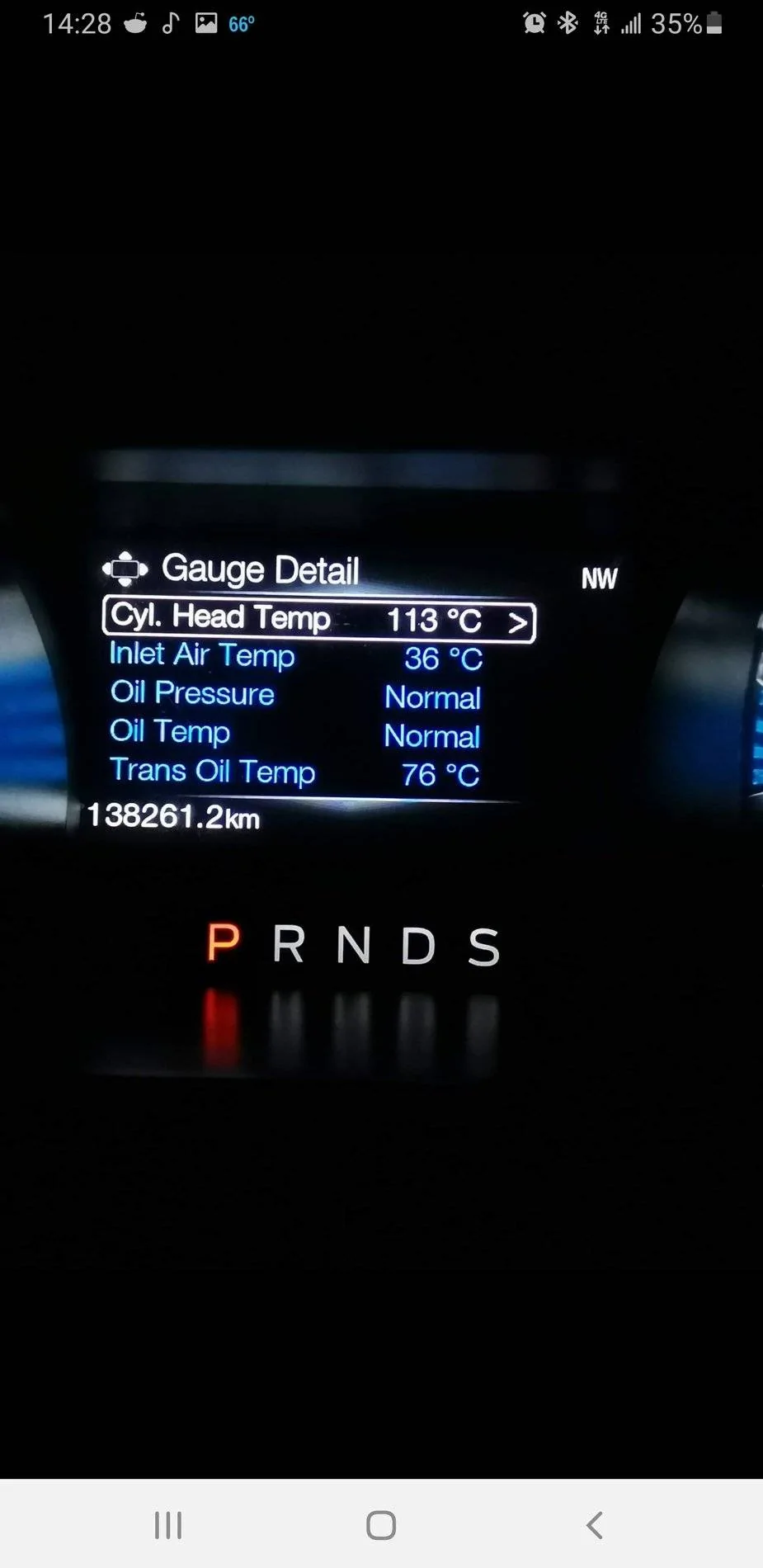

Third is what it should look like
If it's under warranty take it back. It should be there. I'm gonna guess the blank screen is where that analog screen should be. Unplug your battery for 30 minutes or so. It might need a reset.

Do you have the “show gauges” option selected in the pony menu?
