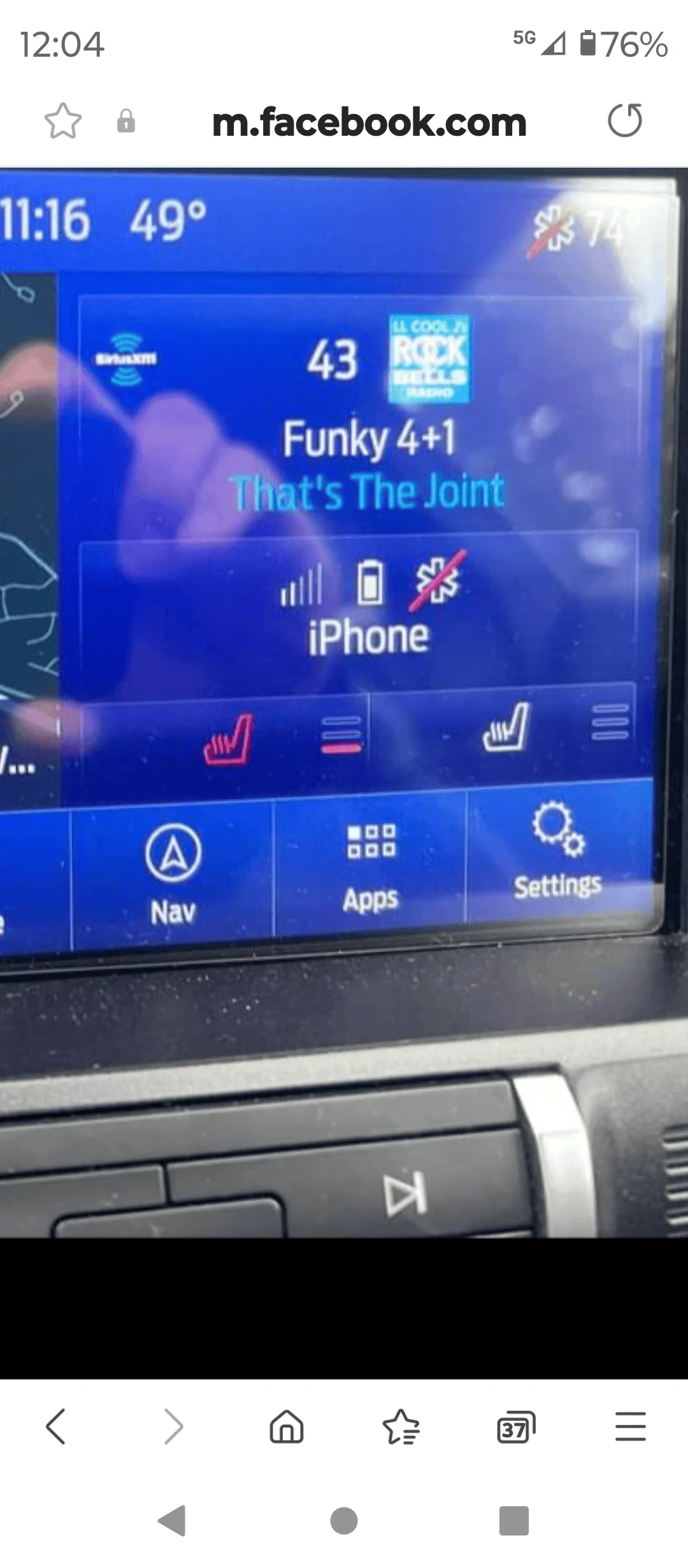

With the latest update are you now able to adjust heated seats as in this picture?
I seem to recall this was an issue that could be resolved with a switch in Forscan. I do not have these in my 19 And honestly, never bothered to check it out.
That has always been something you could add using Forscan. I have the heated steering wheel 'switch' there, although you can have all three. I'm surprised the update has done that - mine didn't.
This is not a picture of my screen. Someone posted it after the update, guess
they had used forscan. I initially thought it was part of the update.

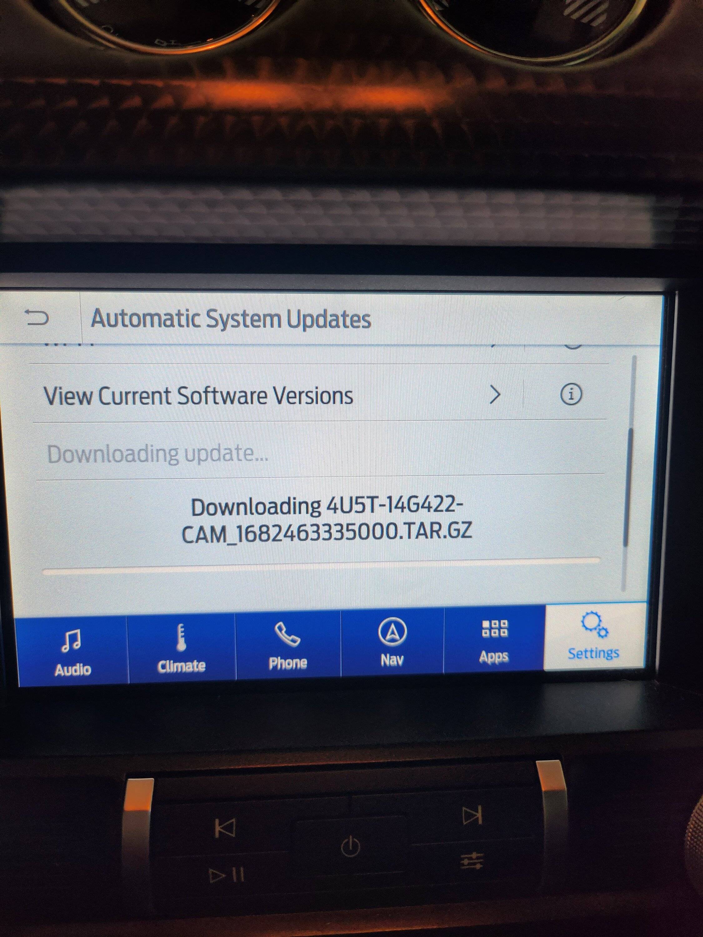

I installed Build 23188 from USB and it was successful. I looked on the Ford website and they still show me as 21194. It has been 4 days. When connected to wifi and I check for updates it said there was an update and started installing. Should I stop it? And how do I get Ford updated?
n
I updated mine with a usb, it took about 5 minutes and then checked for update using wi-fi and ford was informed.
When I check for update by wifi, it starts downloading. I need to know if I should let it do it. The Ford website has not updated even though the car has.
have you turned off the car, locked it. Make sure it is off. Then you can get back in and start the car again, this is to complete the update. Now check the update.

have you turned off the car, locked it. Make sure it is off. Then you can get back ina nd start the car again, this is to complete the update. Now check the update.
The car updated, it's Ford that thinks it has not.
