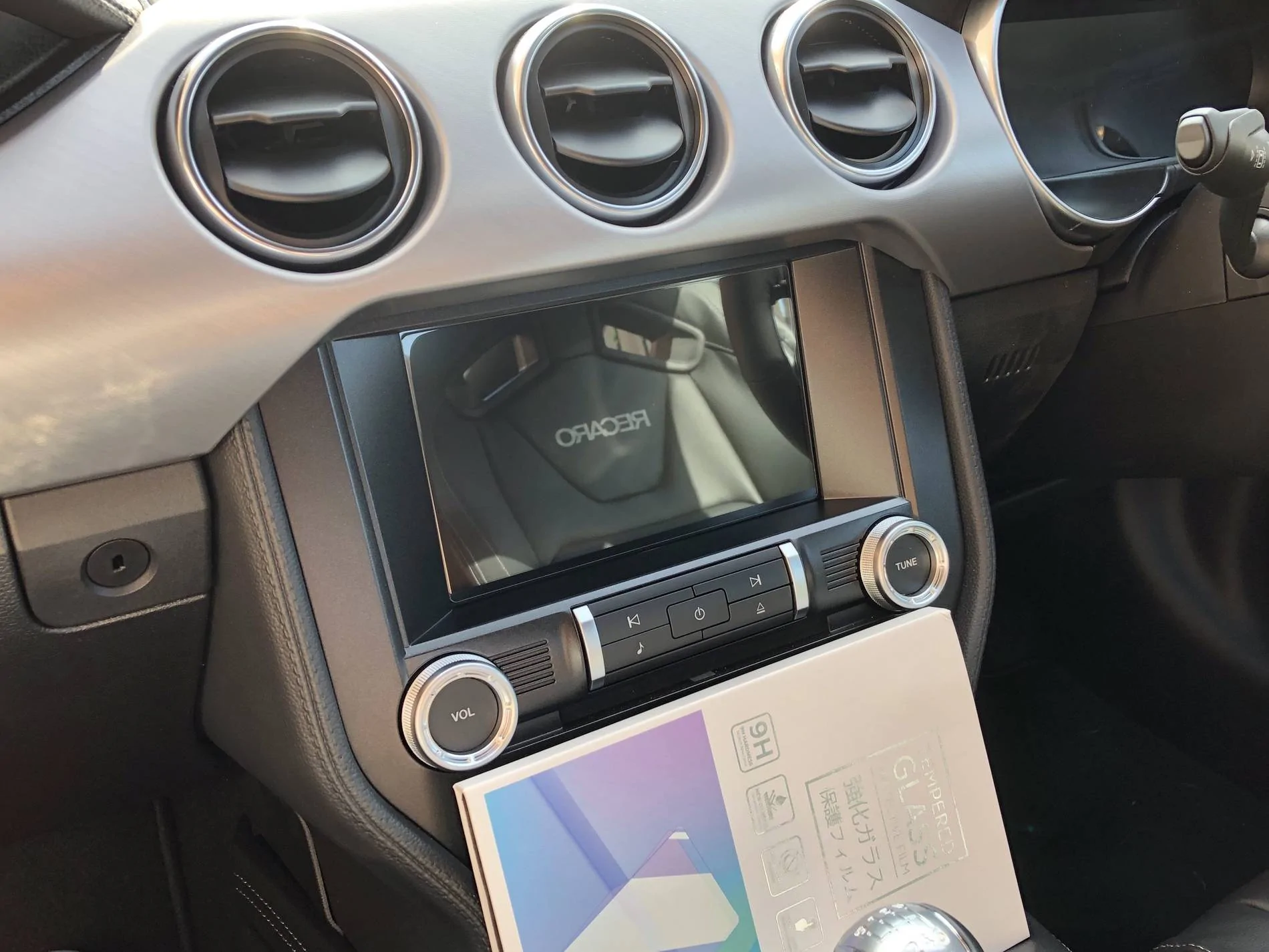

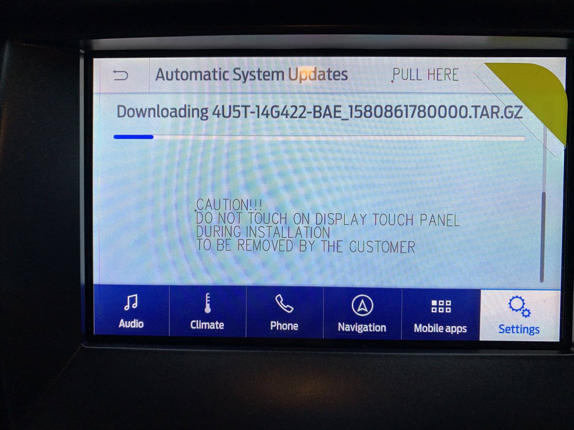

This is what my screen says right now.. is this 21020
Yes, I know I have the cover on still.. I'm sad like that..

@Gloucesternige - I didn’t remove my screen protector until I got one of the glass ones :like:
Probably - it is certainly doing an update so after it has finished look in the general settings to see what version you have.

Yeah, it is saying I am up to date as of 27/3/2021 and it is version 21036.
The update is now “installing”
