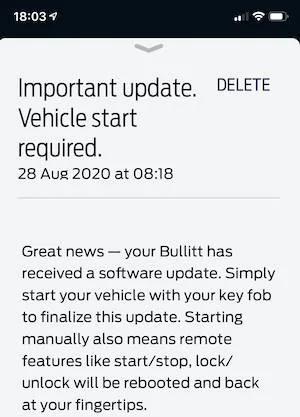

My car was 3.4 went I collected from the dealer last week - but there was an over-the-air update last night. I presume a later build version of 3.4.....
Really ?
Even the basic sync update is 2Gb which will take ages to download over the in car WiFi which is only wireless g.
The car will not update itself, especially not when it is off overnight !

Yep - On the Ford Pass App on my phone (28th Aug 2020) :
IMPORTANT UPDATE. VEHICLE START REQUIRED
Great News - your Bullitt has received a software update. Simple start your vehicle with your key fob to finalize this update. Starting manually also means remote features like start/stop, lonk/unlock will be rebooted and back at your finger tips.

...... The car will not update itself, especially not when it is off overnight !
Not 100% correct. Vehicles equipped with 4G modems(Hotspot) will update when off overnight. The modem has a constant power source. Updates will download over time and will install when all files have been received. On the flip side, Reports about vehicle stats will upload to big brother (Ford) the same way.
Ahh I missed out on that as I'm only a 2019 car and we didn't get the onboard modem
