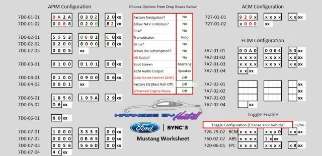

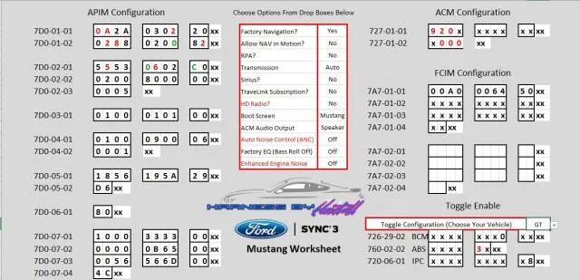

I linked the instructions as best we currently have them, if you don't want to follow them I'm not going to break it down. It's been broken down ad nauseam.[/QU
@o7low Greg, your a harness customer.. you get that Info in a spreadsheet as part of your purchase. It’s still in beta form but will help you. pM me, I’ll ask a few questions and reply with the exact data.
PM sent ty sir

Yes, sort of. The as built you access with FORScan will usually tell.
Ok cool. Thanks.
I was reading earlier that you will eventually sell the harness and stuff on ebay. Do you have a time table for it? I'm looking to buy. I'm just doing the basic swap, no gps/hd radio.

Buying them on Ebay will not be discounted. Better to PM for the special 6g pricing

Are those sheets for me? Looks like my setup will be similar to jperls. I'm assuming that these are the FORScan values? I've never used FORScan.

No, the sheets are just for general info. I include them with my harness as well as a Power Point detailing the install. But I post them here for folks who are doing it on their own without my tech support.
