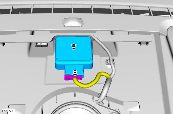

One question I do have is what is the harness used for that is labeled MSCAN?

I understand that but where does it plug in at or does it?
It plugs into the connector that was previously used for GPS. You have to remove the GPS module on the top of your dash. Sync 3 uses an external GPS antenna, even if you aren't using NAV the car needs the external sensor. The vehicles telematics are reliant upon that signal.
This is an excerpt from the new instruction manual I'm working on:

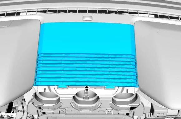

21. Remove trim piece on center top of dash
22. Unplug GPS Module (GPSM.) Carefully remove metal plate from bottom of module with a wide flat blade screwdriver, panel tool or gasket scraper. Use a suitable adhesive such as double sided foam tape or similar and install the aftermarket GPS antenna onto the factory bracket. Re-install the factory bracket with aftermarket GPS antenna and plug the connector labeled MS-CAN into the now unused GPSM connector.
