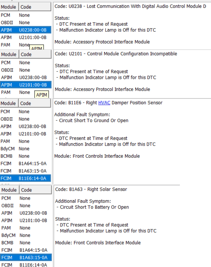

I upgraded to a Sync 3, Everything works well so far, even the phone connects and all audio is playing via the speakers, Drive toggles, Hazard toggles all are working as intended.
Except, What bothers me are the following error codes (I read that HVAC, Solar errors can be ignored, which is fine). However I still keep getting an Audio error which I'm not sure for why or for what reason.
Furthermore, My theme is somewhat a mix of Grey and Blue which is hardly readable. If there is a way to make the letters black, or some other theme selection, That would be insanely great!
The following are my current errors, Which keeps appearing even after clearing DTC.

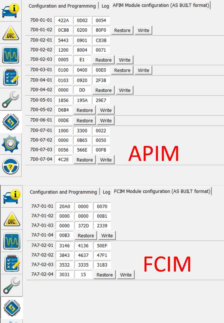

To further clarify, These are my current AS-Built in FCIM and APIM;
Thank you for your time, and any help is much appreciated guys!

Don't worry about the ACM DTC. I have it too and I believe it is a fault created when I change codes because it is easily cleared. Even so, the presence doesn't seem to effect functionality.
As far as your theme colors, I notice some of your APIM codes are GT350R theme, but that should not cause your screen to display odd colors. Have you looked at the known good codes in the spreadsheet links? Does your boot up screen show the correct colors? Your settings should show a red background with the snake if I interpret your setting correctly. Do you have any of the Police blackout settings enabled?
If all else fails, you may have a bad display unit. Can you attach a picture of the screen once it is fully booted?
Another thing to try is to find the as-built codes for a Mustang similar to what you have with the 8" screen and compare the settings.
Good luck.
