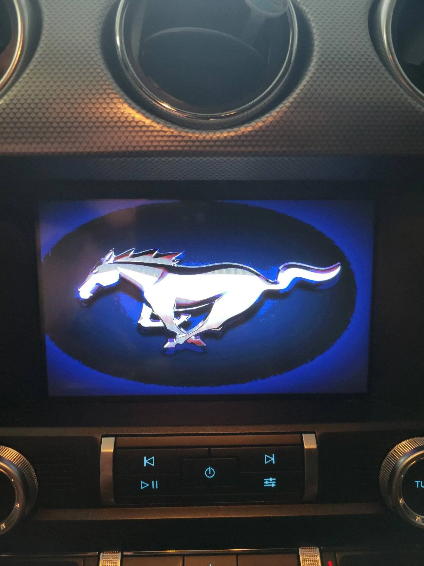

So i just finished the install everything went smooth. 2019 gt went from 4 to 8 inch and the screen itself isnt crisp so to speak and none of the backgrounds look normal and color is almost off. Backup camera is super blurry also... anyone ran into this before?
Do you have a pic of the APIM engineering number?

Its all in my car. Will have to pull it apart tommorow. Any idea what could be going on?

Everything works. All the buttons work. Updated to 3.4 it opens up fine and no issues... just awkward screen especially in android auto
Can you post images of what your screen looks like for us to see?
Is the distorted screen image due to an incorrect APIM?

Well, I reached out to Sam @ hellhorse yesterday and showed him pictures, and he said he will send me out an APIM and screen to swap over. I work for FedEx, and was able to verify in our systems the same day we spoke it was dropped at fedex. We will see, but no complaints on that service.
