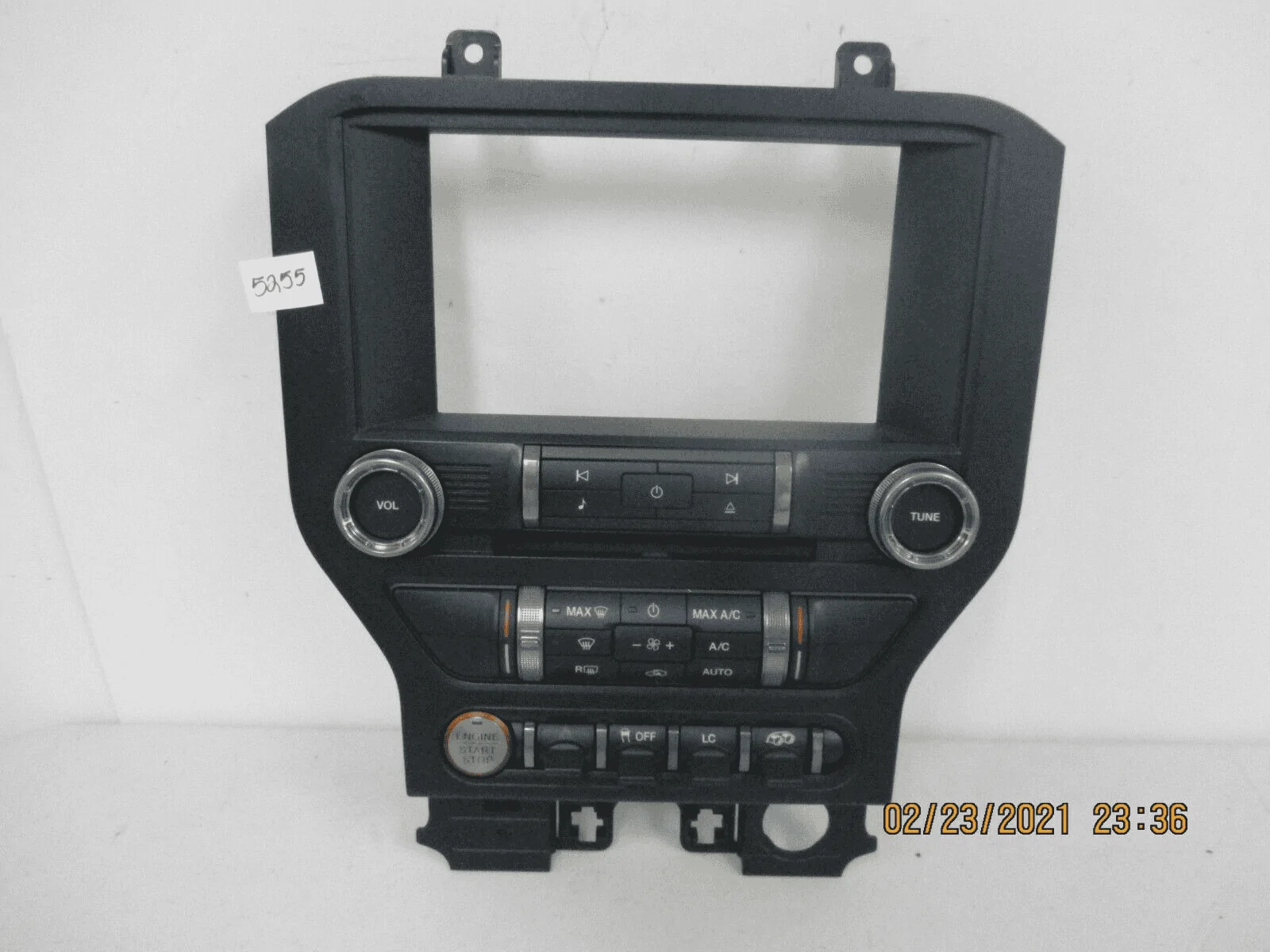

I have the GT350 console control panel and the switches look to be a similar material as the rest of the buttons on the panel; not chrome at all. Here's a picture of the original eBay listing. The only thing is, the labels are for the GT350 so instead of my normal switches, I have one labeled LC (launch control) and one for active exhaust.

Don’t use GT350 bezels on EB, V6 or GT. The trim colors don’t match (they aren’t silver, they’re bronze) and the firmware is different.
The trim on mined does match and is working fine, except for the toggle for LC and exhaust mode. I am still trying to get them to work with the normal EcoBoost settings, but everything else works perfectly.

Look at it closer... it’s bronze. It should be silver/chrome.
The different firmware is related to those switches. They don’t send the same information on the CAN bus.
