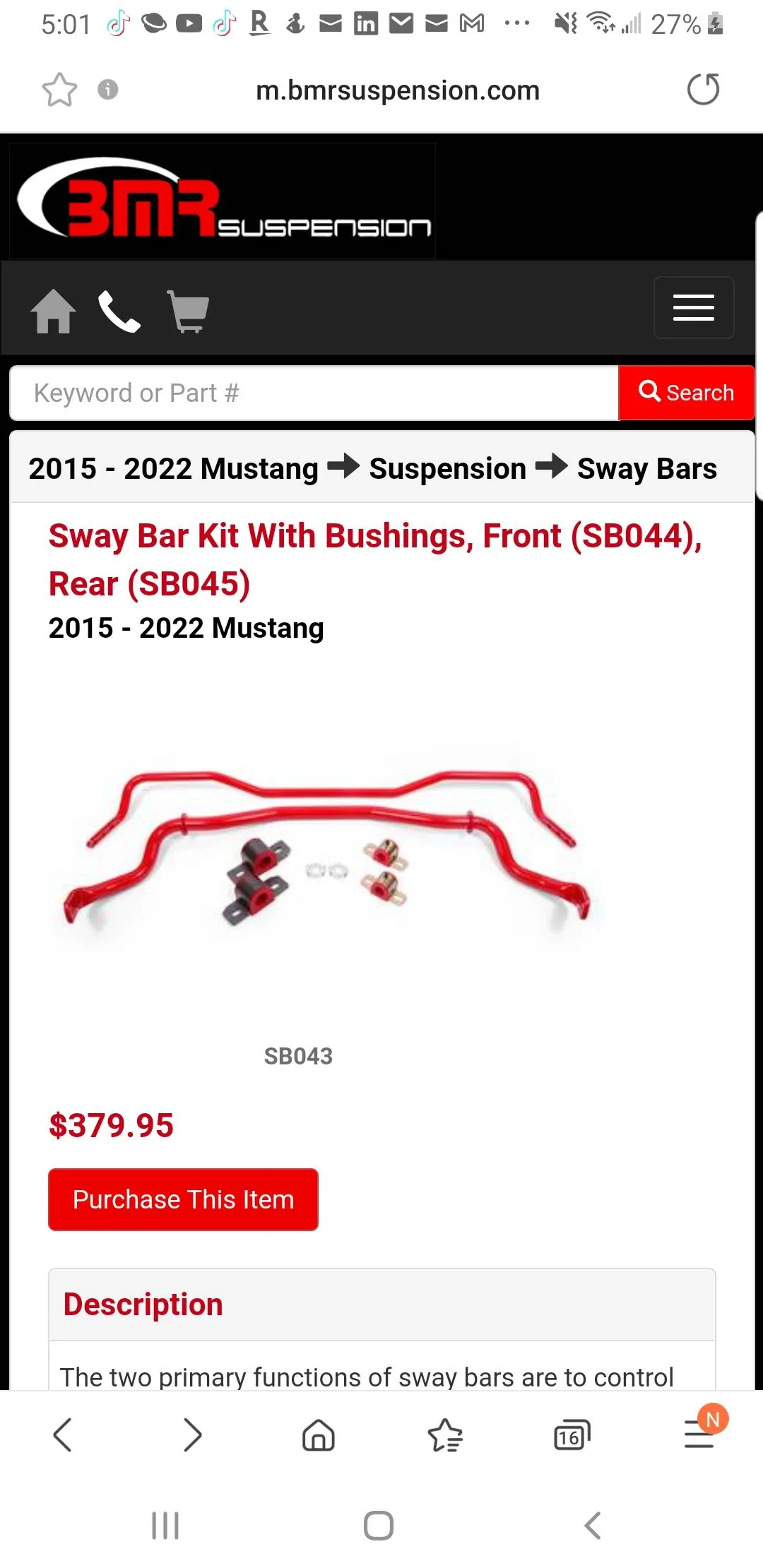

What do you think about the BMR sway bars?? SB043
Thanks Anthoiny

The Eibach front bar was a great upgrade on mine set to medium. I also have a non-PP GT (Premium) and I'd think the BMR set to medium would be a good upgrade for you. Very noticable "snappy" nature on turn in now and less body roll. Car can push a little on low-grip surfaces, but that's not a deal breaker.
Im thinking about getting the BMRs, which setting is medium on those bars??
Thanks Anthony
