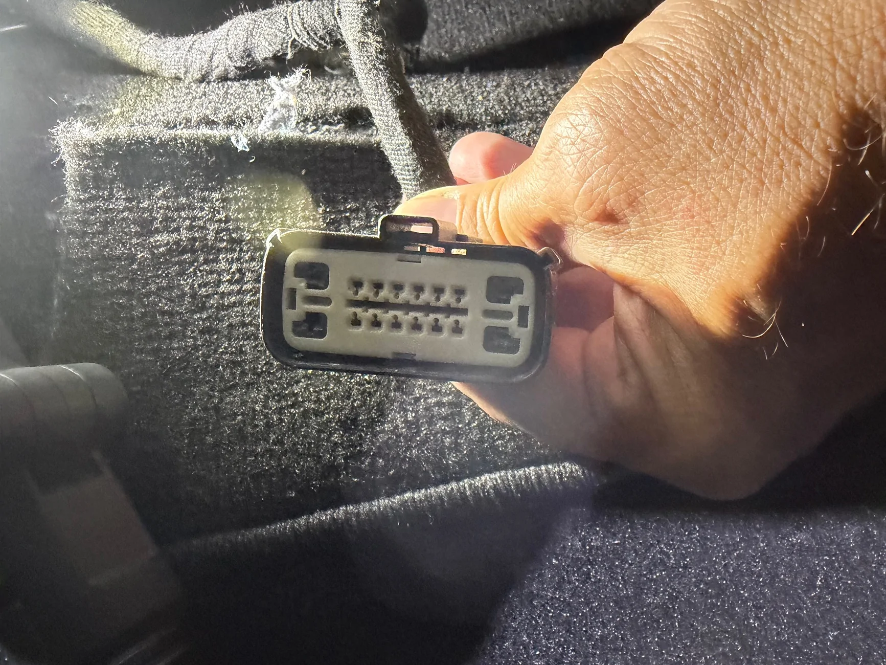

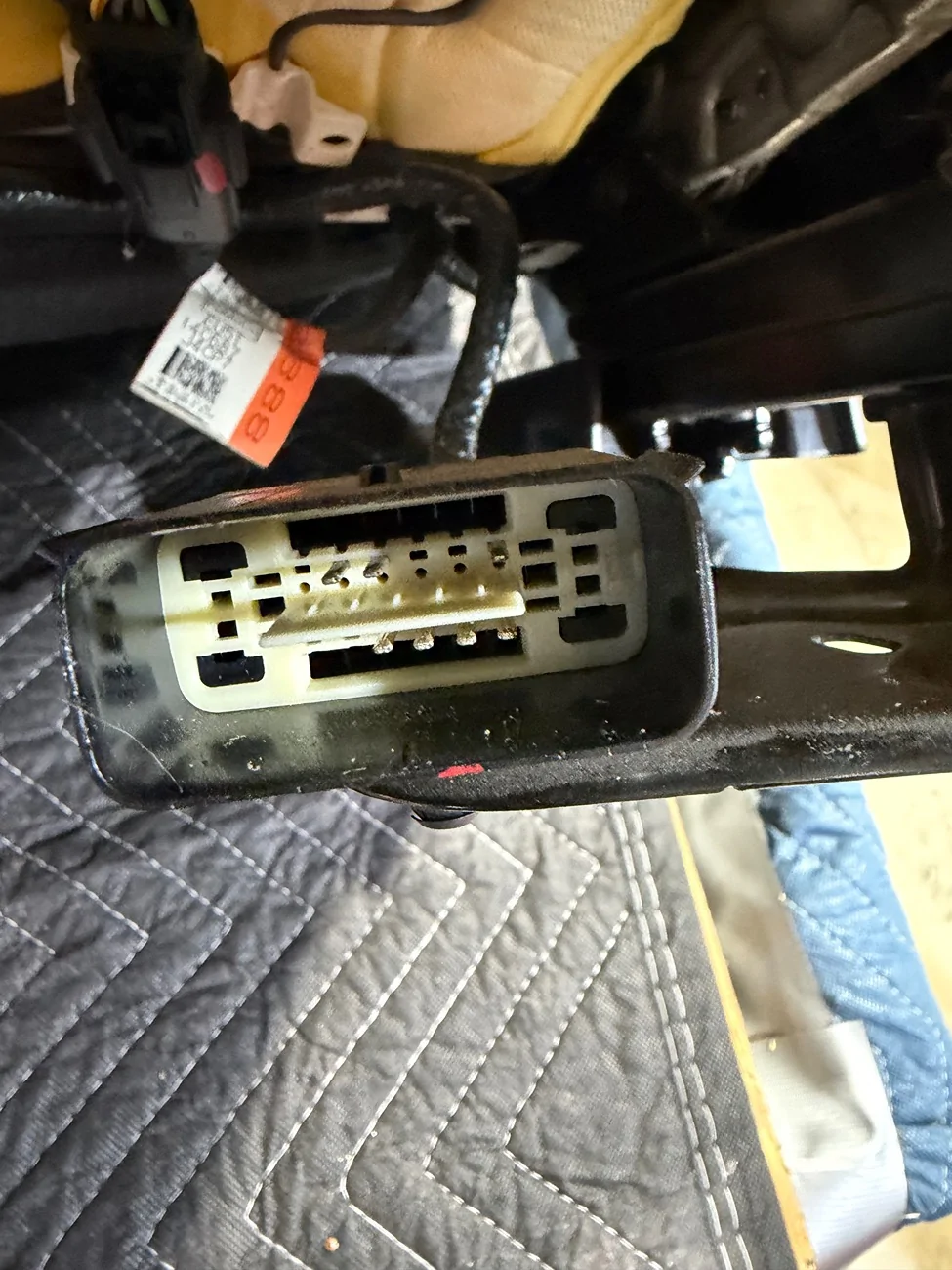

I just checked one my 2015s to confirm the plugs.
first image is the plug from under my recaro seat.
second image is the wire connection for the power seat and air bag harness on a 2015 GT
there of course is a second connection for the heat and ac
if you need more info I will pull my 2017 base model car out where I can open the door and get a picture from the base car.
again all GT’s from the factory have power seats driver and passenger As standard regardless of the recaro option so the harness should operate a standard power seats from a base car.
