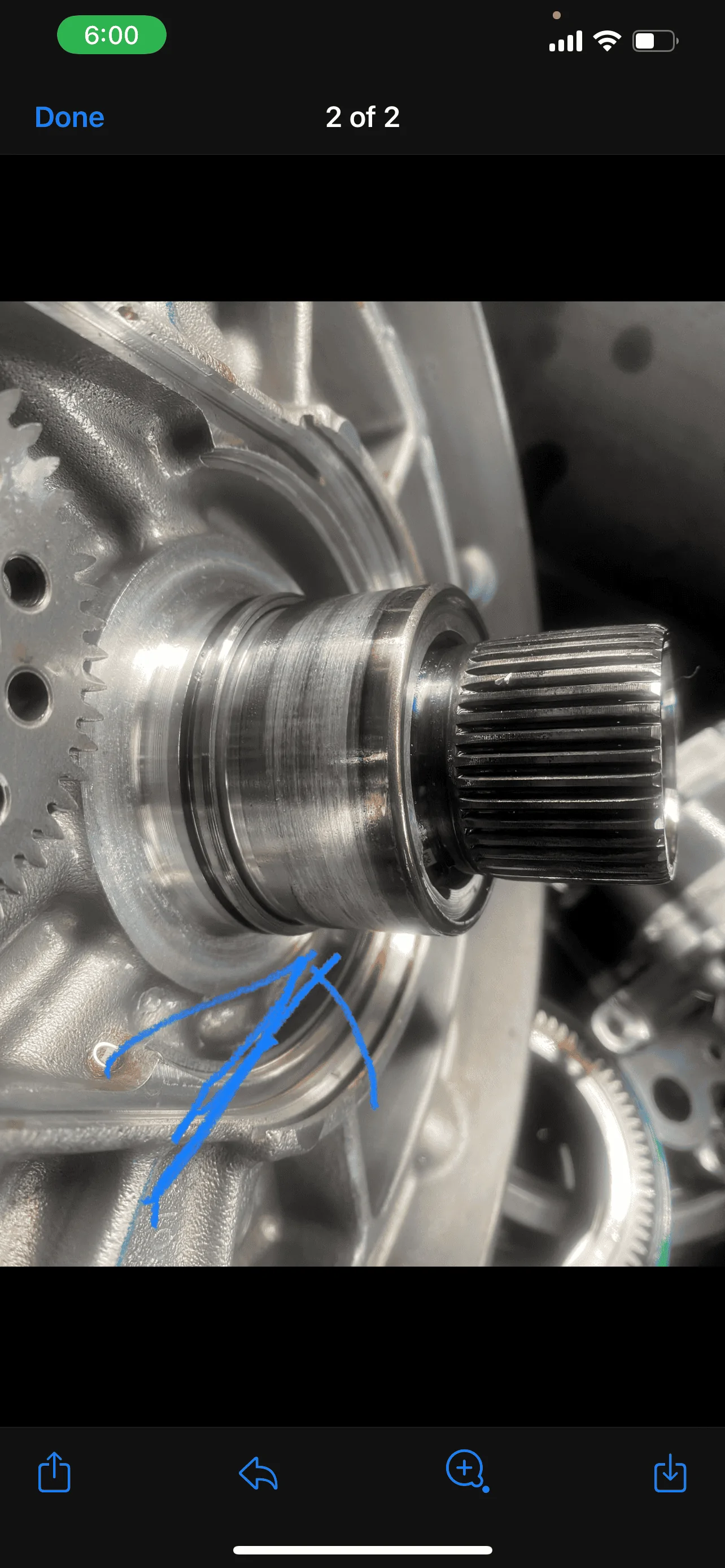

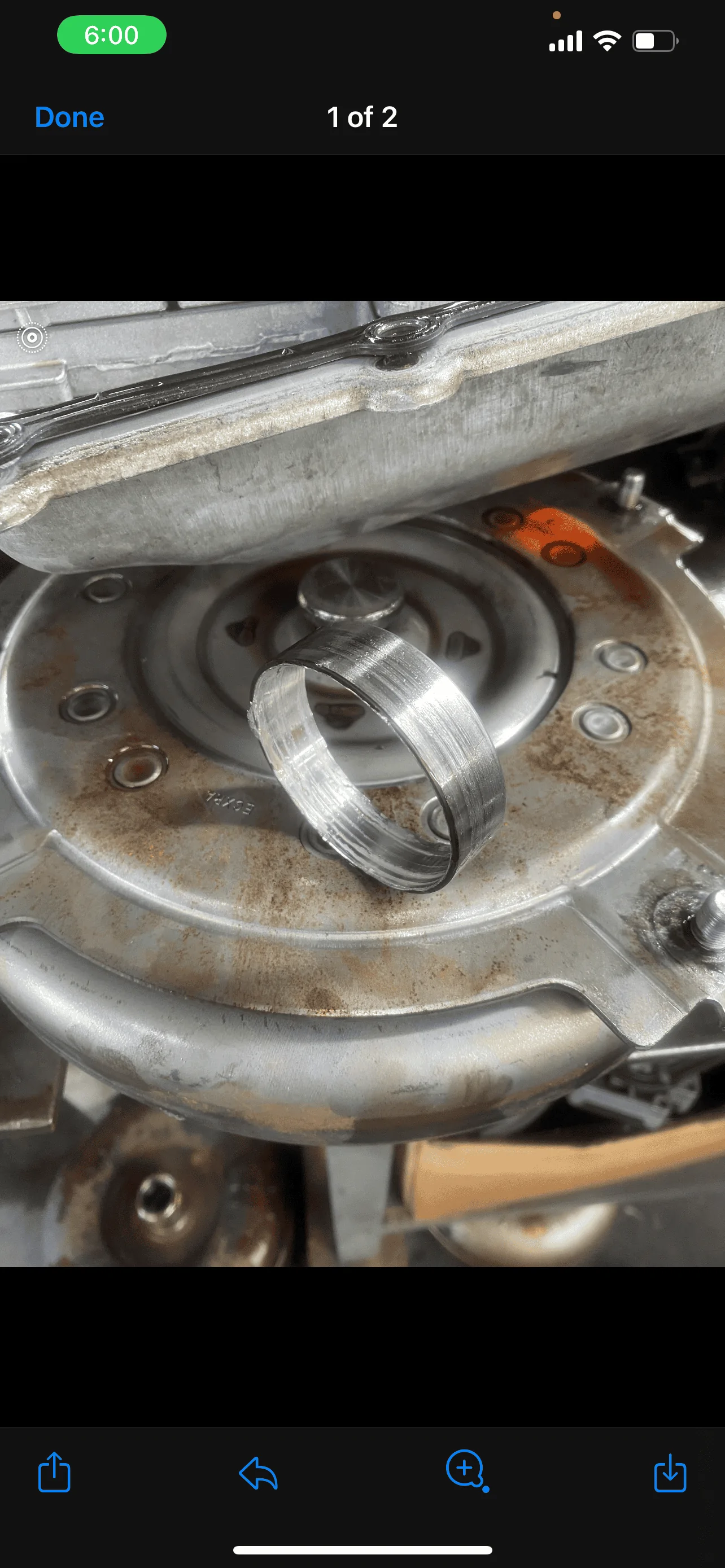

I just had my 10r80 pulled to do a suncoast stage 2 and a circle D converter. Only issue I had was 4 to 5 felt like it was slipping. The shop found the bearing for the front pump damaged.
