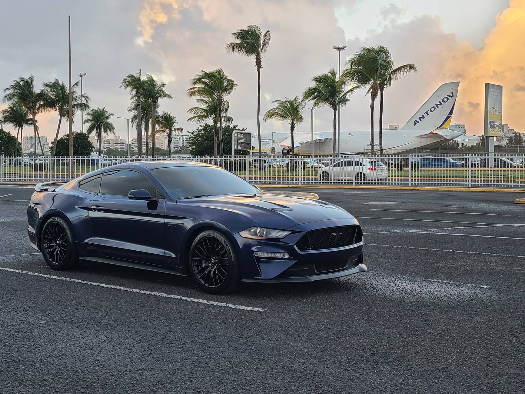

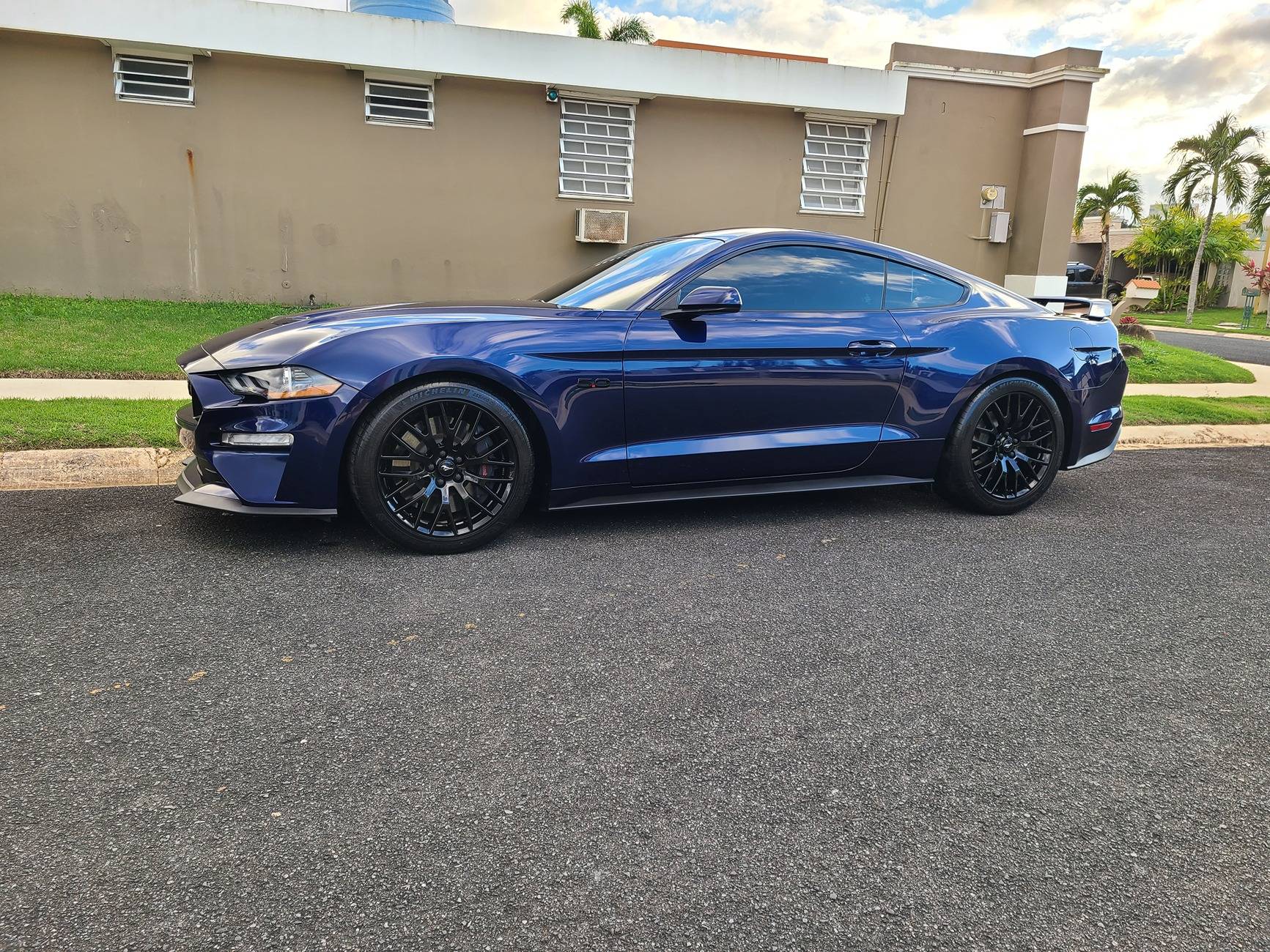

I went with Steeda and couldnt be happier. Quality parts and customer service from @tj@steeda and the team is excellent.
I went with Steeda Pro-Active Shocks/struts, Minimum Springs, Alignment Kit, IRS Bushing, Subframe Braces, Rear Shock Mounts, Vertical Links.
You want to address the IRS first. Then the struts/springs. If you can do it all at once, great. No need to use camber plates for the minimum springs but I installed J&M because why not.
I live in PR so the streets here are worse than in NY but I have zero complaints running that setup.
Shoot TJ a dm and he will come with a setup for your needs.
