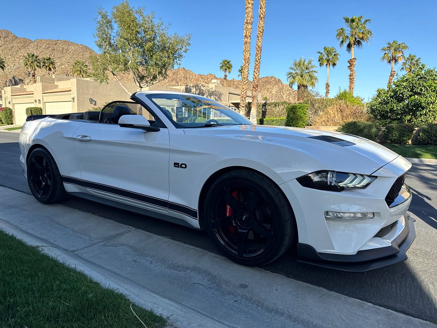

My roads are hit & miss here. They’ve been re-paving some of the main roads around me which is great. I have Steeda min drop springs in my convertible with stock dampers & 19” lighter rims wrapped in meats. Car drives awesome compared to stock. The .75” drop really kills the wheel gap too👍🏼
