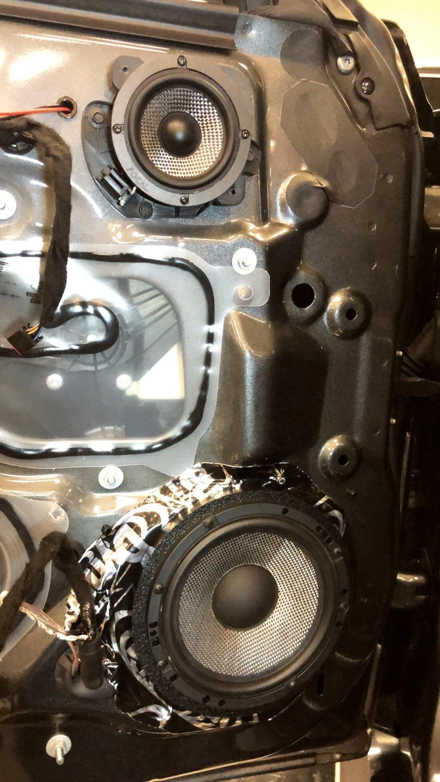

Audio upgrade complete... My wallet is lighter but my system sounds amazing!
Focal 3 Way 165AS3 in front
Focal 6.5" weather proof woofers in the rear (don't recall model #)
JL Audio VX6006I 6 channel amp for front 3 ways
JL Audio 2 channel amp for rear woofers
Ended up having to leave the center speaker connected otherwise I lost navigation audio, Bluetooth phone audio, and back up sensor beeps...
Installer spent several hours tuning it using music from my Spotify playlists, and then tuned some more after my initial demo impression. Initial treble was too much for my taste so that was tuned down, mid-range is spot on for my taste, and the bass is perfect... No big boom, but it hits just enough and when it should. Now if it would stop raining I can log some top down time to see how it performs...

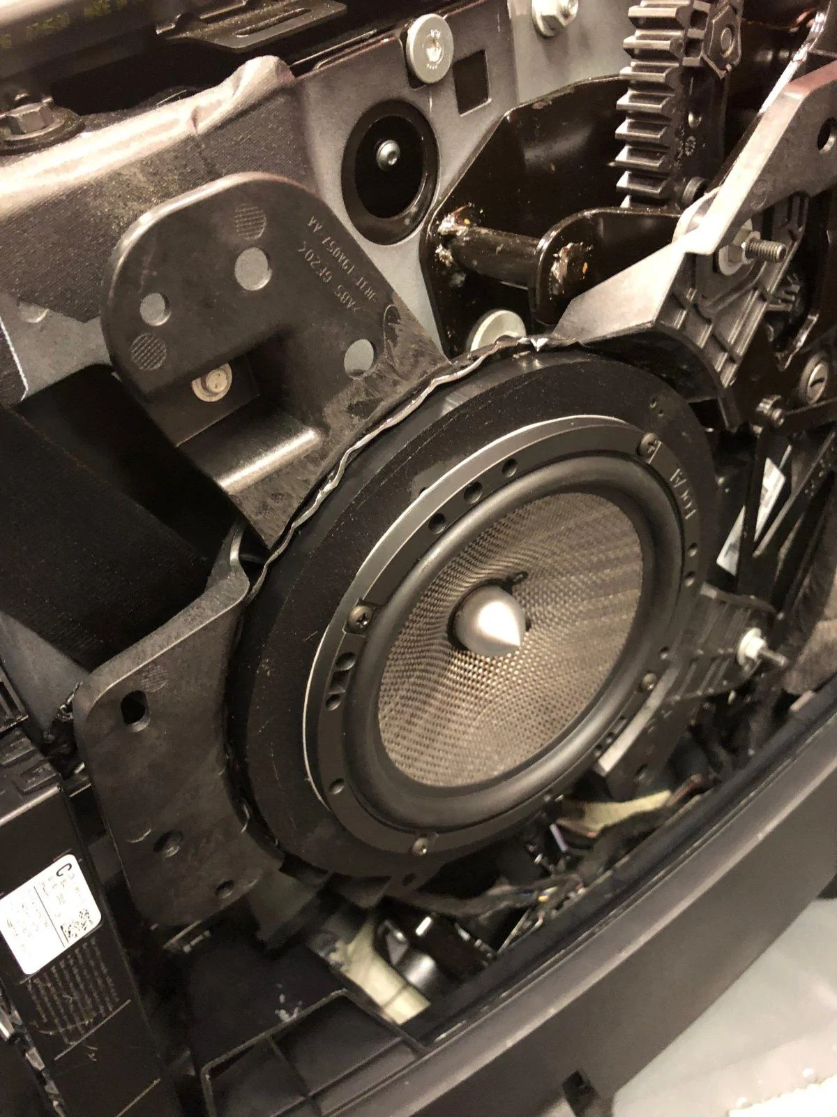

I had it all installed at a local Cartoys. They have done some work for me in the past and did a clean nice install. So $3,500 total... That is speakers, amps, supplies, custom built ABS mounts for each speaker, all new wiring, and of course labor. It was honestly more than I anticipated and/or planned for... But to get what I wanted it grew to this.
They were fair on the components and supplies... I priced them all out online and they were right in line with what I could have bought them for on my own.
Attached a couple of pics of the front and rear speakers during install.

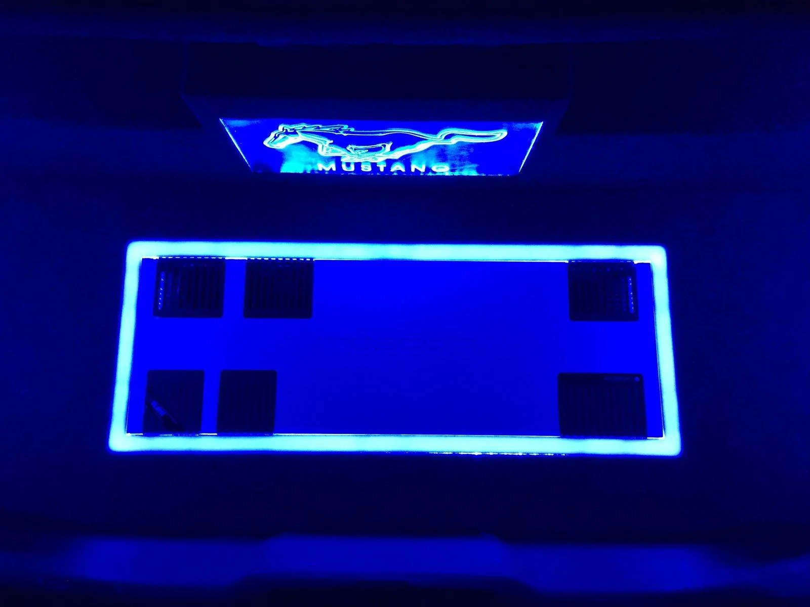

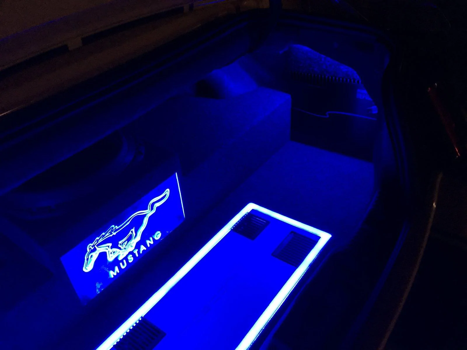

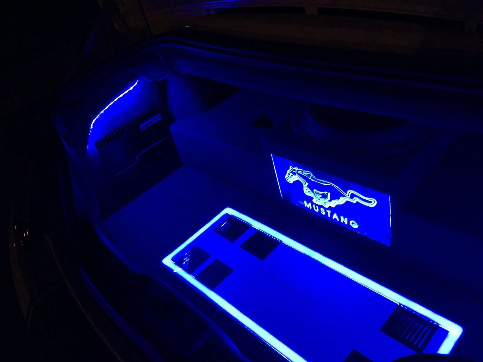

I have upgraded my stereo nearly 2.5 years ago. I'm loving every minute of music I play on it now. I have plenty of base, mid range and highs even at high speeds on the highway with the top down. :)
The components I have are...
Audio Control Epicenter 1200 (for the sub)
Mosconi AS200.4 (Powering the Woofer and mid ranges in the front stage)
Audio Control D-4.800 (for the rear speakers as well as the front tweeters)
Audio Control DM-810 DSP
Focal Elite K2 ES 165 KX3 3 Ways for the front stage.
Focal AS165 two-way speakers for the rear channel.
Orion XTRPRO 12" Sub in a custom enclosure (firing upwards)

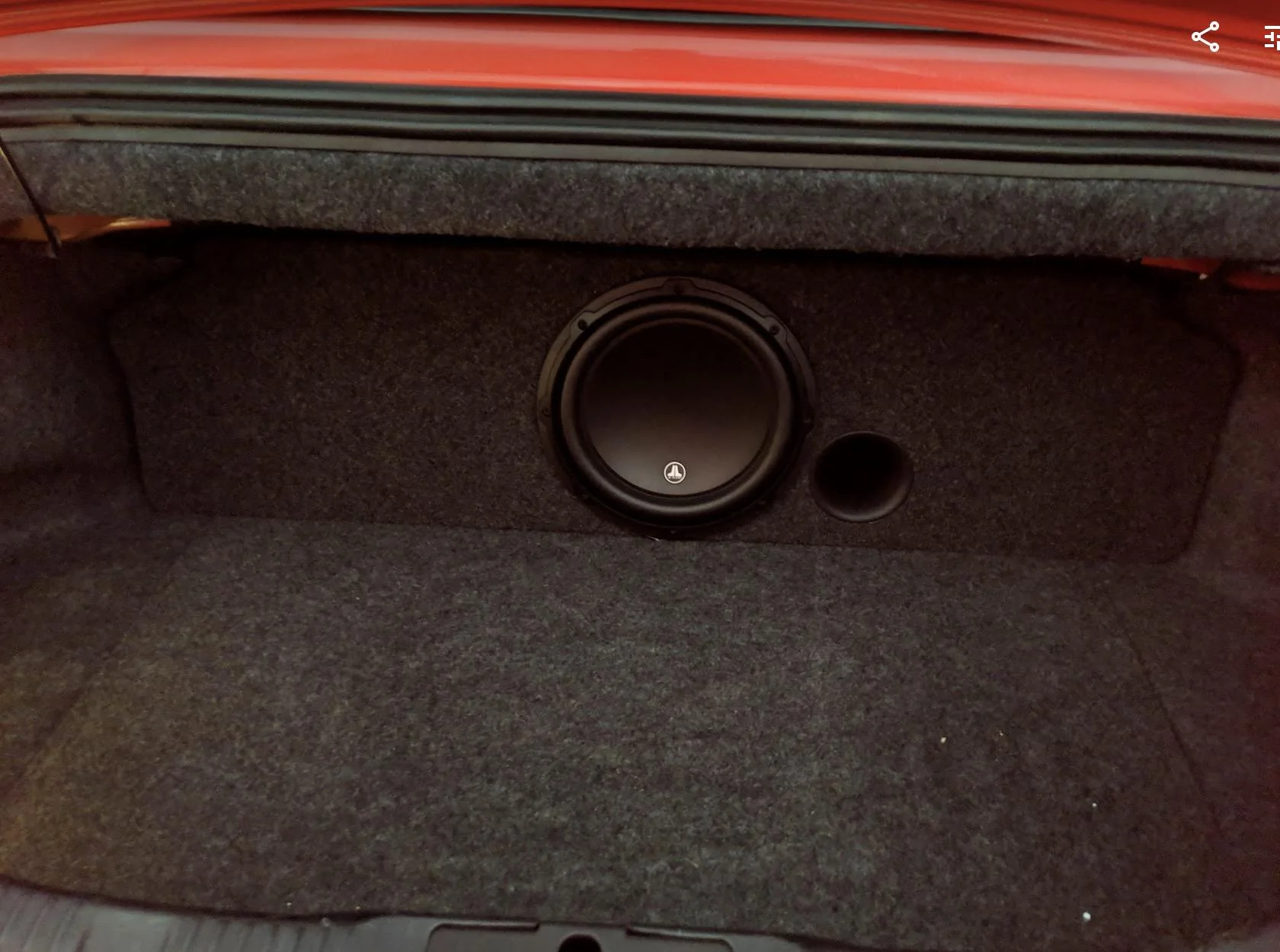

Info on the sub box? Custom? Where from? Cost? What sub is that? Signal from?
Thanks
bullcity
May 5, 2019
Durham
2015 ecoboost
Thanks
Subwoofer box:
https://www.ebay.com/itm/2015-Musta...895369?hash=item3d46ec4909:g:6DEAAOSwPCVX6cl7
Subwoofer:
https://www.amazon.com/gp/product/B00161382E/ref=ppx_yo_dt_b_asin_title_o05_s00?ie=UTF8&psc=1
Amp:
https://www.amazon.com/AudioControl...ntrol+6.1200&qid=1557249457&s=wireless&sr=8-1
I'm using the amp to power JL audio door and rear speakers. There is space on each side of the subwoofer box. One side has a extra battery (Why not?) and the other side has the amp. I've also lined the entire trunk with
Off brand Dynomat
https://www.amazon.com/gp/product/B00URUIKAK/ref=ppx_yo_dt_b_asin_title_o06_s01?ie=UTF8&psc=1
