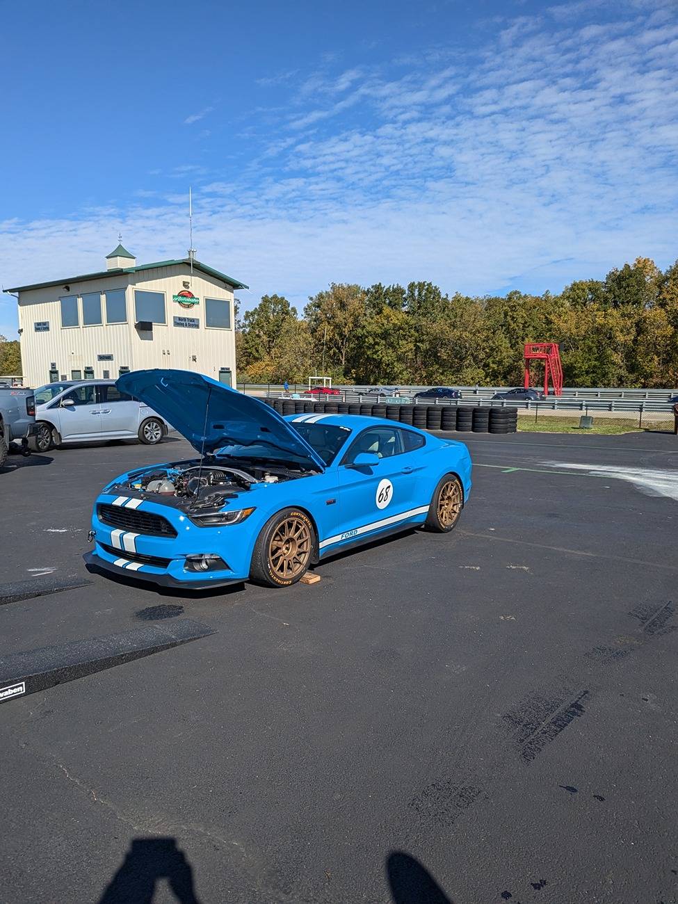

I run stock exhaust manifolds, to help with heat, as I do not need every last ounce of HP. I run a Gibson cat back with stock cats. So far they are working great. I am pretty aggressive on fuel cutoff. Keeps the cats warm with lots of air flowing through.​
The picture is not my car, But I run my oil cooler the same way with a cut out in my belly pan. The cowl does a good job of drafting air up through the engine bay.​

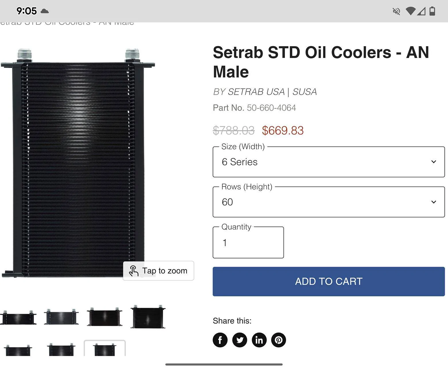

What setrab oil cooler model do you have, do you remember?

It was this series, I need to go figure out this size, it added a quart to my oil capacity, along with my mMR oil pan, I have about 8.5 quarts of oil flying around.
