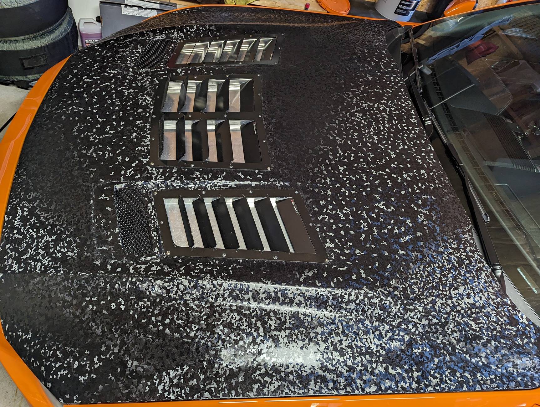

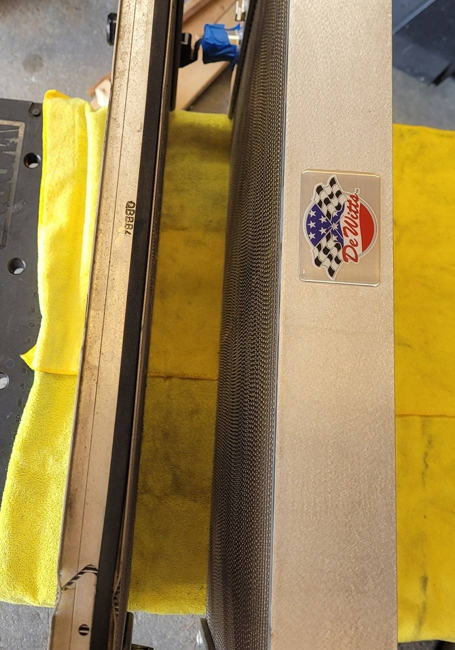

I have fully vented racelouvers hood, radiator that is 2x size vs pp1, fully ducted front, opened up grill, and I still don't take it out if it's more than 70F ambient. I short shift all the time. I have fried both of my cats and if I keep running it, piston rings failure is just a matter of time. The engine is not designed for this, and no amount of highway pulls examples will change that. Yeah, someone did a 150 pull and it went fine, great achievement. Try to do it on an uphill repeatedly from 40mph for 30 minutes with no cool down. Then multiply it by 8 - that's just one day. Multiply by 20 for a year if you're any serious about it.
High speed track with lots of elevation change like WGI is always a heat management struggle instead of learning to drive the car. This power is mostly unusable despite having 305 square tires setup. It may be fine for beginner, but I wouldn't recommend it at all for anyone beyond that.
