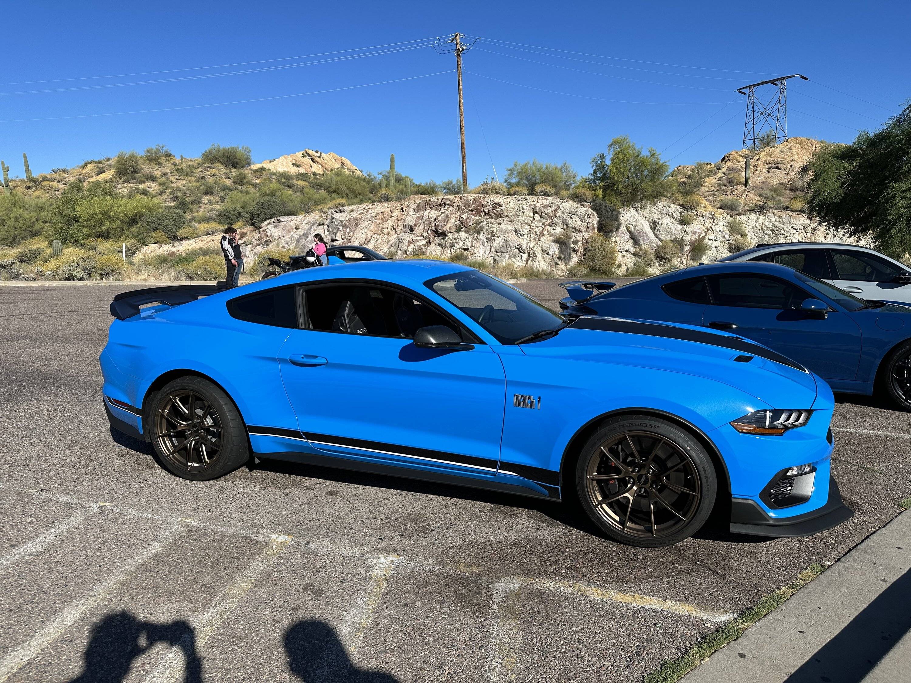

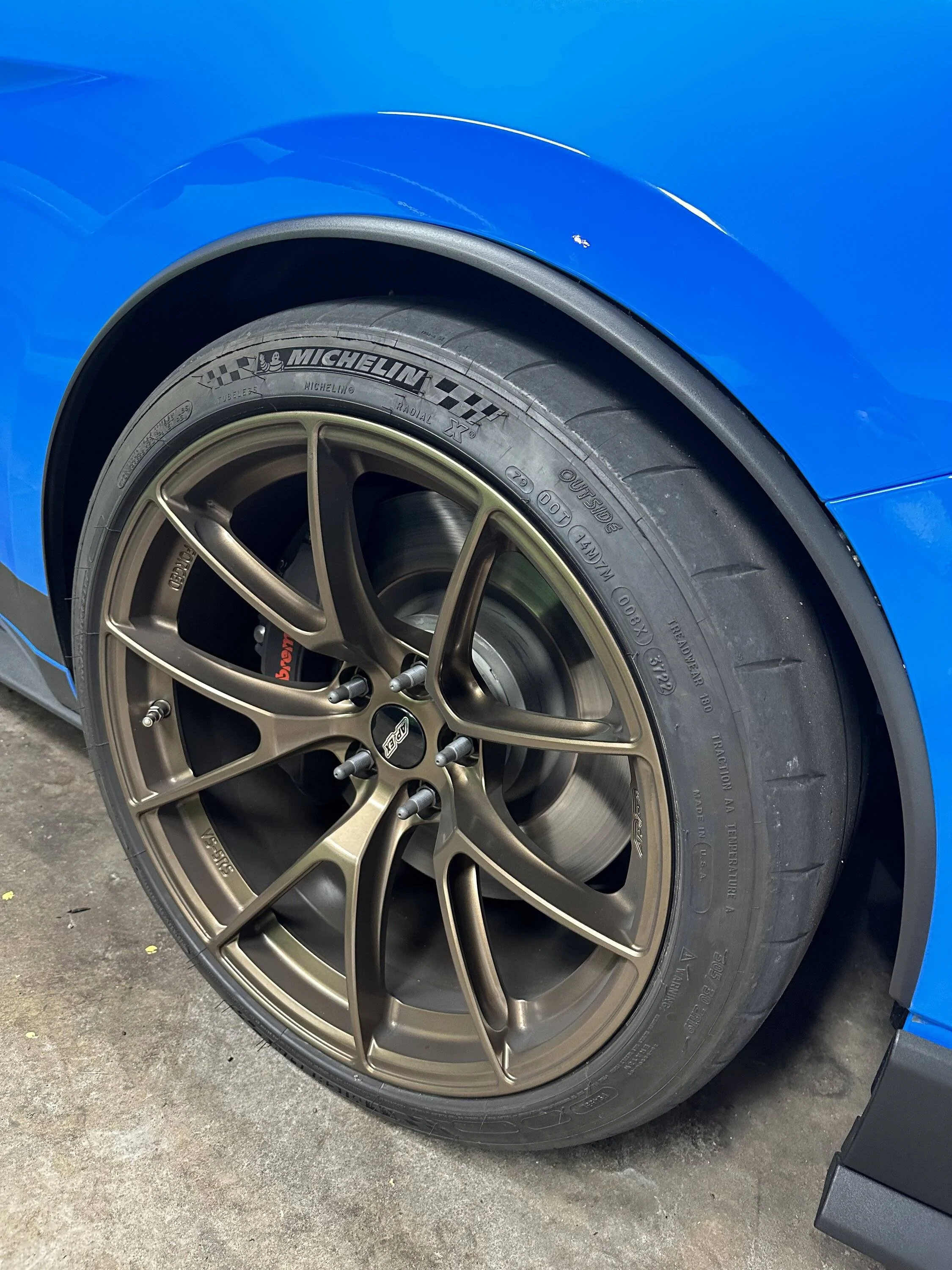

You could have have gone 18x11 or 19x11 ET52 and used a 25mm spacer in the front to run square. That's how I (and others) did it (with my PP2) and confirmed with Cory at Apex for the M1. I currently have EC7's for track and I've thought about getting the 5RS' for my street tires because they look great. However, now that I've seen the HP wheels in person I might keep them. For now I have a set of black PP1 wheels for street but when the tires wear out I plan to put a (trackable) 200TW street tire on the HP wheels sell the PP1 wheels and get another set of something from Apex.
The fitment looks good at least with the different offsets using the same 15mm spacers on all wheels as the EC7s. I liked the look of the HP wheels too, but dropping the mass on each corner really woke the car up. Speaking of... I put on the VS-5RS and took them for a spin yesterday for the first time.
The 305 is stretched on the front, looks like a 315 would work fine there as on the rear.
