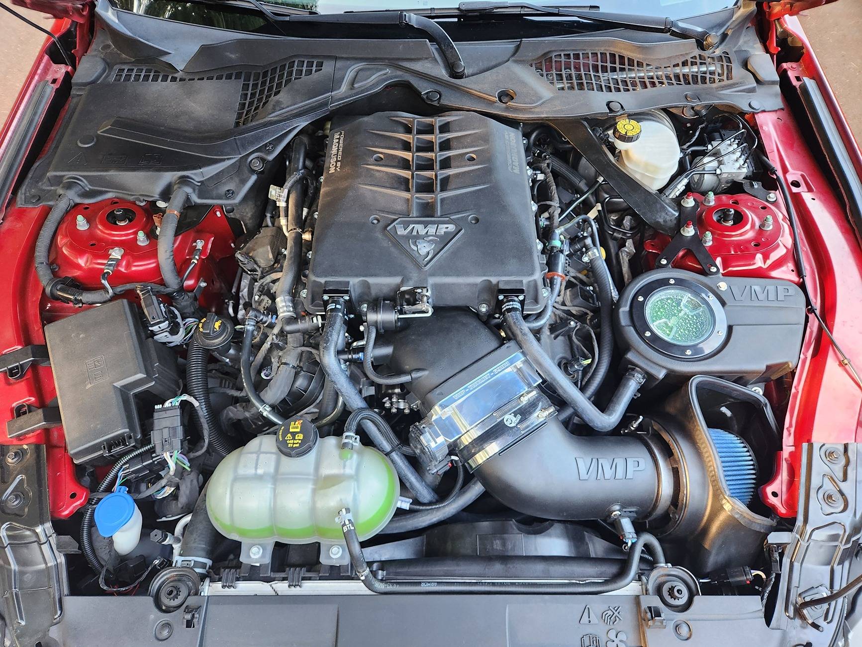

Gt500 is a track car and it comes with a TVS blower. This was one of the main factors I chose the VMP Odin kit. I have yet to install my suspension upgrades but have damn near everything steeda makes for the suspension. Trying to be as close to a gt500 performance wise without spending 80-100k.

The supercharger cooling set up is very robust. I also have PP1 which i believe has additional cooling considerations. I haven't changed the thermostat but I know you can install a 170° to help keep temps down. I'm in the PacNW so I didn't change it.

I haven't had the chance to track it yet. I have all my steeda parts sitting next to the car still. WOT pulls to 150 and sustained 85 mph the cylinder head temps are around 200. I am also running the standard pulley size. VMP says I can run more boost and be a little more aggressive on the timing. I don't need to run it at the edge of safe.
