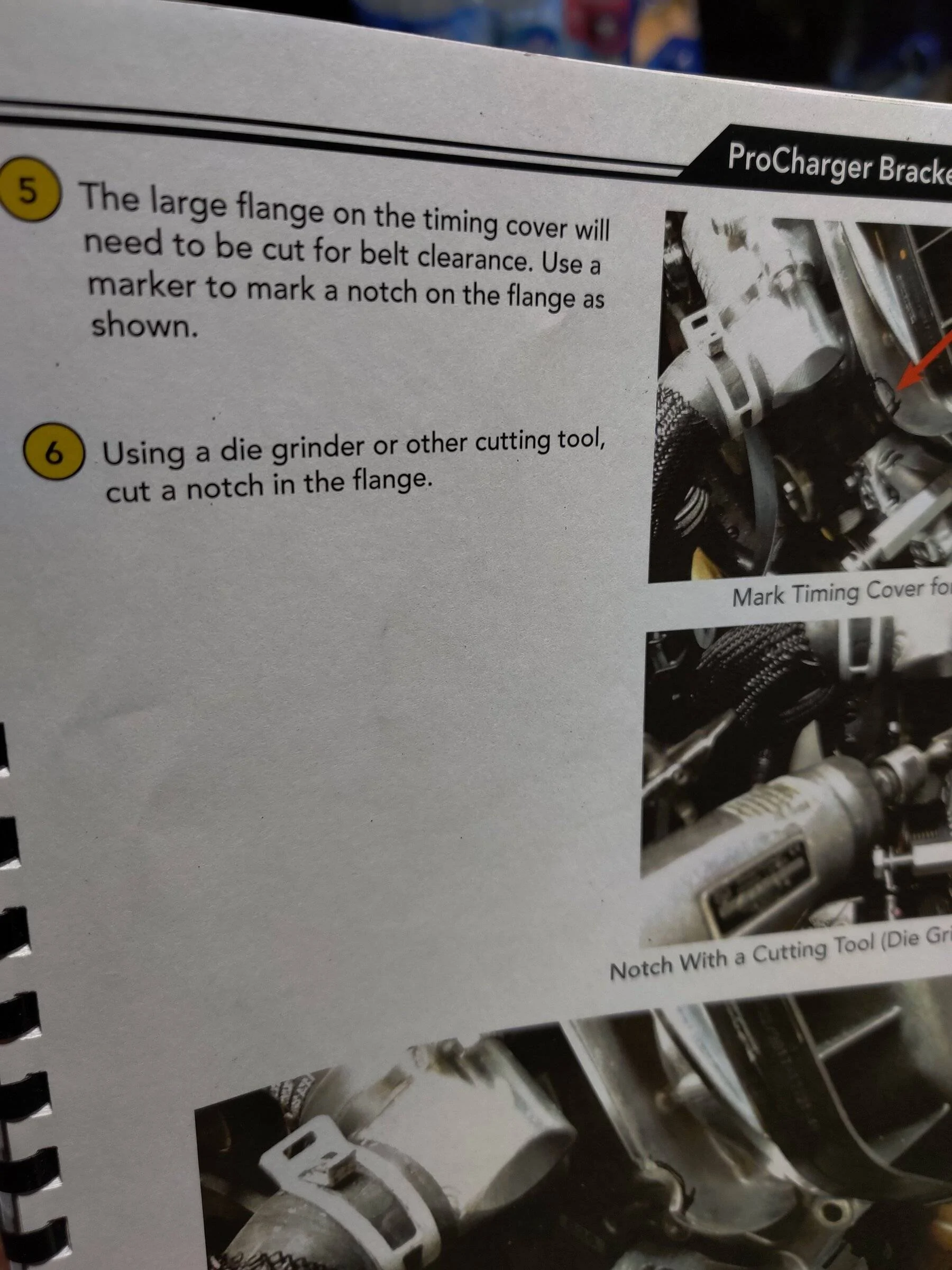

No grinding on the valve cover required...
He said timing cover. Procharger requires you to grind the timing cover for the HO kit, which is funny because one of their big selling points is how it is reversible and no permanent modifications are required. It literally takes 5 minutes with an angle grinder though, not a big deal at all.
my bad... Thought I saw valve cover, but I don't see how Procharger requires that and PD superchargers don't. lol
No it doesn't

If you run a procharger carb legal kit there’s no grinding. If you are looking for 750whp or less it’s a good option. Over that and you start having to modify the kit a little
