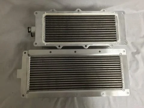

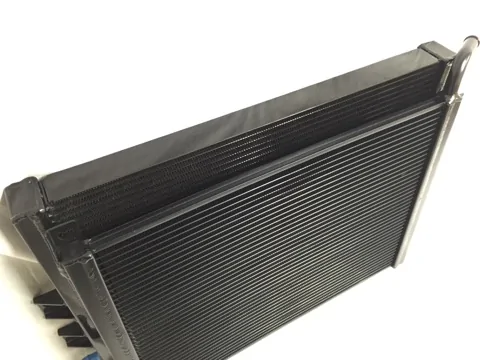

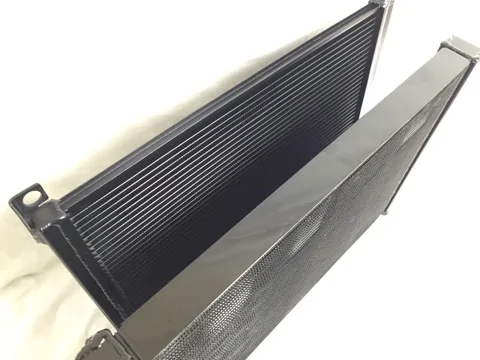

Since it was questioned, here's some direct comparison's. Note that the Whipple supplied LTR (heat exchanger) features 150% more volume as well as 16FPI vs 14FPI offering significant cooling capacity.

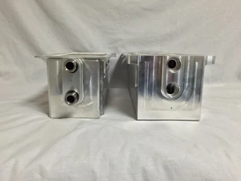

The IC core features over 33% more volume with 14 water passages vs 11 for increased cooling capacity. As shown in the image, you can see the shear size comparison.
What does all this mean? Not all boost is created equal. By increasing the capacity on the cooling system, the Whipple system will yield cooler IAT2 temps, net increased power on pump gas and race gas while doing it easier (easier on parts, further from detonation, further from catastrophic EGT's). While one maybe be able to push the boundaries on a quick chassis dyno run, in the real world, temps have to be maintained whether your doing a 195mph run (Hennessey), daily driving or running up and down the track.
