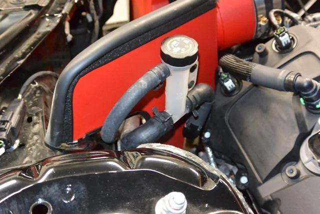

This is actually not true. The front timing cover seems like a daunting task but it takes about 15 minutes and removes nothing of importance. Also when you go back to stock your accessory belt drive and pulley covers that. Getting the VMP plug and play harness saves about an hour on install since there is no splicing however, the splicing is very easy as long as you have the proper hand tools.
Cutting the K brace isn't that big of a deal, I'm sure a STB will eventually be available as well.
I'm not saying its the easier of the install but personally, you shouldn't base your purchase over the difficulties of install, if that was the case no one would buy a turbo.
We are adding 200 HP to a car, minor cutting here and there really isn't bad. The Whipple kit is a stout machine, its also a 2.9 but also more expensive. You have to take the good with the bad. At the end of the day, if it was a bad kit FRPP would not have used it.
I can't even tell you how many Roush kits we've installed, we always take our time.
Lastly, you can, take the mustang back to stock.
No question its more expensive, but you get a massive bargain. The front grinding, I've personally done multiple times. It's a mess and took us well over an hour to cover everything, grind, test fit, grind and clean up. Not to mention the mess it made.

As far as PD superchargers go, the top two front runners or most common purchase and install on the form have been the FRPP/Roush and the Whipple.
I've read and gone over both installation instruction for both. The install for the FRPP/Roush is a bit more complicated and having to cut and grind on the block is beyond rediculous.
The install of the Whipple is alot less complicated and NO CUT and GRIND on the block. :thumbsup:
Does anyone have any insight as to why with the Whipple install they also don't have all of the cutting and splicing of wires and tubing that is required with the FRPP/Roush?
Such as the = BRAKE BOOSTER VACUUM AND ASPIRATOR HOSE ASSEMBLY
MODIFICATION and the EVAPORATIVE EMISSIONS CANISTER PURGE VALVE WIRING?
So why all the mods on the one and not the other?
We relocate the EVAP from the front of the stock intake to the driver side of the SC assembly. With that, we supply a pigtail with the male and female ends to extend this wiring. For the hose assembly, we supply pre-made hoses with quick connect fittings.
The brake booster line is replaced and rerouted with a supplied hose.

I've got a list of stuff I'll be posting in the main/large supercharger thread tomorrow after a final meeting with engineering. But I want to hit a couple things tonight regarding post 32, I had seen a number of things I had an issue with but I wanted to wait until I had solid numbers straight from engineering before posting.
Billet fuel rails vs factory style rolled steel, the manufacturing process of billet items result in a porous metal. In short this leads to fuel leaks from those rails made of porous metal.
I'm concerned with the need of a 10 rib system to drive this new supercharger, we have seen approx 1000 hp with our blower on the 6 rib setup and haven't even considered needing a 10 rib setup.
The "Massive HD" tensioner will certainly cause an unnecessary stress on the pulleys, crankshaft specifically and certainly play a role in early bearing failures.
Mounting your intercooler reservoir behind the bumper cover in a hidden location. Does this mean you must use a mirror to add and check the fluid level or must your entire front end be removed every time ?

And the massive tank behind the bumper you ask? LOL We use a nice clear plastic filler neck, with the vent line and pressure cap right behind the airbox. Nice and easy to get too and inspect, no mirror required. Also note all hoses are preformed, cut to length with clamps pre-installed. We also sheeve almost all hoses. Might want to research that one just a bit more....
